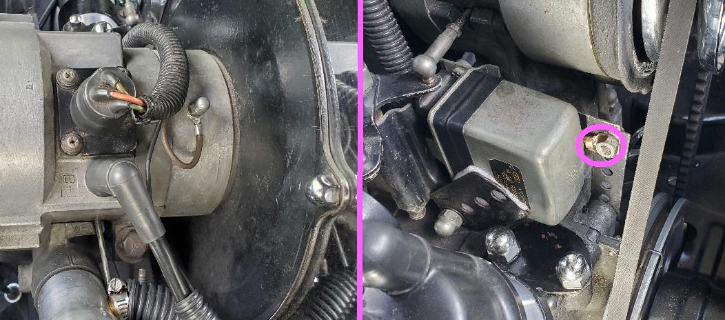

Thanks again…Question….Is the brown ground wire going to the bolt in the purple circle?

Mike_USC_65 wrote:
... Is the brown ground wire going to the bolt in the purple circle?
Yes. One end in purple circle, other end is under acorn nut on top of alternator. It's sort of redundant, but I put it in anyway because... Over the years, whenever I've separated alternator from it's stand (both of which are OG parts from a 1973 bug), their meeting surfaces have been cover'd with what's been call'd "white chit" (an oxide, a result of corrosion). I suspect the white stuff could adversely affect ground connection. On the other hand, there's already a stock brown wire running between the 3-prong alternator connector and voltage regulator to make sure they both see the same ground level.
Here's the post from back when ashman40 convinced me to put in additional ground:
https://www.thesamba.com/vw/forum/viewtopic.php?p=9687133&highlight=#9687133
