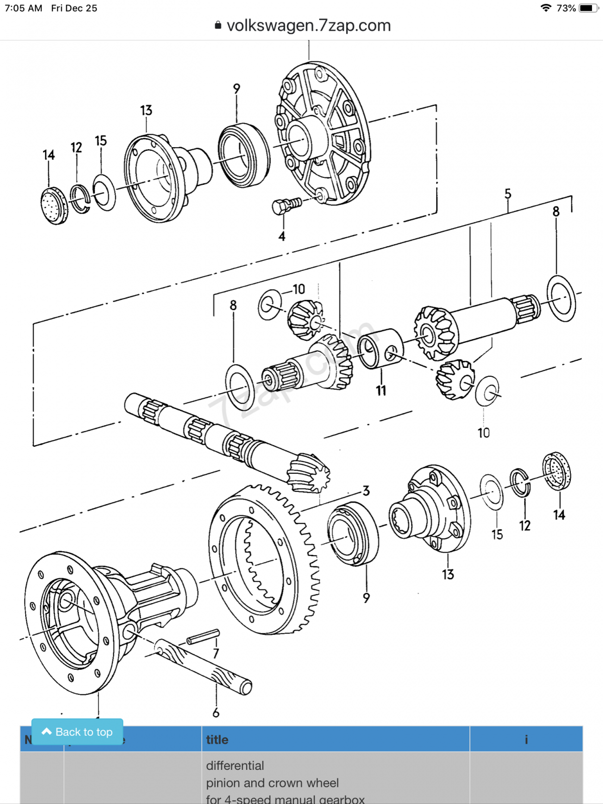

The leak is at the flexible plate at the bottom of the cv shaft joint to the transmission (the black plate under the CV shaft end in this photo)
https://www.thesamba.com/vw/gallery/pix/1664100.jpg
I had no idea of the leak, and it obviously has been going on for a while. Not sure how bad that seal is to replace in a couple days with limited parts available..

That plate just clocks/locks the Bearing ring, it is leaking from either the wiper seal or the o-ring that seals the previously mentioned bearing ring. See this thread with a bunch of photos and diagrams.
https://www.thesamba.com/vw/forum/viewtopic.php?t=747620&highlight=axle+seal
You SHOULD replace the seal, the o-ring, the clip cover, and the clip. This is not that bad of a job, 1 hour if you have done it before, three if you are a neophyte. I personally would not drive it 12 hours with it leaking that much, you are asking for the oil to get low enough to damage the transmission, especially on a longer drive, x2 without services available.

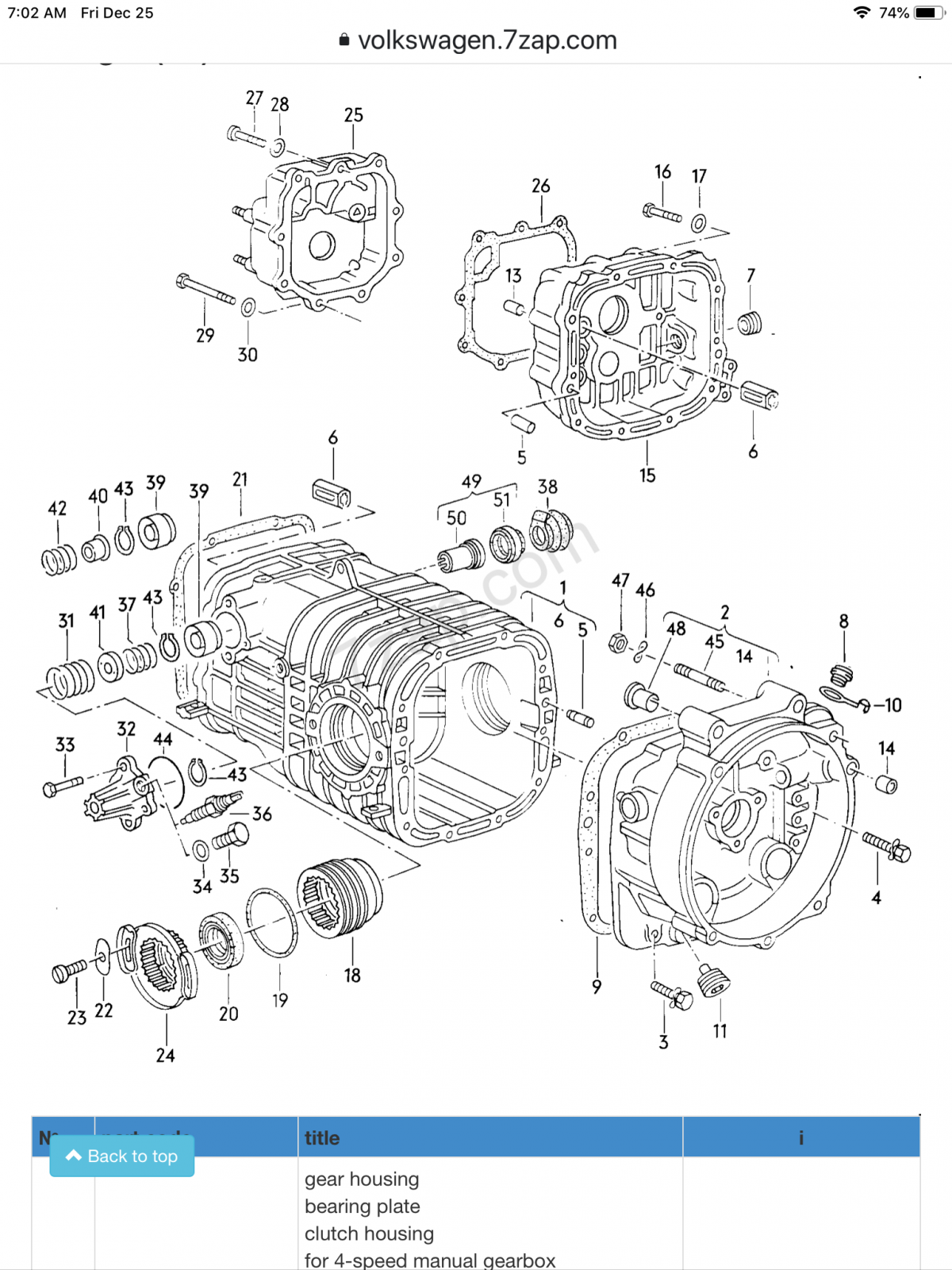

Check the atmospheric bleed and make sure it isn't plugged with crud.
I assume what you are calling the flexible black plate is the diff adjusting ring lock. Assuming that is correct, leak is either the drive flange seal (most likely) or the O-ring around the diff adjuster. There's a thread on hear detailing how to swap the drive flange seals.

Got the manual out, it is leaking from under the differential adjusting ring lock ring. Not sure where the shaft seal is in that assembly.

The CV-joint flange has a cap (seal) in the center of it. It can sometimes be blown out of place by internal pressure build-up, as the transaxle warms up, if your case vent is plugged.
See Bentley page 35.2 for an image of the cap.
Agreed with Waldo that I would suspect this cap as the culprit, given the quantity of oil you describe.
The cap can also be pierced by the axle knocking on it, if you get into the relatively rare situation of wild harmonic swinging of the axle in the axial direction (in and out).
This center flange cap is accessible when you remove the CV. Remove the cap; clean the sealing surface - "dry" it of oil with a solvent; replace the cap with or without a silicone sealer. If surfaces are in good shape, you shouldn't need the sealant and without it, it makes life easier next time round.
Other than the o-ring mentioned by Waldo (unlikely culprit IMHO), the outside of the flange rides on an oil seal that may be worn beyond it's usefulness, but this usually would be a rather slow leak. Or, if the flange seal surface is worn (a groove worn where it rides on the sealing lip), that too can cause a leak, even with a good seal.
See Bentley 35.14 for image of this oil seal and the o-ring mentionned.
Changing that seal is a bit more challenging: remove CV; remove the cap; remove the circlip; pull flange; pull oil seal; clean up sealing surfaces; replace oil seal and reinstall in reverse order. you should lube the flange sealing surface before you push it into the seal.
One of the challenges with the job is that the circlip is on top of a spring washer and you need quite a push to get the circlip properly in place - easier with transaxle pulled, but quite doable while under the bus.
If the flange sealing surface is compromised this post can help with that: https://www.thesamba.com/vw/forum/viewtopic.php?p=10406980&highlight=#10406980
I wouldn't touch the differential ring unless I was certain it was the o-ring that was the source of the leak, and as I said - unlikely that is your described leak. If you don't put the differential ring EXACTLY back in the right place (depth), you could affect your ring and pinion.

Can we please have confirmation from the OP that the small transmission vent hole is free and open?
As if that is blocked, as most neglected ones will be, that'll produce some weeping from the weakest seal whenever the pressure inside builds up from heat.
Just a toothpick test will do...
