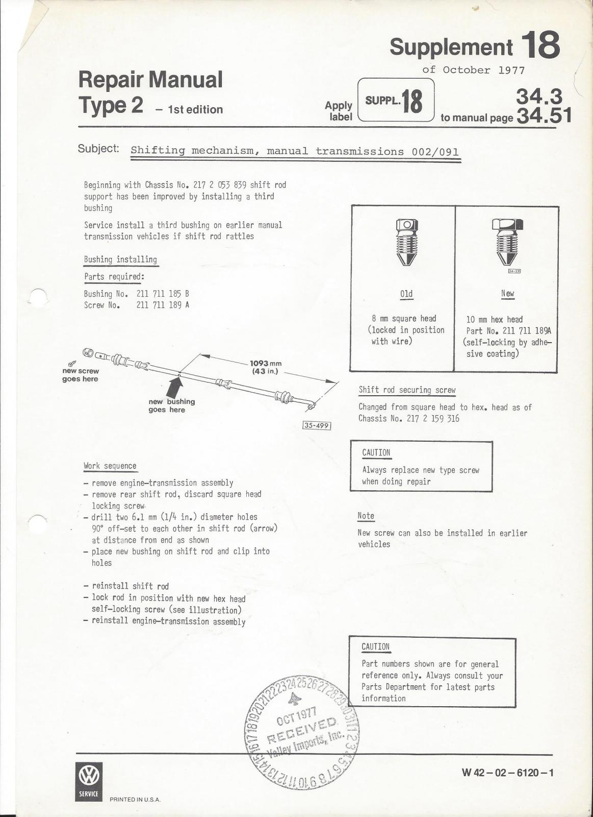

when i had mine out ,i installed a extra bushing,
i had read some where that it was a good mod.

PostPosted: Thu Aug 14, 2025 2:59 pm    Post subject: Re: How do I replace my shift rod bushings and boots? Reply with quote
you probably meant this supplement from the American Copy of the OGVW Service Manual. It is posted in my gallery images.

PostPosted: Fri Aug 15, 2025 11:01 am    Post subject: Re: How do I replace my shift rod bushings and boots? Reply with quote
SGKent that's what i did,thanks for the document,i likely got the info from one of your posts,

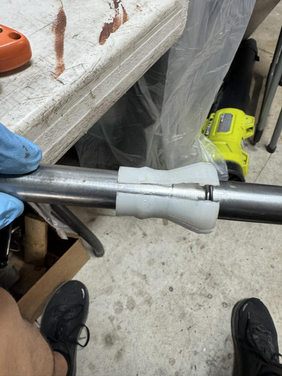

Just confirming I got it all back together but I wanted to show the difference between the new and old birdie with the ring. The new one left a big gap towards the back. Could be the size of the ring which I could have swapped I guess. I used the old, it seems to be very tight in the tunnel. The front was more lose but I think that was the design.
On to the next task.
