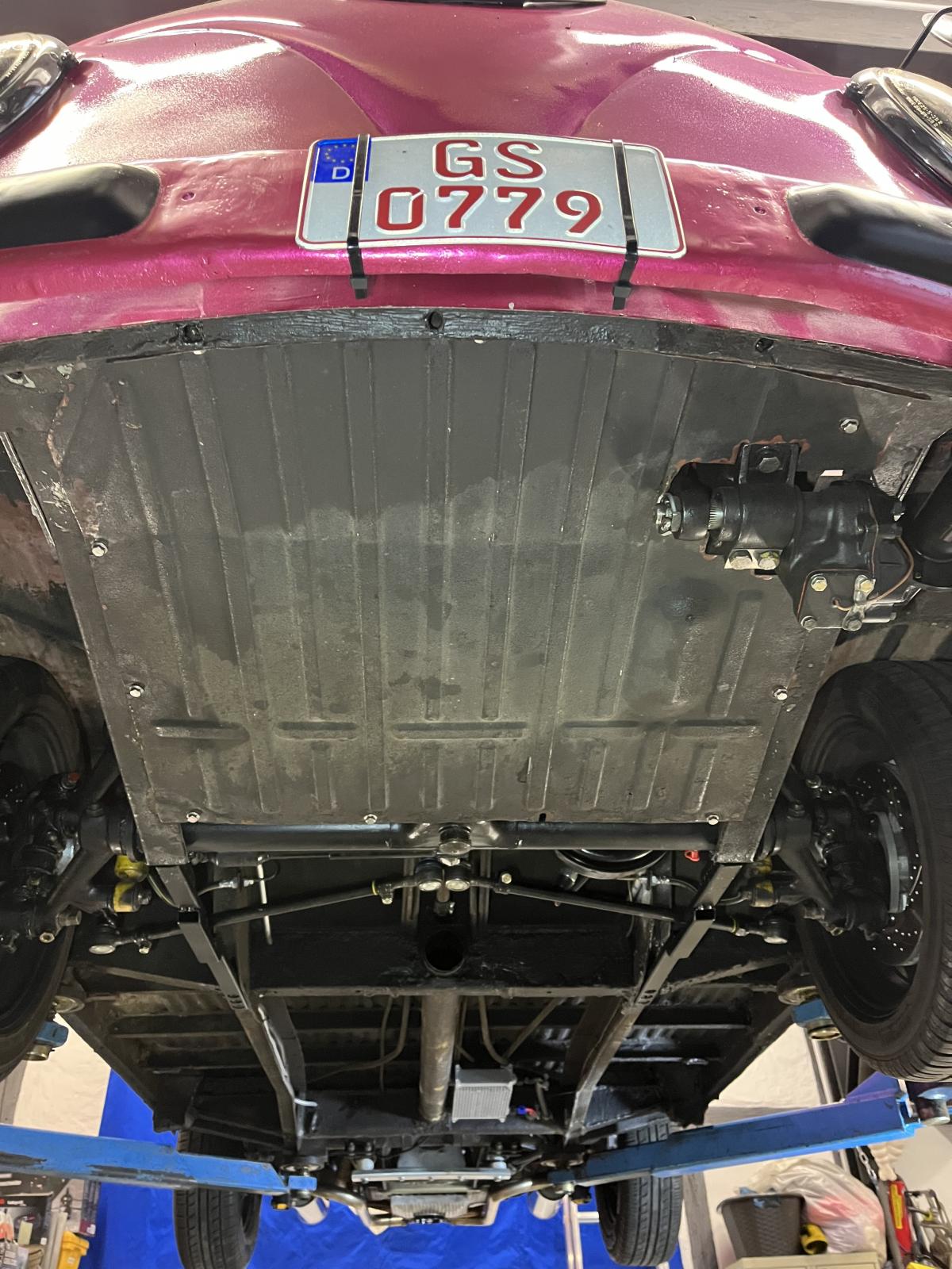

In some way I continued that sub theme with a dive closer to the floor..
The recipts for that dive at front are:

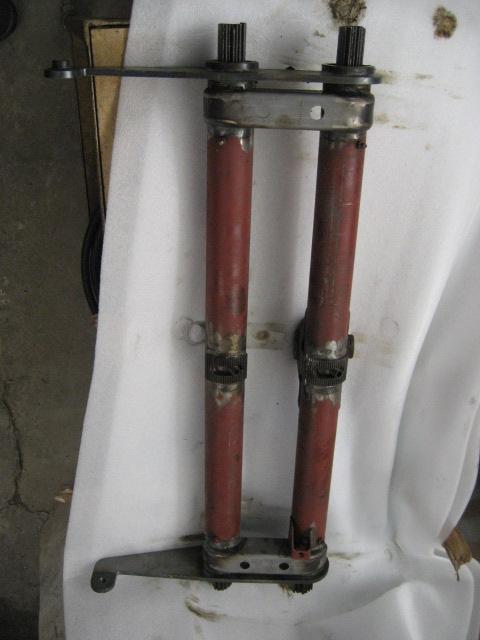

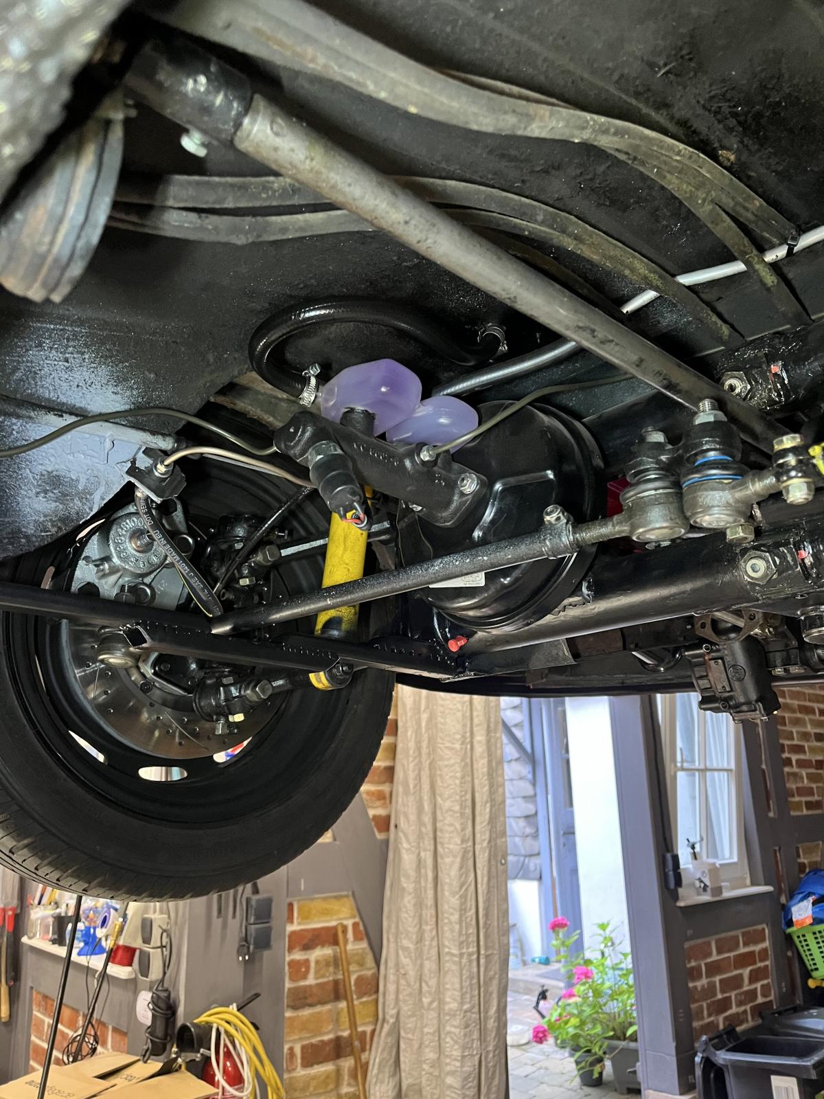

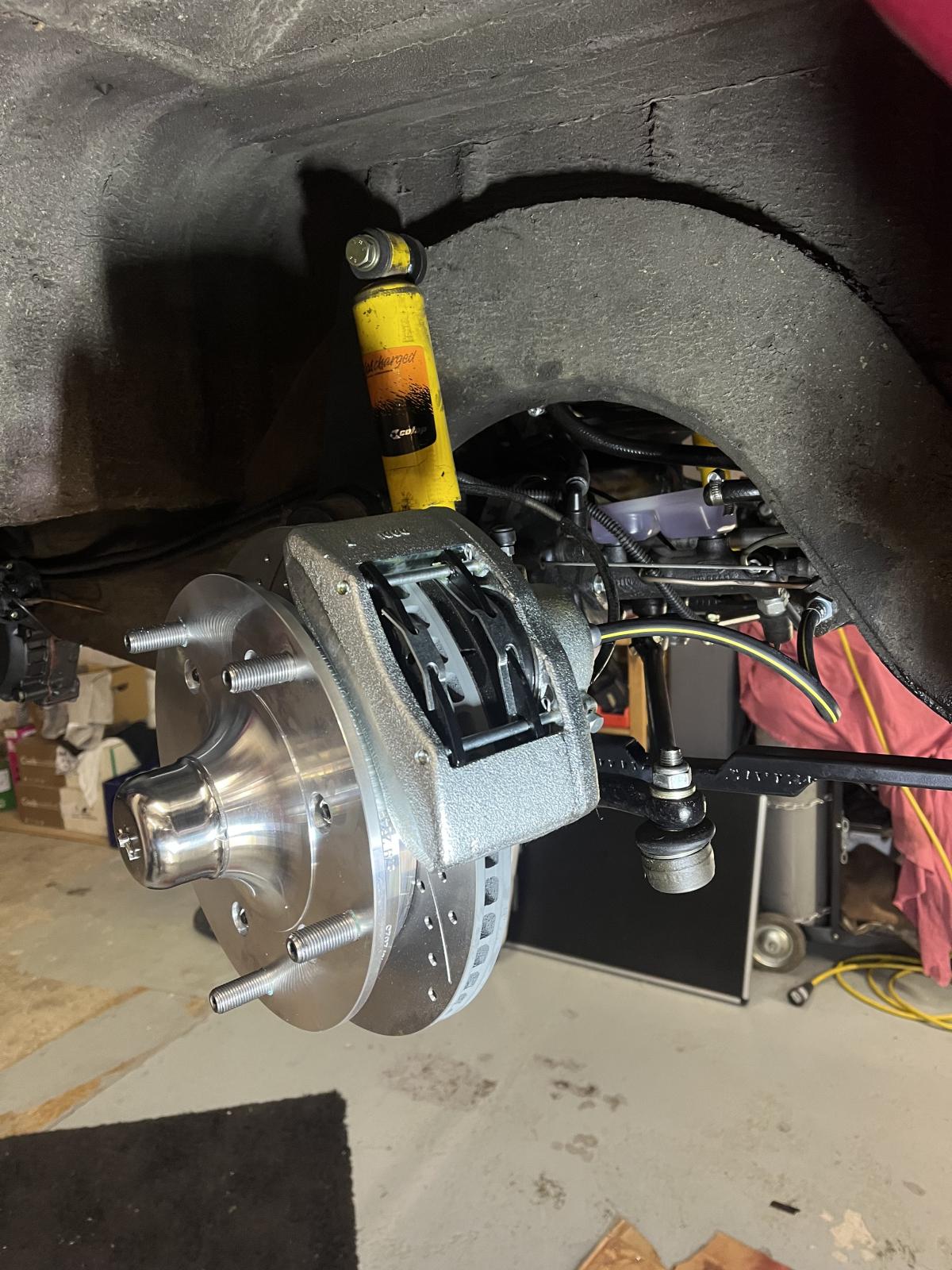

- Front axle is a late 1ton which was moded by Moosi who now runs the well known "dog back beam performance" paired with droped spindels. This was one of the first bd axles he made and it is shorted for about 3''.
At the beginning with drums and now with CSP vented discs as those work really well with the T2c brake booster which works like a dream in a bus!
Only down point was that a piece of the panel around the steering had to be cut out for center steering linkage. I did that with on cut so it could easily be welded back on...
The late steering box fits like a glove when you remove the top oilfill screw and replace it with a flush rubber plug. The late steering column is to to small in diameter but the orig tube slides nicely over it with slim ruberdonuts for good clamping aganist for a nice tight fit. The best thing is that the original belly pan fits wirhout modification so it looks stock at the first view.
From my point of view it drives really well. There are only two points I want to do at the future. 1. Install an orig. stabiliser (must look how that fits or what has to be done with the short axle... 2. Cut some spring leaves to get the ride even more softer...I am getting old Very Happy

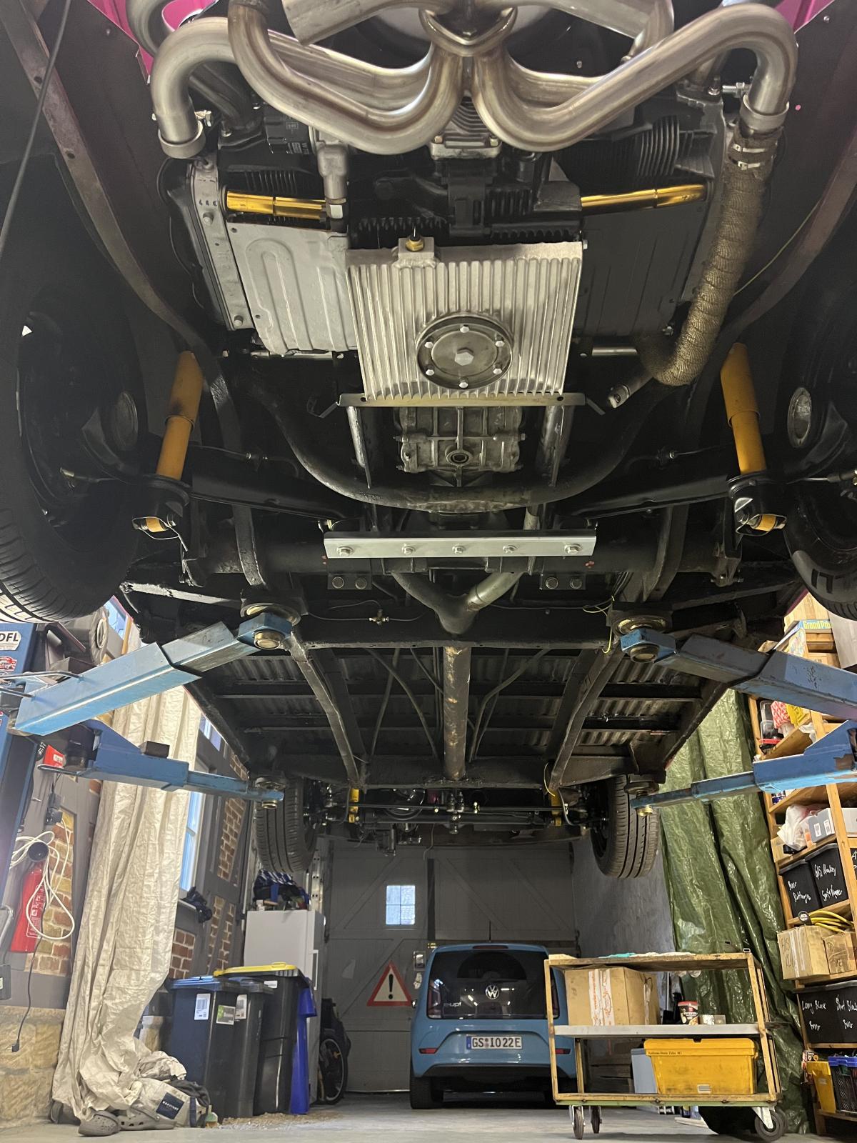

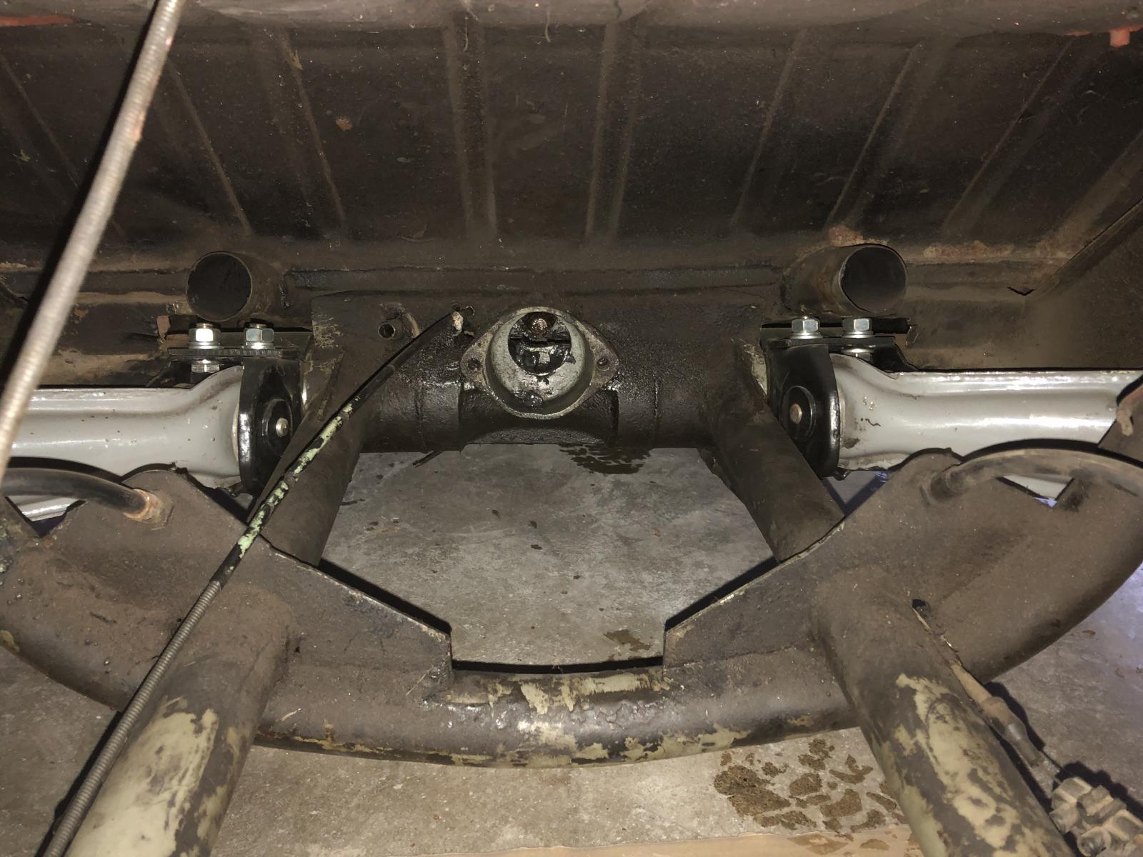

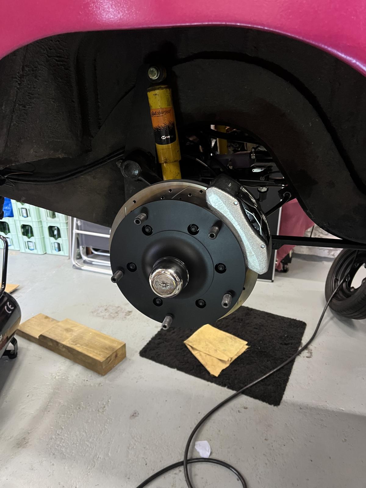

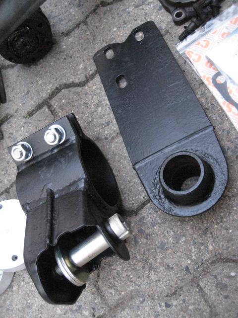

Ok, so some words & pic's about the IRS rear end and later a warning.
As I did some IRS conversion, first was my 65 ex-ambulance, this was always the plan for the 52 till the beginning. I love how a well dialed in IRS drives. As a student I salvaged some IRS typ-3's to get super cheap parts. Cutting out the clamps is reslly relaxed with a typ-3 back, and you get many good IRS parts you need for nearly pennys. Ok back then...My friend Michael Richter did the clamping work. Best part regatding the clamping method is that you could adjust the camber out back. The clamps have to sit really at the absolute inside, that you could mount the IRS arms at the inside of the springplates. I paired that with typ-3 drums so the tires sit more at the outside. Always liked that style regarding my buses. If you want to have a way more narrow back you will need to shorten the IRS arms.
That's it folks for this time, more next time.
Ah, and the warning... If you got some nice torque you really need a very good support for the front of the gearbox. Otherwise it will look shortly like this...
When that happend i used an adaptor for the donut style, which is not around anymore. This weaks the nose a lot cause of the cutting to get it on, even with the front gearbox support the 2.2l worked this out. This was a big downer just some days before the DFL MayCruiseMadness at Hannover (one night before Maikäfertreffen) Good point? That engine got torque Laughing

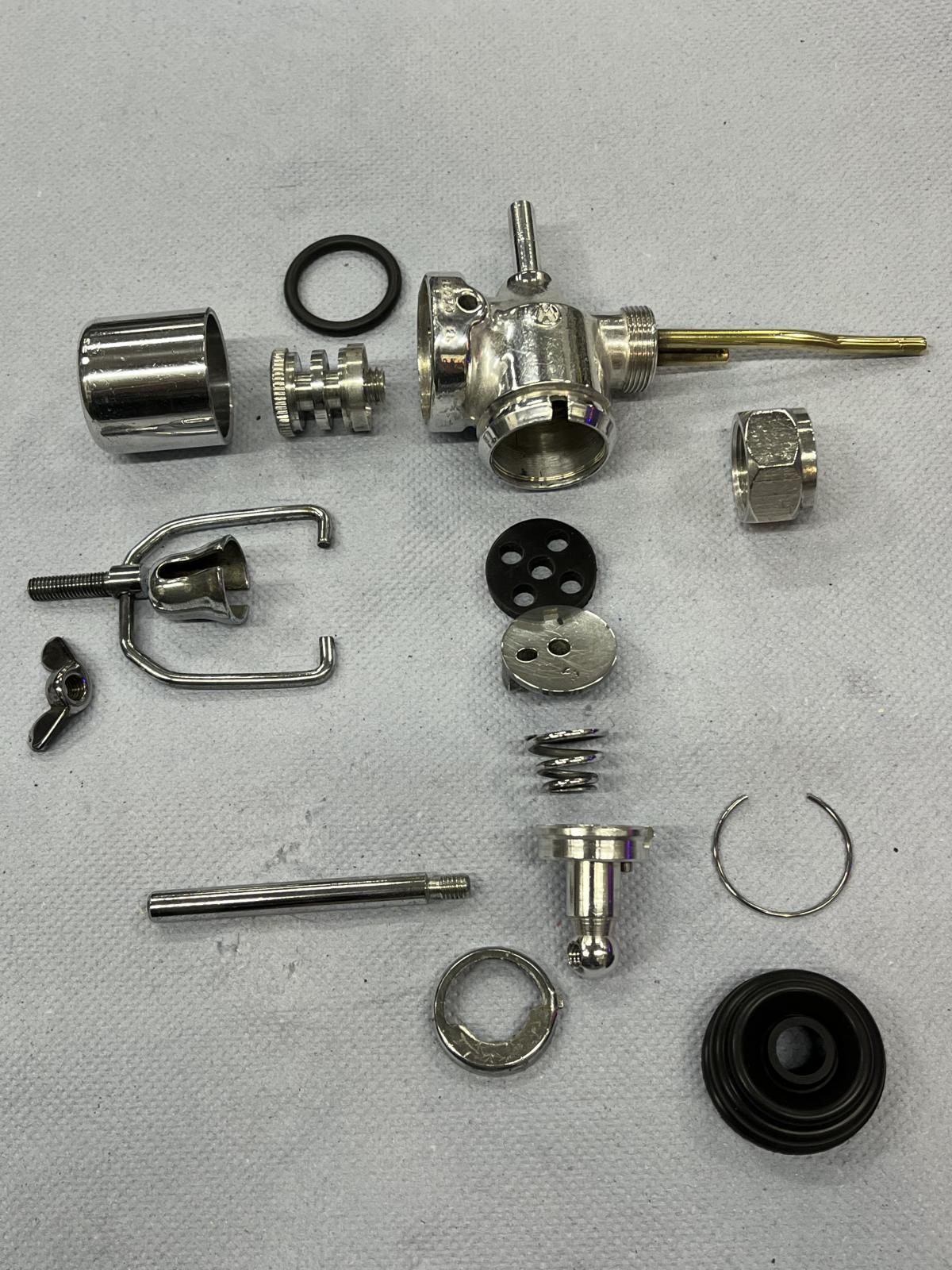

A little side project. I really like how those work, no reserve canister needed...
Used a bug overhaul kit from WW (tru CSP) for 56-61. Worked nice!
Ultra sonic cleaning and then things escalated a bit at the polishing wheel Wink
The quality of the old 50's parts is always very impressive!
