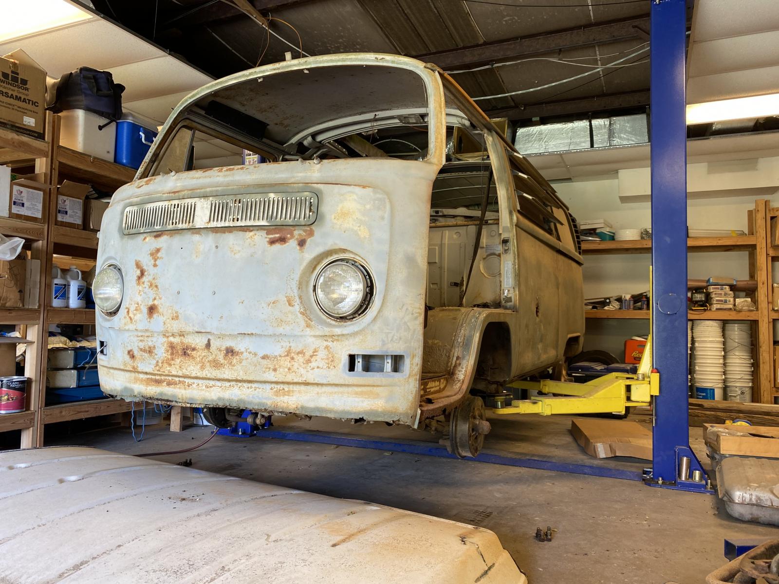

Here is the condition when we picked it up at Jon's

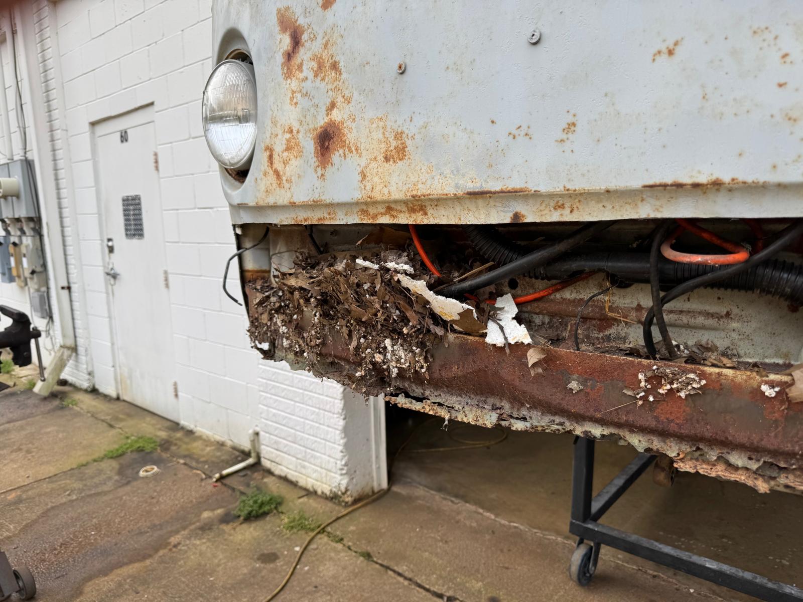

PostPosted: Wed Nov 05, 2025 5:45 pm    Post subject: Re: Long awaited project - “with a little help from my friends” Reply with quote

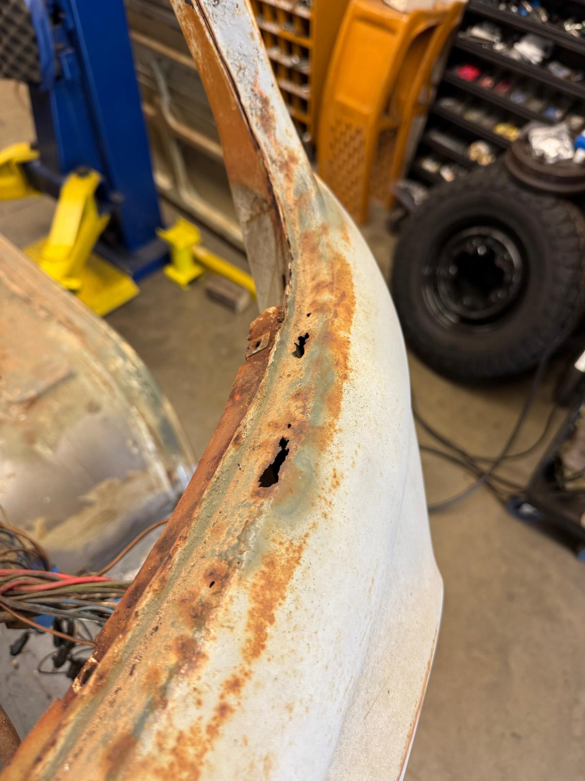

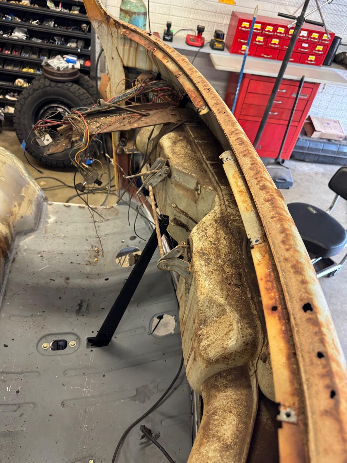

Some close ups of the rust

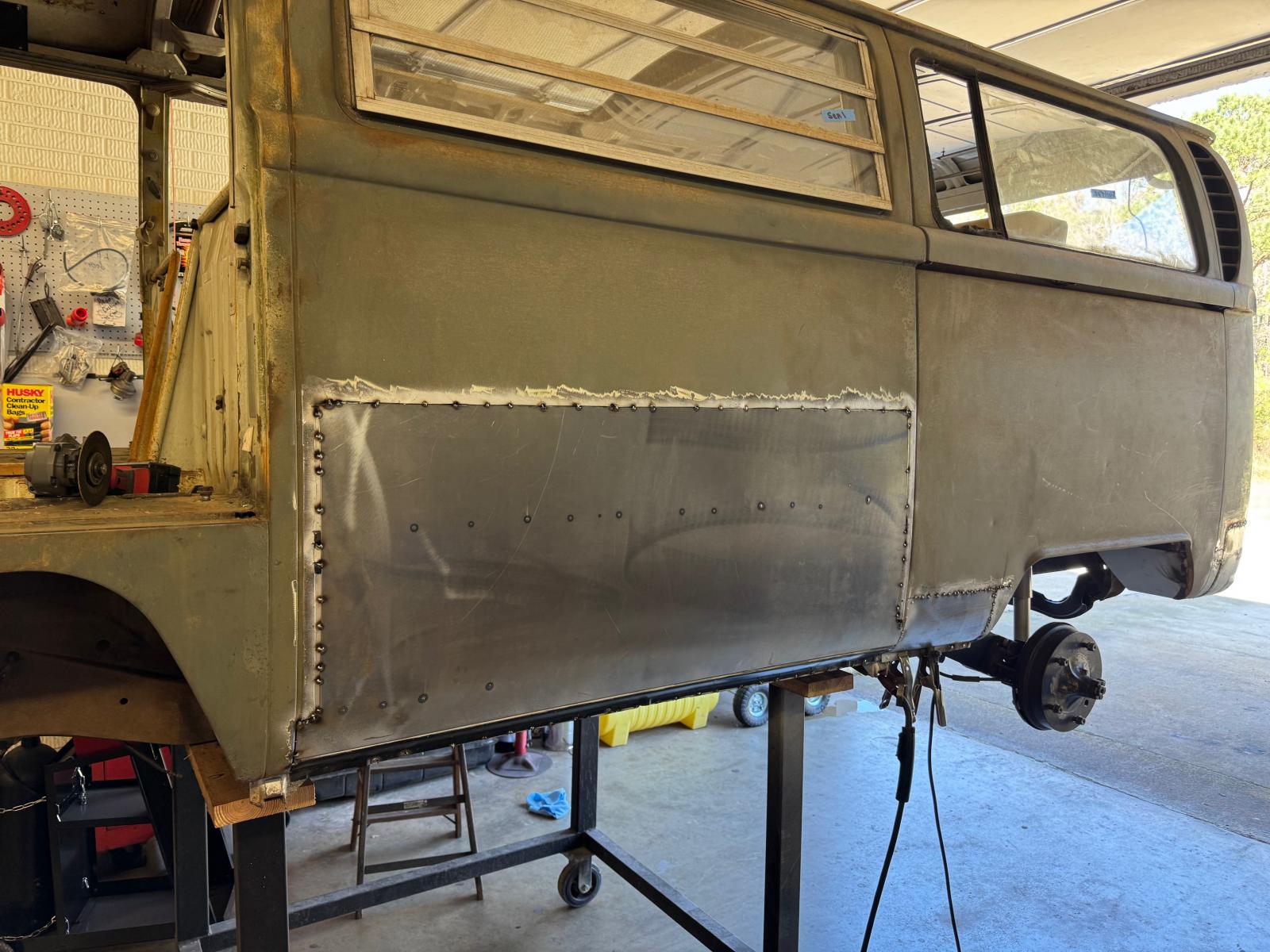

New metal going in....

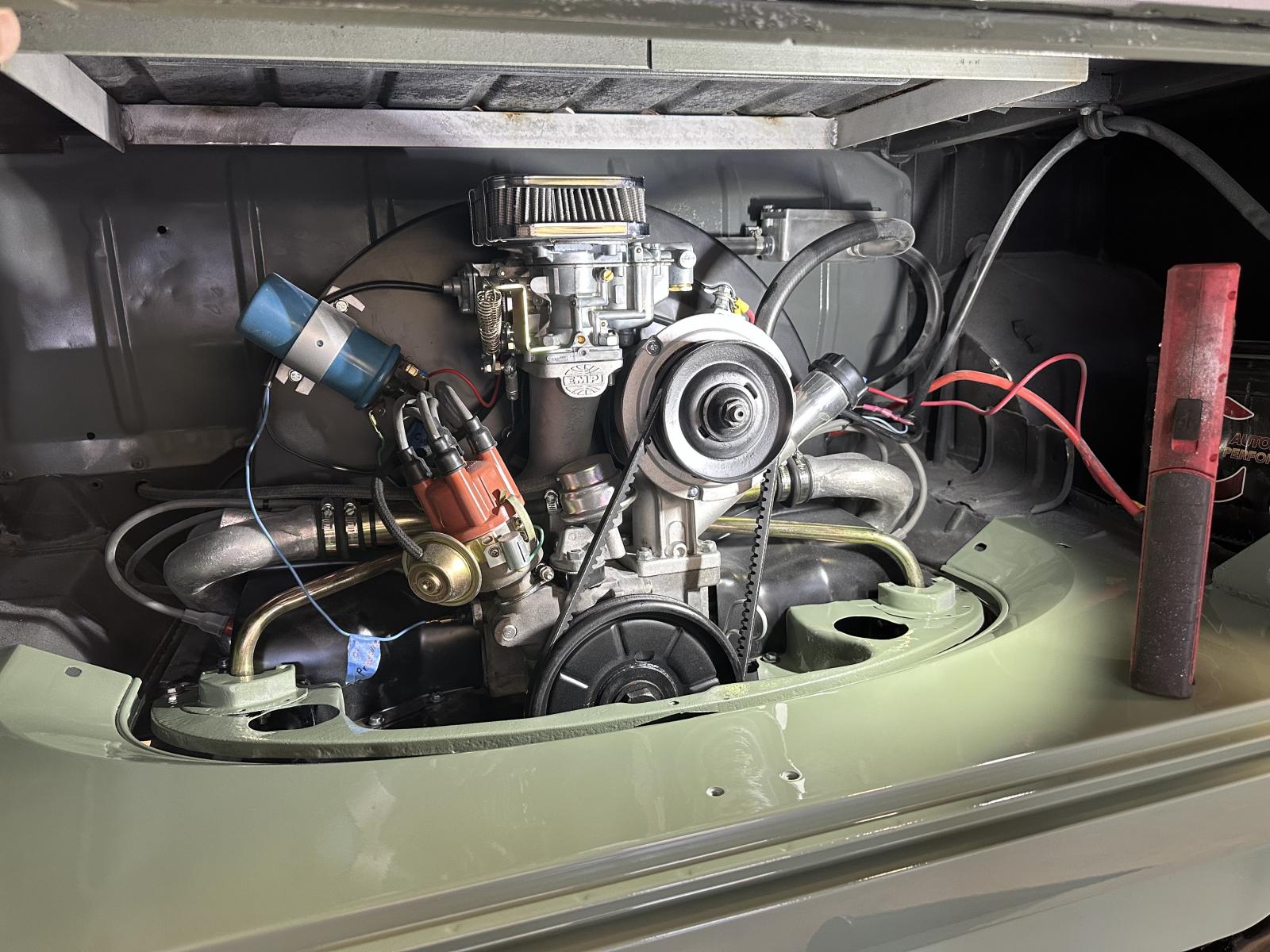

Engine was rebuilt by Lindy Herrell's shop, he sent the transmission to a gentleman in TN whom I've met at Bugapaluza but I can't remember his name. The front end received disc brakes.

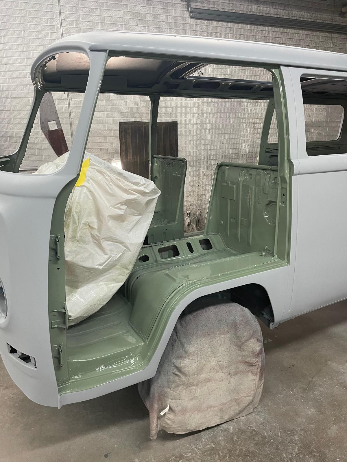

PostPosted: Wed Nov 05, 2025 6:03 pm    Post subject: Re: Long awaited project - “with a little help from my friends” Reply with quote

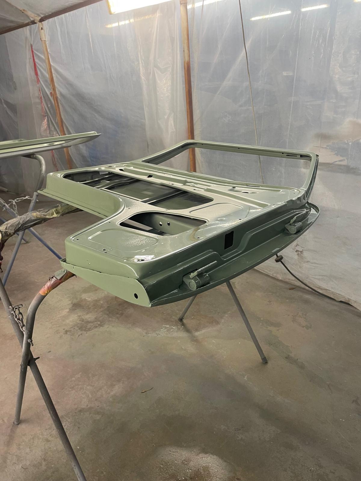

The body work turned out excellent, the photos don't do it justice. Everything is epoxy primered and super smooth (black door primered too)

PostPosted: Wed Nov 05, 2025 6:06 pm    Post subject: Re: Long awaited project - “with a little help from my friends” Reply with quote
Paint was started last week. I took inspiration from the Land Rover pastel green: the wheels will be blacked out with the Grabbers already installed and the Westfalia roof will be white like the first photo:

Nice work on this bus and I like the color also. That Weber type empi carb you have on it is not well liked on the samba due to the manifold heat being insufficient to properly atomize the fuel. Most will probably tell you to ditch it for dual carbs. There is a member named schepp on the off road forum who devised a system that works well for a single carb set up that seems to work well. It might be informative for you to read that if you encounter problems down the road. Good luck with your build it looks great.
