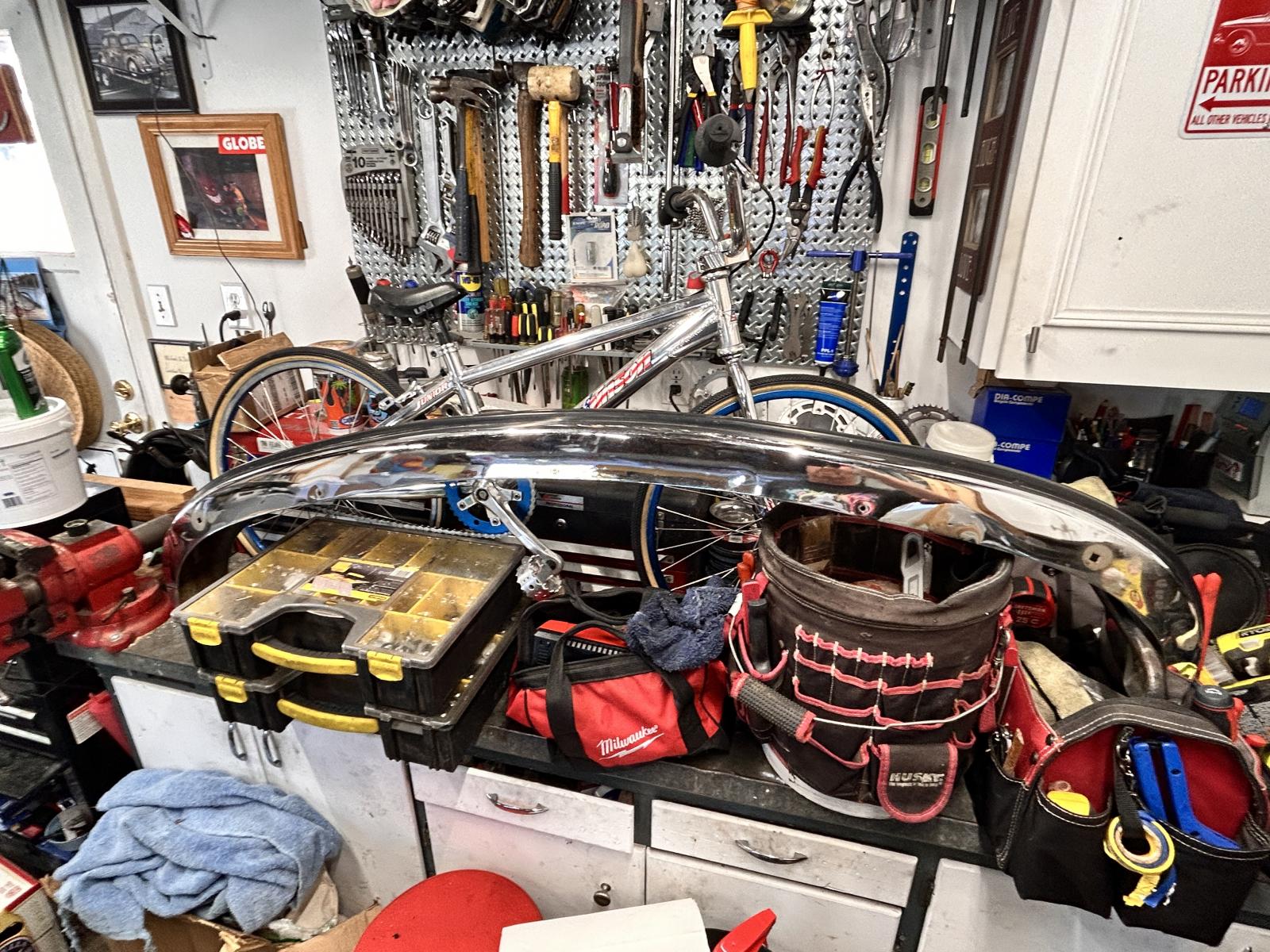

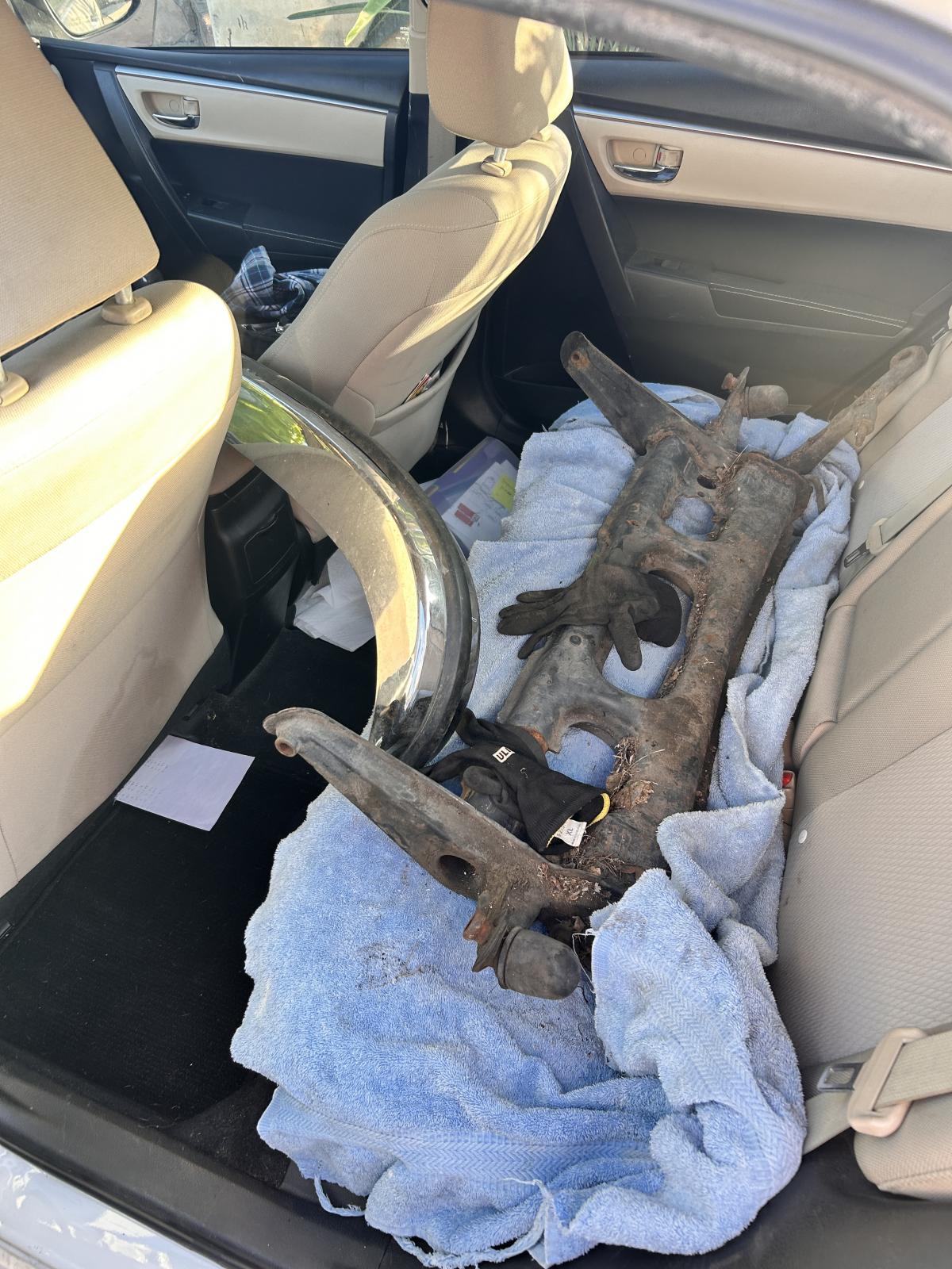

When you find Type 3 parts that you need in the area you're working in, you stop and grab them, even when your work vehicle is a Toyota Corolla. Razz
Front bumper in amazing shape complete with rubber strip and near perfect chrome plating. Plus a front beam assembly with bump-stops intact, just incase I decide to swap it out later.
Seller was happy to take payment in the form of a 30-pack of Coors Light, which I can respect. Cool

PostPosted: Fri Oct 31, 2025 3:38 am    Post subject: Re: Another Pickle Post - 1973 Squareback Reply with quote
Did the seller have a story about the Type 3 from which those parts came?

PostPosted: Fri Oct 31, 2025 12:35 pm    Post subject: Re: Another Pickle Post - 1973 Squareback Reply with quote
Yes, I was also curious. He said he’d been working on a Bus project and had done some trading for parts, those were just part of the stash, but his Wife did drive a type 3 back in the day. Cool

PostPosted: Sat Nov 01, 2025 4:39 pm    Post subject: Re: Another Pickle Post - 1973 Squareback Reply with quote
Ya gotta love chrome plating from the time before the EPA snowflakes messed it all up. It’s cleaning up nicely. Next step is to clean up the small amount of surface rust inside the bumper, then coat it with a converter/protector combination.

PostPosted: Sun Nov 02, 2025 1:24 pm    Post subject: Re: Another Pickle Post - 1973 Squareback Reply with quote
That bumper really cleaned up nice. I agree with about the chrome plating of yesteryear, it was so much better.
