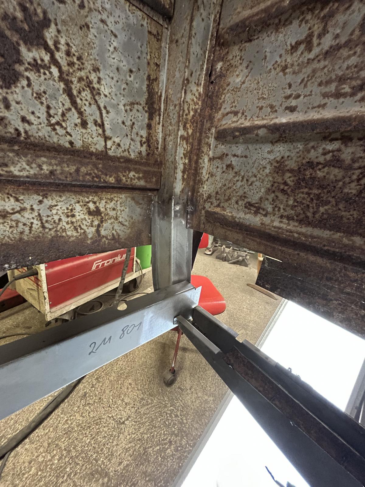

And welded the A-pillar parts in place.
Then I did some small repairs on the passenger front frame horn.
A lot of thinking about which parts I can weld in now while still being able to reach the areas that still need work, and which panels go over which… so not much progress at the moment.

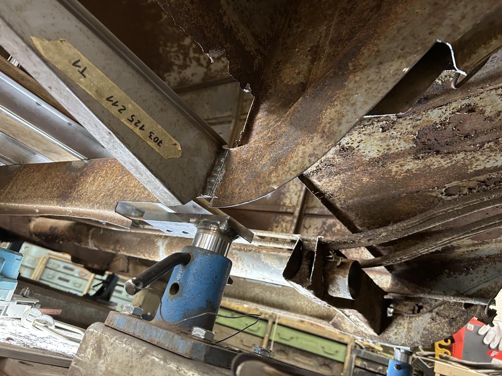

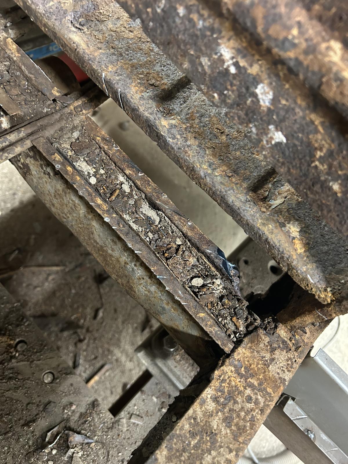

The work from the last days: I cut out the left inner and outer rocker, the outriggers, and found a lot of nuts inside!
Did some small repairs on the frame (I’ll have to work there later from the inside, which already gives me a bit of a headache…)
And I put some NOS and KF parts back where they should be.

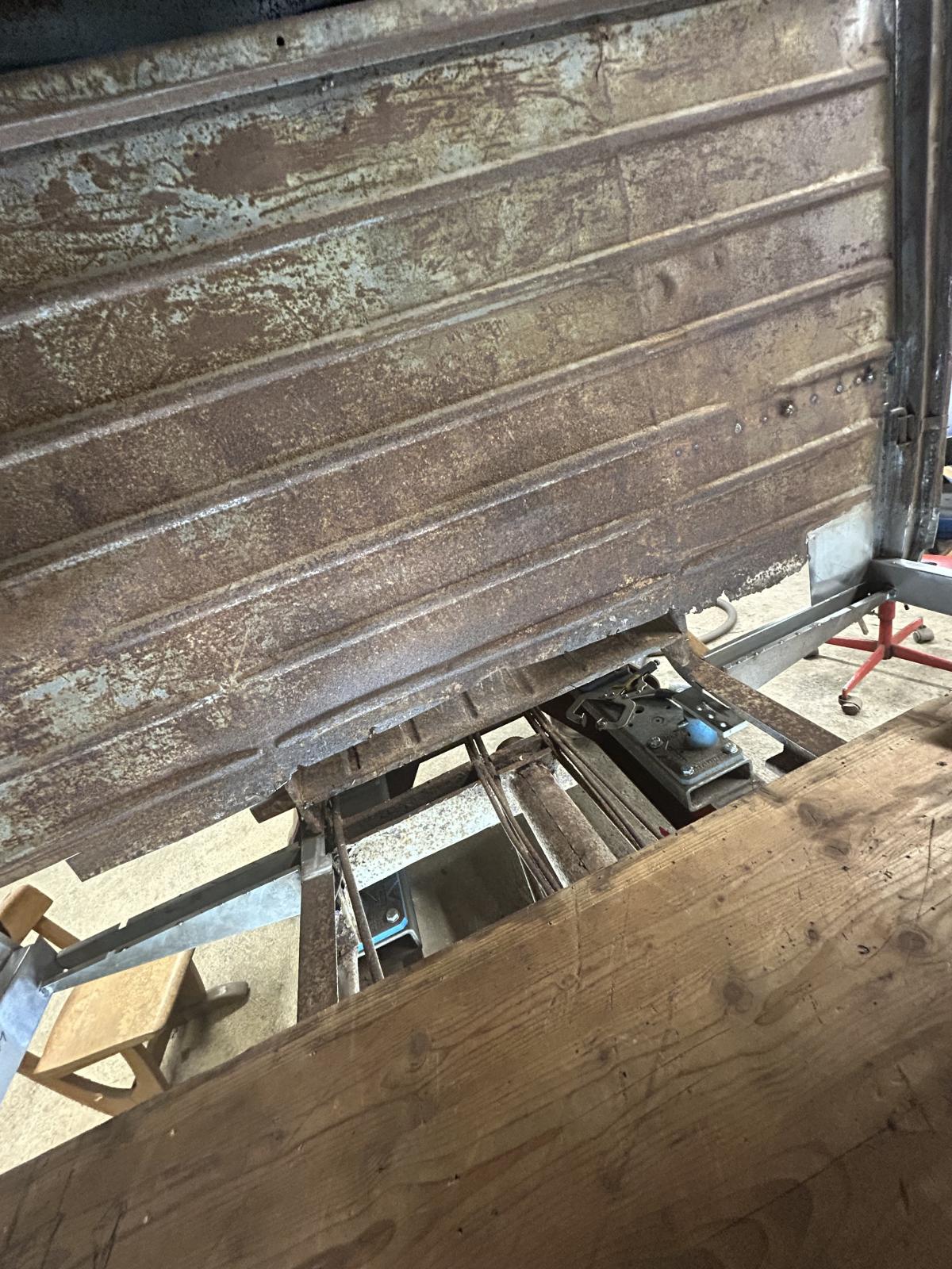

Today I fabricated the two left lower pillars using a NOS pillar as a template and welded them in place.
Then I closed the big axe hole in the left side panel.

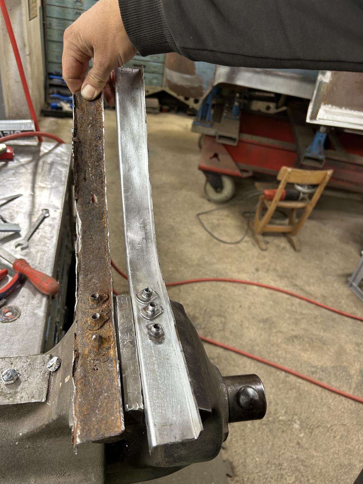

Work from yesterday and this evening:
Replaced the I-beams under the floor and fabricated a driver-side lower pillar.

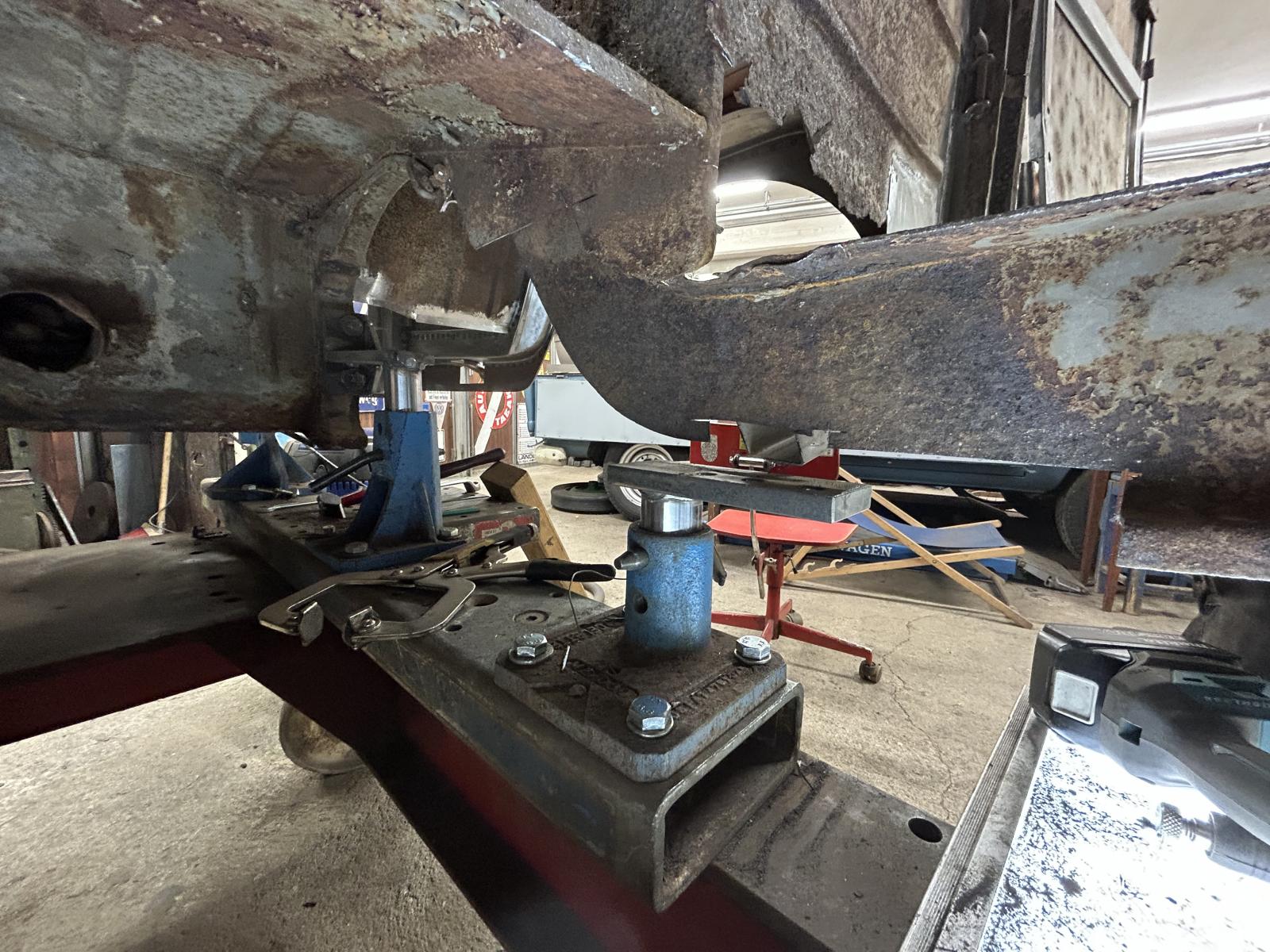

Not really fast at the moment — I spend a lot of time just sitting next to it and thinking about how to do the next steps.
Your words in God’s ears that I finish this thing before HO26!

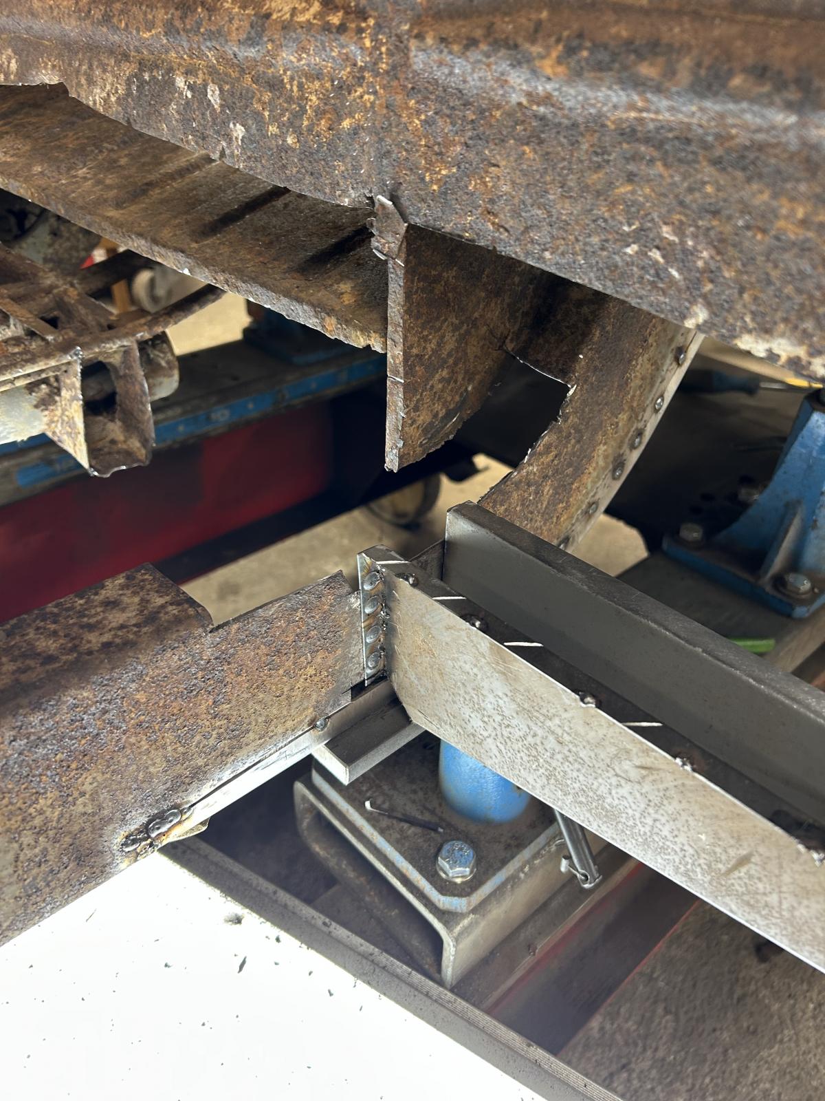

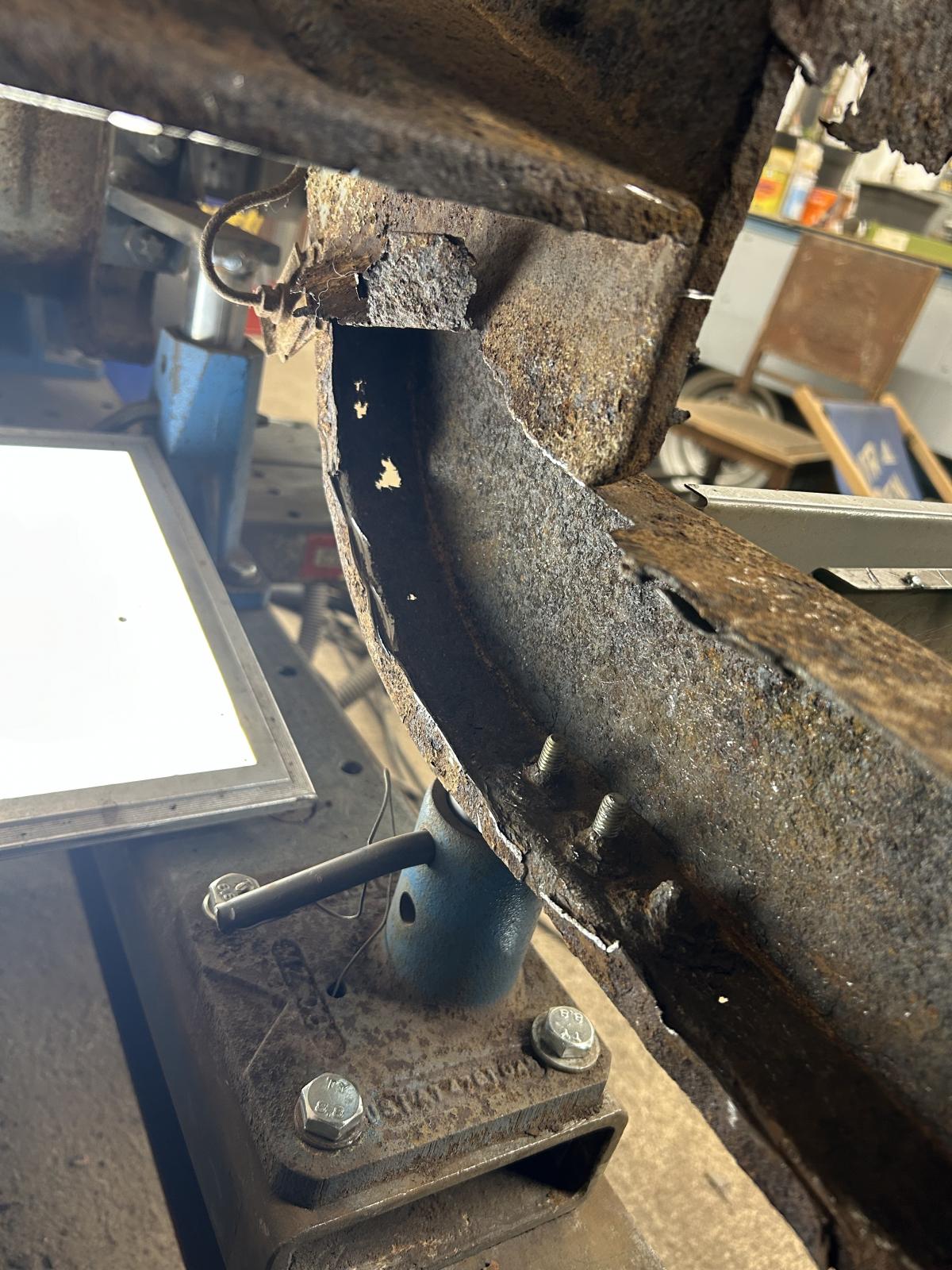

Today weld the b pillar in place and then I cut out the remains of the front U-profile and the lower wall and found some big problems in that area.
The metal there is very thin in some spots, so I have to see what I need to replace and what I can still save.
So I fabricated a new lower section of the bent frame (that 2 mm steel is really hard to stretch and shrink), where the support of the beam is screwed on.
I’m very happy to have the Celette bench to know the exact point where the frame should sit.

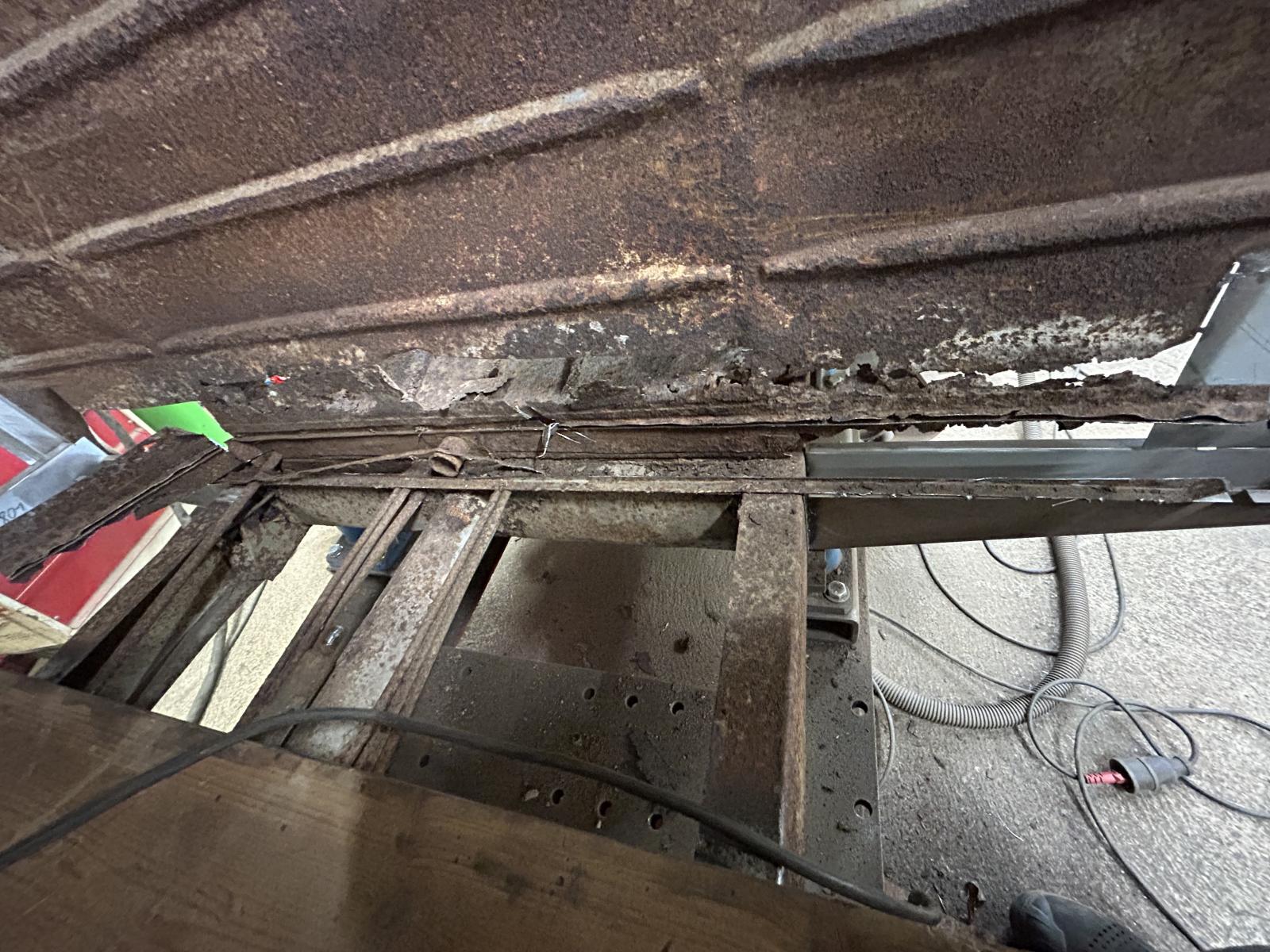

Today and the whole day I worked on that passenger frame.
