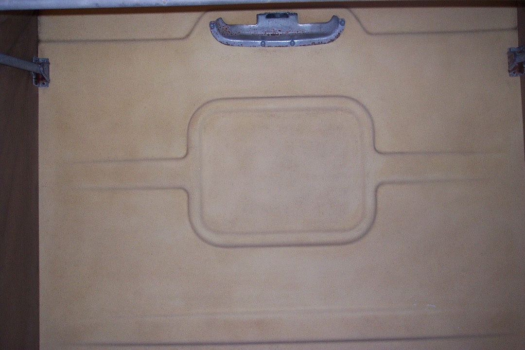

This was one nasty job I've been waiting as long as possible to do.
After alot of bleach and my head now spinning.... (I don't know if you can get high off of bleach but damn, it sure felt like it) This is what my baby's top looks like now:
Dancing Dancing Dancing Dancing Dancing

Looks really good, how long to do the job? 50/50 bleach and h20? I gotta do this job as well. It is remarkable how similar your "before" looks exactly like my "current" Wink
Seriously, did you get a bad headache from the bleach fumes?

I did the same job about two weeks ago. I was a skeptic and thought it would be a waste of time. Boy, was I wrong. In a hand pump spray bottle, generic household cleaner type. I used 1 part bleach to 3 parts water. I feel I could have diluted the bleach even more. The mold/mildew stains practically disappeared in front of my eyes. I did scrub the surface with a wash cloth that I kept rinsing in a bucket of fresh water. It took over a week for the stron bleach smell to dissapate. Dang, I should taken pics.

Yeah, The whole job took around 2 hours. MAKE SURE YOU WEAR SAFTEY GOGGLES! Nothing hurts like bleach in the eye. Evil or Very Mad Won't be a mistake I repeat anytime soon. A full face shield is best. But the bleach does do an amazing job. As buspor says, it literally dissapears in front of your eyes. But he's also right that it doesn't need to be a third of the bottle. I used a dollar store spray bottle with well over 3/4 water and around 4 cap fulls of bleach. And yes, at the end of the night, after the two beers, I had a pretty good headache. And it definately wasn't from the beers. Rolling Eyes But it was worth it. I didn't really want to be breathing in mould spores while I slept. Oh and a toothbrush is mandatory for getting all the crap out of the small metal tracks they use to hold the canvas to the body. Mine were gross. Also, While you're up there make sure you clean your shelf where the light is, and with all the bleachy rags you'll have from wiping the top down because it drips like crazy.(btw make sure you cover all the upholstery, carpets, and remove all bedding and cushions before you start.) But it is totally worth the pain and the headache. And don't be like me, CHANGE THE POP TOP SEALS BEFORE you clean the mould. I had to do this twice.

Finished sanitizing for my protection this evening. The procedure works very well. No bleach in the peeps either...... Thanks fellas...
