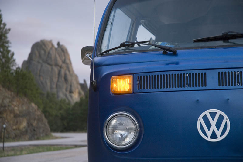

Patrick199 wrote:
If you MUST use Rustoleum, and if you have little or no experience with a spray gun of any sort, then you might as well just use spray cans. It's the exact same stuff that they sell in quarts and gallons but it is already thinned.
The best way to get a nice finish from a rattle can is to heat up the contents before you spray it. Drop a couple cans in a bucket of HOT water for ten minutes and the paint will flow much better, lay down better, and dry faster.
Here's my bus after a Rustoleum rattle can paint job. You can see a little mistake on the windshield seal, just below the windshield wiper:
It takes a LOT of cans, but it's certainly cheap. If you go the rattle can route, definately go to WalMart and get one of the gun attachments for a rattle can. Makes it a lot easier on your fingers! And PLEASE recycle the cans! Our recycle center took them in their scrap metal bin.
I'm really happy with it. When I get chips I just clean and touch up the area.
I was wondering about a clear coat as well... anyone have any ideas?
1978 Campmobile, 2000cc w/hydro lifters, dual Weber 44 IDF carbs (50 idle jets, 115 main jets), SVDA distributor w/Compufire.

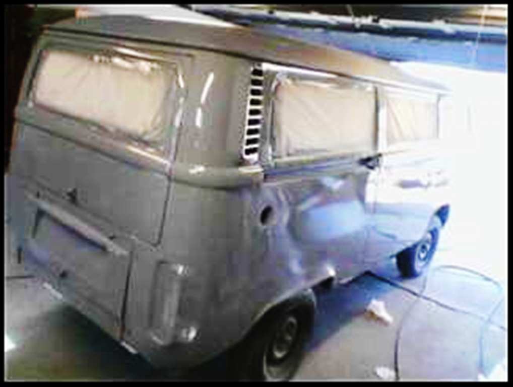

PostPosted: Mon Dec 31, 2007 6:55 pm    Post subject: Reply with quote
My Bus painted with boat paint. it's a polyurethane with no additives. use the manufactures thinner. I used Interlux Brightside paint and sprayed with an HVLP. Paint/thinner ratios are a crap shoot, temp and humidity play a part. Doesn't take much thinner. maybe 5 or 10 %.

That looks real good vdubyah73. Do you have any other photos? When was this done? I did mine with Rustoleum last spring and it came out good but I thought about using marine paint since I think it would protect the metal better and is a more durable paint. I live in a marine climate and want the best protection for my bus.

PostPosted: Tue Jan 01, 2008 6:54 am    Post subject: Reply with quote
So far I have painted the engine compartment, the rear and half of the roof with a polyurethane base paint made by Coronado called Rust Scat. I have found when you shoot outside do it on a day of very low humidity. You will get the maximum gloss out of the paint. Yep, dirt, bugs and runs are free. Laughing
