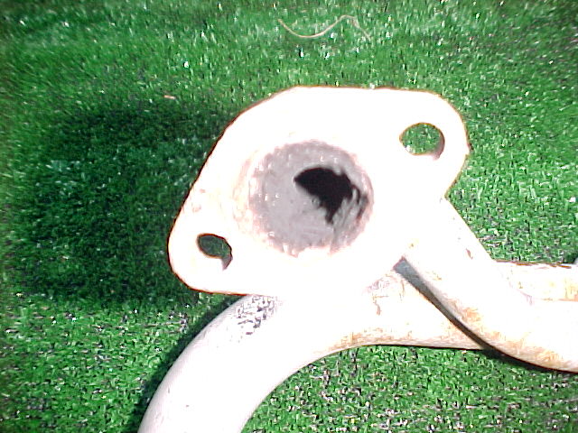

Does this crack in the back of the manifold look like a problem? It didnt appear to be affecting anything...
In the next pic is the heat riser "normal" or more clogged than it should be? I hope i get a good camera for fathers day... Very Happy

not real sure how a manifold is put together but the aluminum i thought was to hold all the steel tubing together....If so that crack could be a big problem....i have a 1500 that I have tried giving away here on the classifieds but still here Crying or Very sad if you end up needing a manifold let me you can have it next to nothing

As long as it's already apart, I guess if it was mine I'd be looking for a better manifold. I don't like the looks of the crack, and I'd want the heat riser tubes clearer....

thanks - I'll check it out a little more today...
