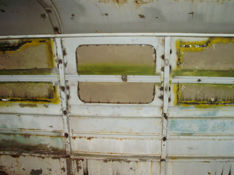

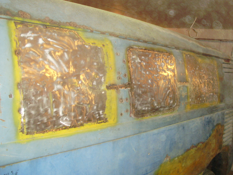

thought you might like a little update...
so im finaly done with the rear top hat and outrigers
started to straighten the long side panel, still have some refining to do but im getting there slowly
welded the last window in and inner reinforcement
and finaly, i started work on the rocker
Excellent work, nice job.

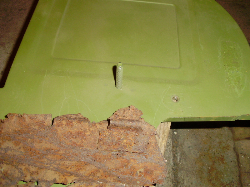

im curently working on the battery trays and i noticed the original does not have the same bracket for the battery strap than the KF one.... anyone on here have pics of a good original wolfsburg battery tray?
thanks
Posts: 71811
PostPosted: Thu Feb 10, 2011 4:29 pm    Post subject: Reply with quote
It looks like you have a Barndoor battery tray.
phil1957
Joined: July 10, 2006
Posts: 232
Location: montreal, Quebec
phil1957 is offline
PostPosted: Thu Feb 10, 2011 4:34 pm    Post subject: Reply with quote
when i bought it i told gerson i had a wolsfburg and he told me that was the only ones he made for wolfsburg/barndoor buses.
but i hadnt noticed they were not the same.... until now
thats why im looking for pictures, so i can modifie it to be correct for the year
