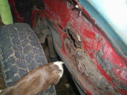

So, what I'm gonna do now is throw up some pics, and explain why I am restoring the doner and the car became the donor.
This is one of the "good boys" I refered to who sniff problems out for me, he really is gifted, his name is Bucky.
"You can't restore this fat chick! its been wrecked!
"Who are you callin' fat?"
Not you, the car! Look here! Its been welded at both strut mounts!
"See! Look here.""
"Yep. You'll never be happy with this, the least bit of shimmy will drive you nuts!"
And the heat channels are shot all the way! The donor only needs the driver side front section replaced, and you were gonna do the pans any way. We think you should restore the other car. And you can use this bell housing to make that engine test stand you keep talking about!
"Yep. Restore this one."
We know you're worried about thst section of the rear corner on both sides, but you have a donor that's not good for much else.
So, Samba Sages, what do you think? Are the boys and the chicken right? Has anyone done the rear corner restore around the vents? I can't find a thread about it.

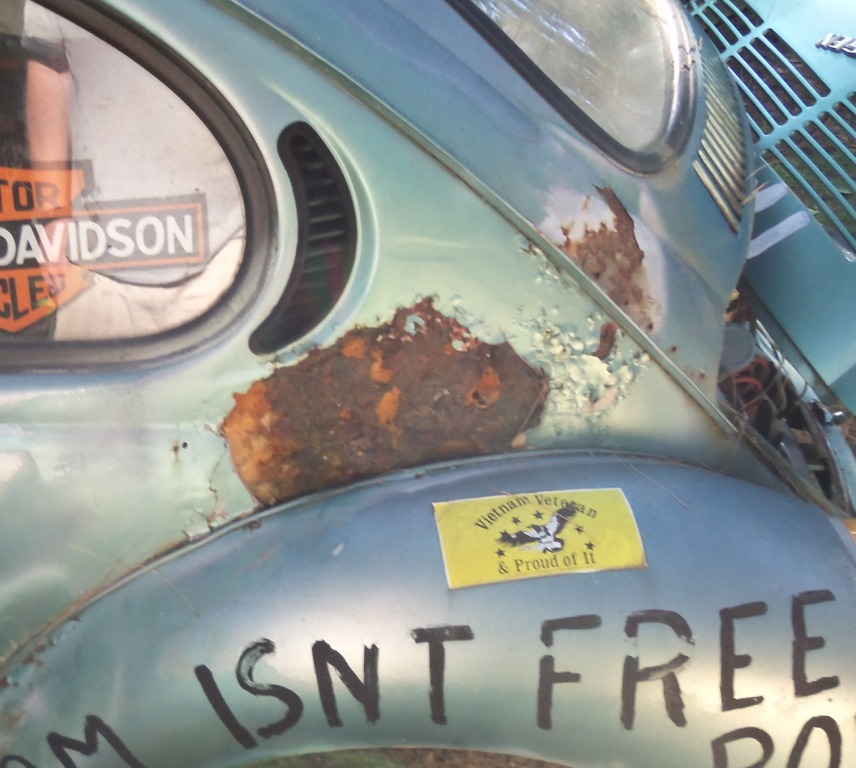

So, this is the bad section to be replaced.
this is the section of the donor that I cleaned up.
I wanna replace the corner all at once, and am gonna unless someone tells me that either I am screwing up or that there is an easier way. I intend to weld a great deal of bracing on both cars before I start cutting
aside from that, my next move is to get the body off, and replace the pan (halves from mid america, already ordered), and replace the forward section (LH Side) of the heat channel.

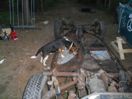

PostPosted: Sun Jun 10, 2012 11:23 pm    Post subject: Continuing tear-down, waititn for pans to arrive. Reply with quote

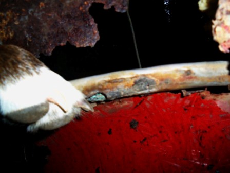

So, Bucky is checking out the rear bumper mounts. He says that I can't use the ones from the '75 super 'cause the apron is different. He says that the whole rear clip is different from the '74 standard 'cause of the muffler (Fuel Injected).
He also insists that I replace the mounts.
He won't leave me alone about it. So any recomendations on where to buy?
I setteled on 20 Ga. steel for the pans, and am tired of "setteling".
Bucky wants me to show you this pic just so he can read your responses and say either "I told you so", or "Argooowellg". Dunno what that means, and am not sure on the spelling, but he says it a lot. German? Dunno.
While we were looking at the rear wheel houses the wiring harness came poking through, and bucky sniffed out a short that the PO must've had to deal with. Bucky says that this explaines all the extra wires comming from, and going to the loom.
Bucky Peels it open and assures me that I am buying a new harness, and a pig ear.

phazor
Joined: May 02, 2010
Posts: 23
Location: Nashville, Indiana
phazor is offline
PostPosted: Thu Jun 14, 2012 1:33 pm    Post subject: Update and question. Reply with quote

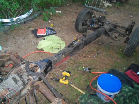

Okay so, we got the body off,
and "Red" the body man wanted to start cutting right away.
We were there in no time.

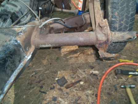

It's when the fine tuning and clean up of the chasis that the 1st problem arose. The rear support arm that runs under the back wall of the pan, from the torsion tube housing, to about halfway to the center tube, was rusted through, and came away with the old pan.
only a small piece of ot remains on the right side in this shot.
Here's a shot of the other side before I remove this last piece of the old pan.
We have looked everywhere I know to look for these parts, and have had no luck.
Bucky says to just fabricate the piece, so I guess that's what we'll have to do. Any sugestions?
Steve22
Joined: March 05, 2004
Posts: 1389
Location: the wild unknown
Steve22 is offline
PostPosted: Thu Jun 14, 2012 2:23 pm    Post subject: Reply with quote
buying new pans? if so, that piece will come with each pan. If you're fabricating new pans, then yes fab that part as well.
