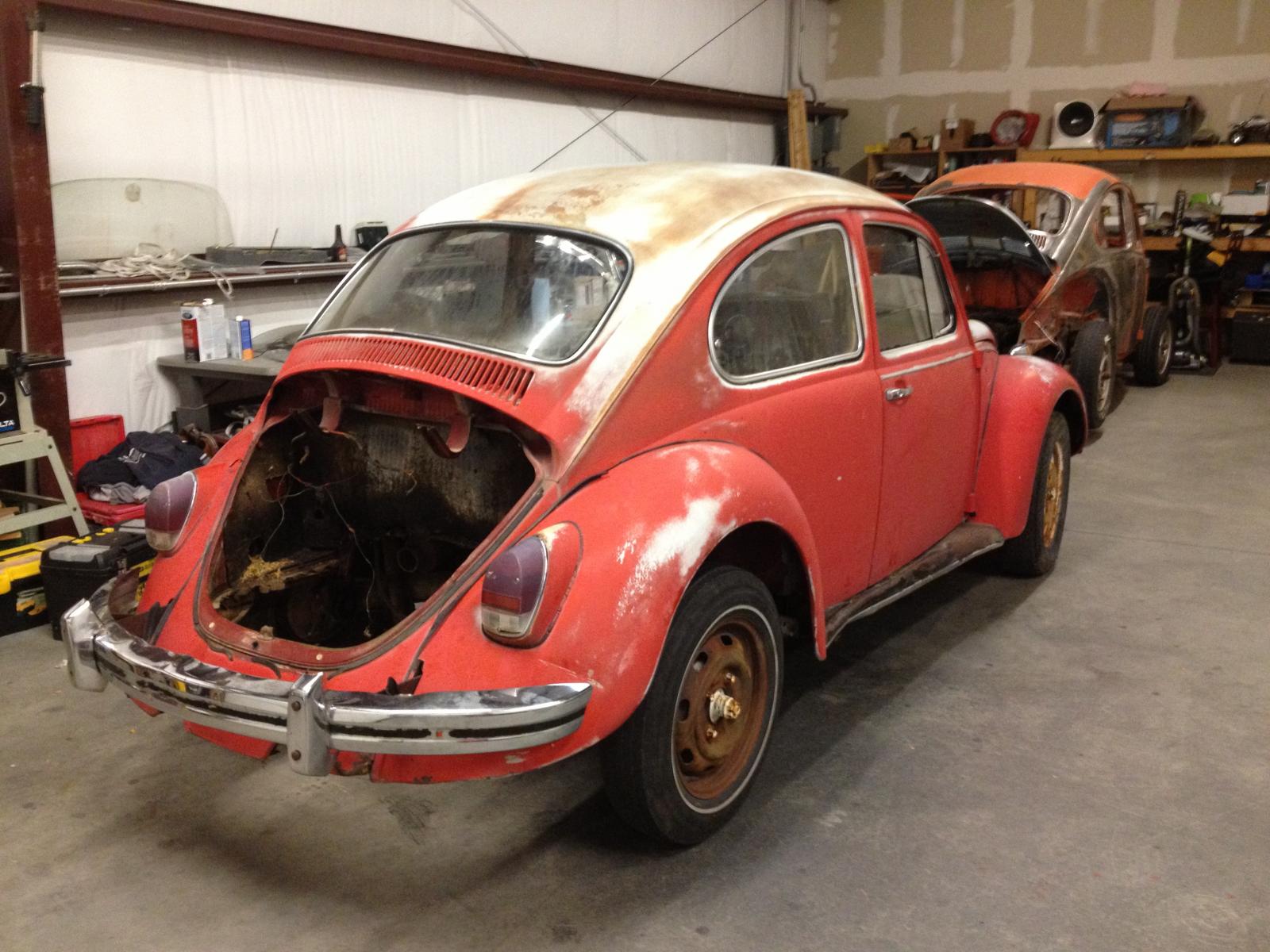

I bought my first Bug about a year ago from my neighbor, a 72 standard that was sitting in his yard for as long as I've known him(about 7 years). I "bugged" him about it for about 5 years and he finally gave in and sold it to me for $500. Sweet!...or so I thought. In the excitement of my persistence finally paying off, I threw him the cash without really even looking over the car, just dragged it over to my yard. After checking out my new ride I soon realized I might have gotten in WAY over my head. Rust everywhere! Shocked I live in New Mexico, cars don't rust like that here. After about a week of kicking myself I decided well, lets see what happens. First things first, gotta see if it runs. I set out replacing the fuel lines, got some gas and a battery, gave her an oil change, took a deep breath and turned the key. Success! After sitting for who knows how long, fired up on the third crank! It's alive! Again, the excitement was back, so much so I had to go around the block. It ran great, engine feels strong, trans shifts smooth, all was good...until the first stop sign, NO BRAKES! Got home safe though, thanks for asking. And so it begins...

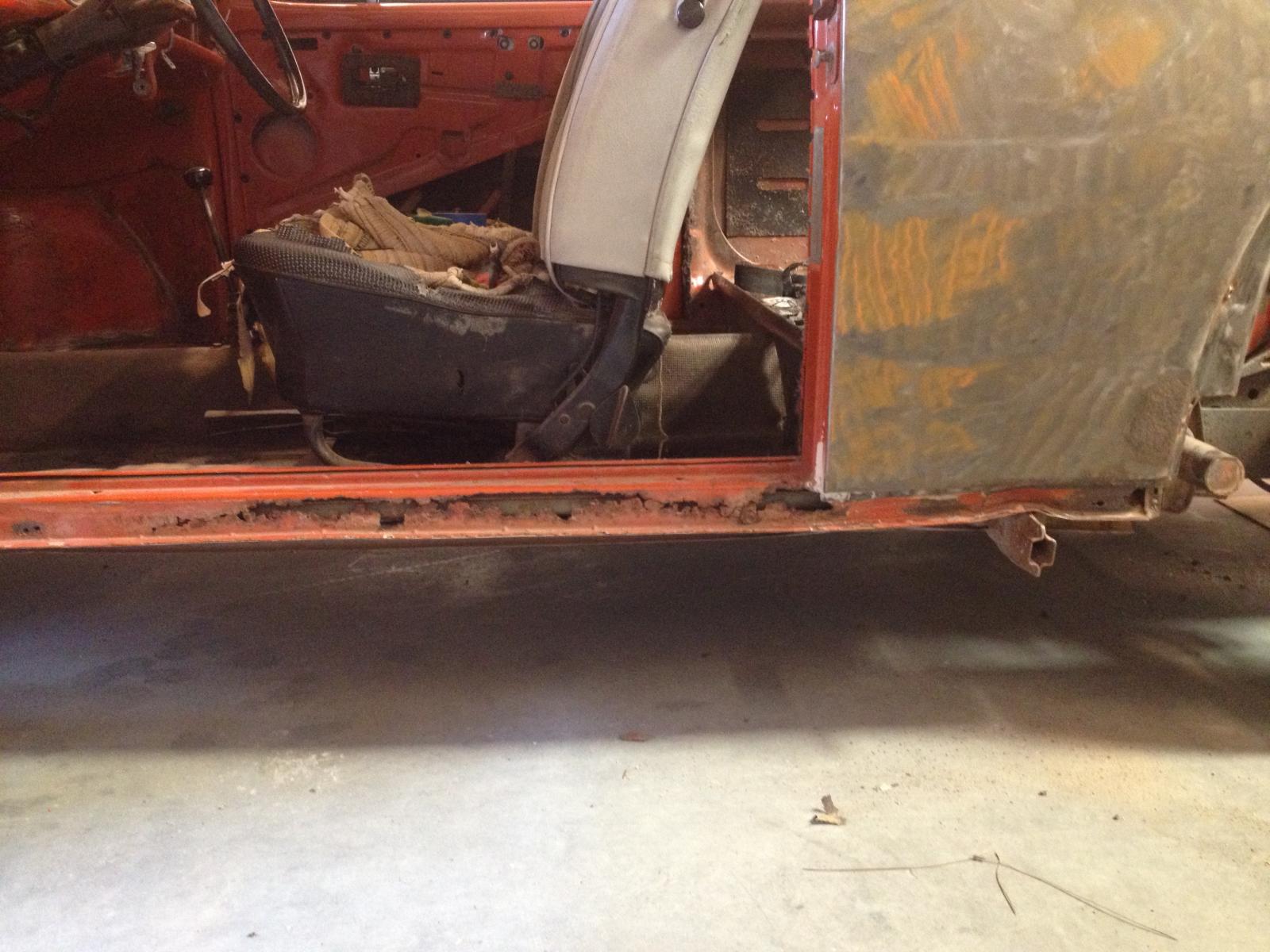

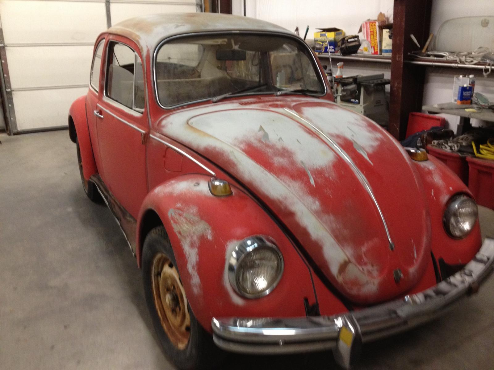

Brave? no. Foolish? Most definitely! A learning experience for sure. Luckily I live in a small rural neighborhood. And so the story continues. So unfortunately the bug sat for another year, this time in my yard, while I finished some projects I had going and trying to come up with a game plan. Finally, it was time to take it to work with me. I started by removing the fenders, bumpers, and what used to be the interior. Great...more rust. I decide at this point the only smart thing to do is to completely strip the car down to bare metal and see exactly what this thing is hiding. Oh boy! Hidden under all that 30+ year old orange paint was more bondo than I thought was even possible. This thing was starting to look like it was used as a bumper car at a back ally carnival. Shocked So the price list of new parts starts, new floor pans, new heater channels, new rear luggage tray. The right rear fender was new! unfortunately, it was installed over an old accident, the quarter panel is pretty rough. All said and done, My list just for sheet metal is at about $1000. Ouch! I realize that this is completely out of my budget, and even if I had it, I am still a rookie with the welder. I admit defeat... Crying or Very sad

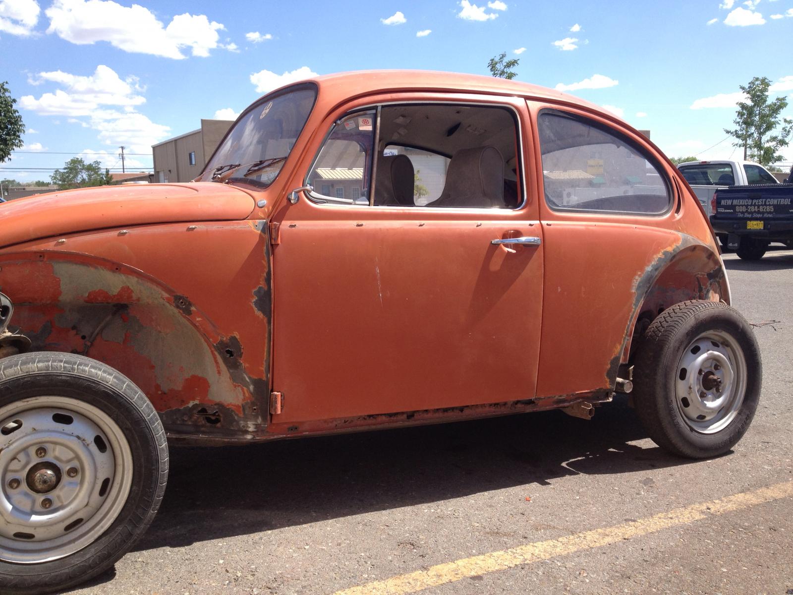

So here is the new bug. Not too bad at all.

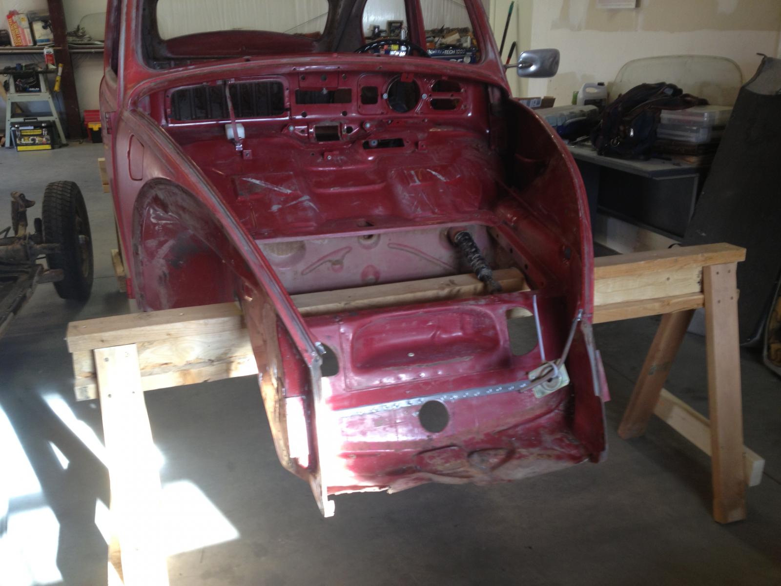

PostPosted: Sun Nov 25, 2012 10:13 am    Post subject: Reply with quote

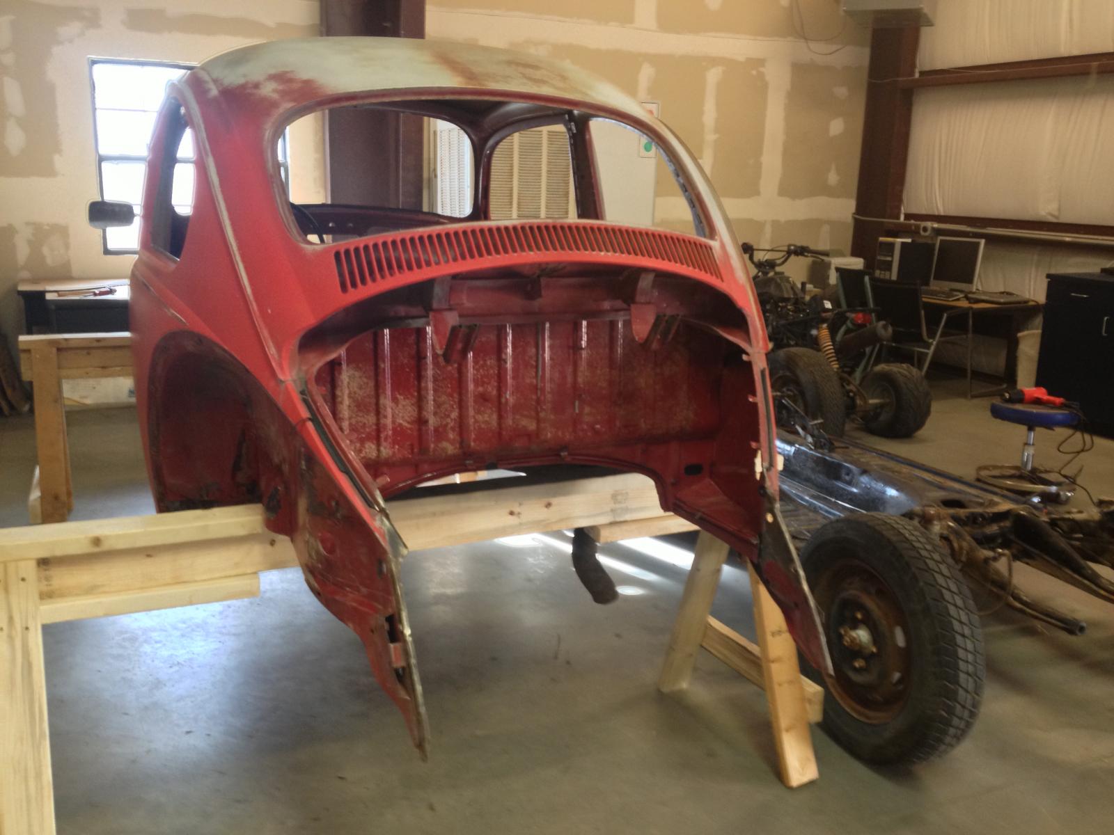

Got it stripped down and body off. I will be replacing both the front and rear aprons and the spare tire well.

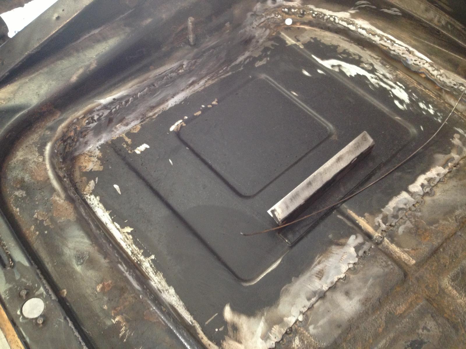

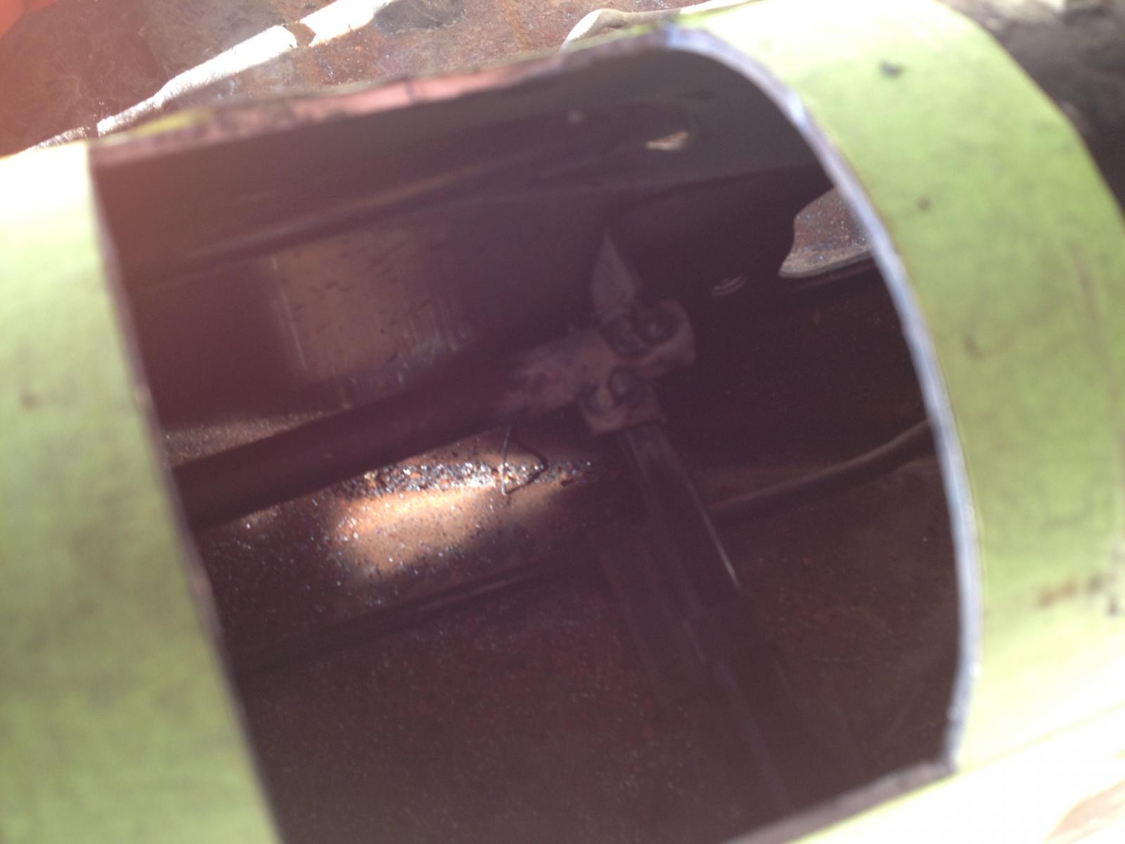

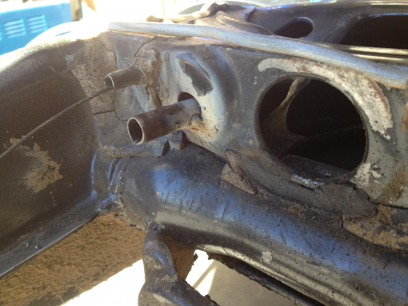

Finished my clutch cable tube installation today Very Happy Got halfway through welding in the new battery tray.

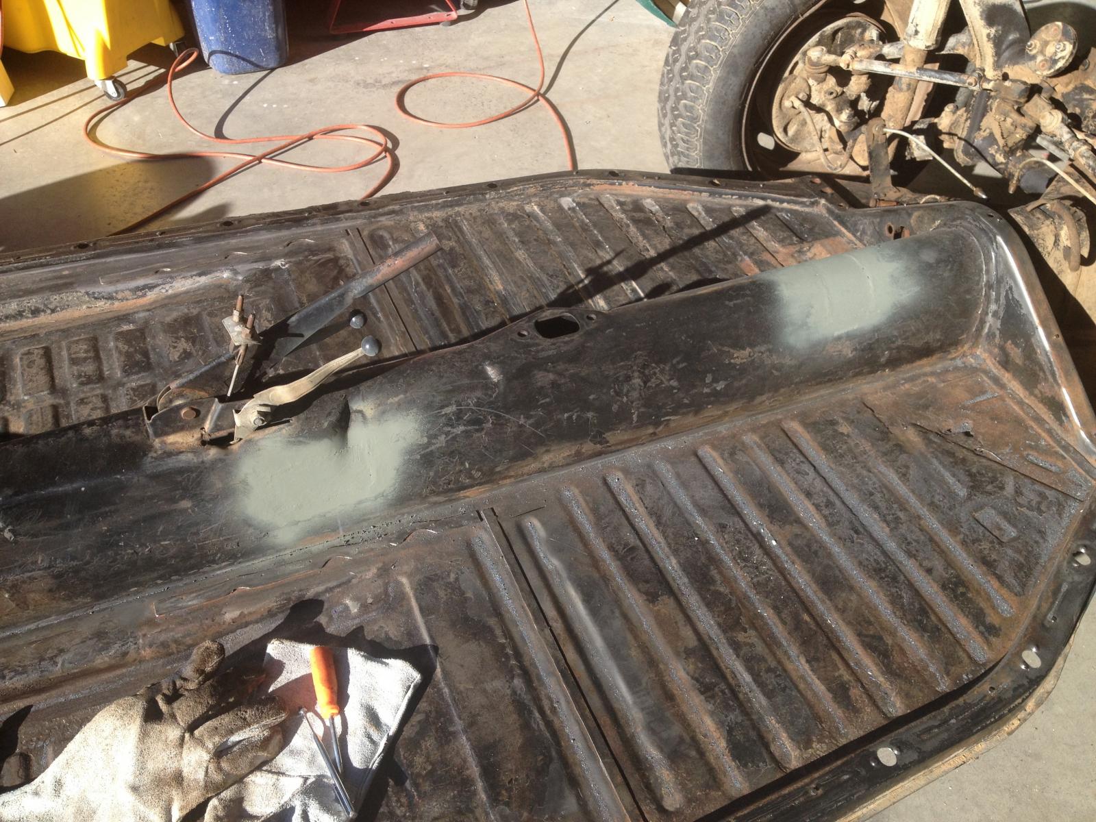

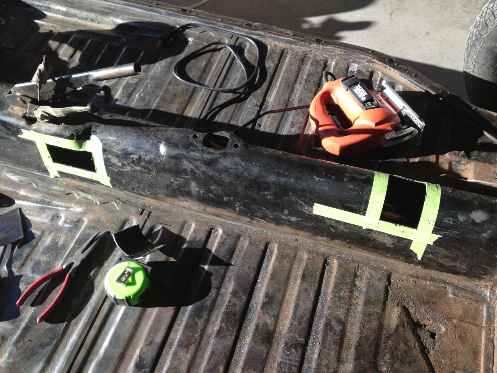

So progress has been kinda slow on the pan, work has been busy. I have been trying to strip all the old paint and seam sealer off the pan. I also found a nice hole in the right front floor pan so I have a new pan half on the way. I also plan to completely rebuild the front end (ball joints, tie rod ends, etc.) and wanted to see what you all recommend for parts, where to buy and such. Does anybody know where I might be able to buy a complete kit for the front end? And what my best bet would be for paint on the pan. I was planning on a few good coats of epoxy primer and several coats of single stage gloss black. I have heard a lot about POR-15 but I have no idea where to get it. Do I need it? I live in the desert so rust isn't usually an issue here, but this is my first bug and I understand they are maybe a little more prone to rust than other cars? I also thought maybe just using some duplacolor bedliner spray over some good primer. Thanks for your help guys.

PostPosted: Thu Dec 06, 2012 2:12 am    Post subject: Reply with quote
I wouldn't cut out that pan, I'd just patch the bad spot and move on. The new pans aren't nearly as solid as the originals.

I see what you mean. My pan half came in today and it is pretty flimsy. Should I just cut a piece out of it, enough to patch the hole? The whole area around it is pretty pitted, kinda worried about trying to weld to it. If I use the whole panel, welding would go smooth, but I don't want it to be weak.

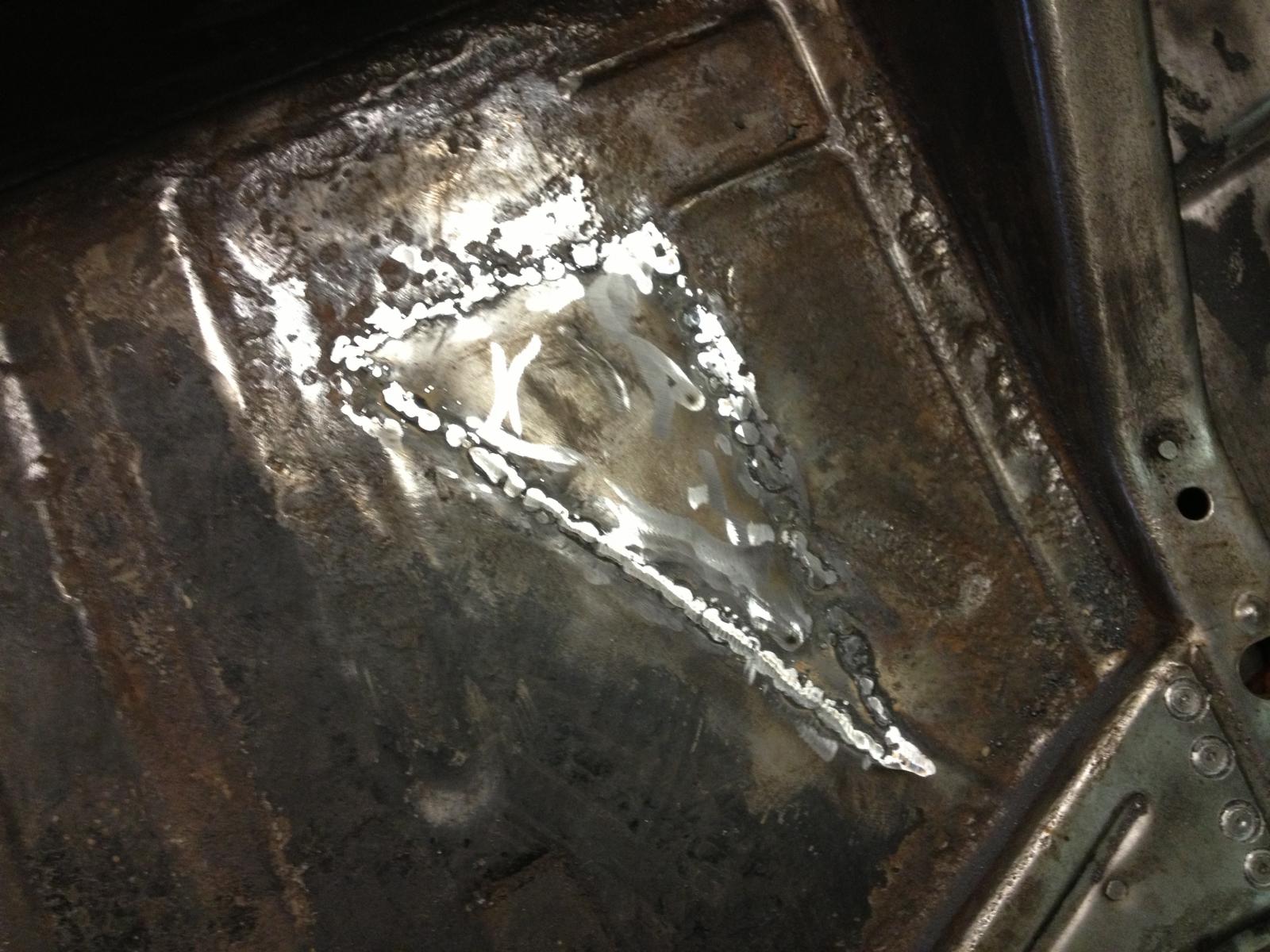

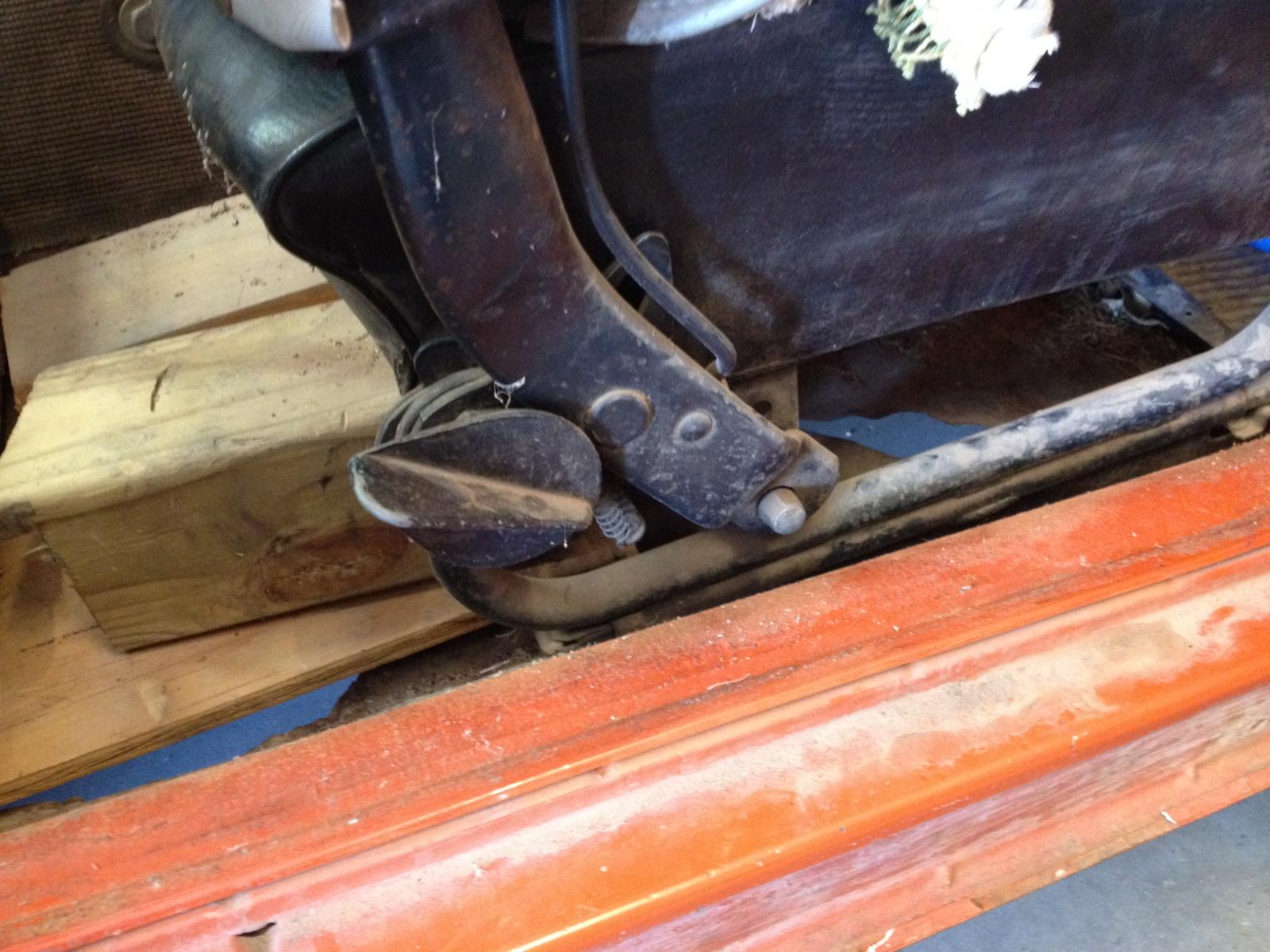

So I took your advice and made a patch for the hole in the floor. I have it tacked into place and it feels good and sturdy. I figure I can always use the pan half later if need be or maybe just put it up on CL. I replaced the battery tray also(probably didn't really need to). d'oh! Oh well.
Still need weld my seat tracks in and clean my welds up a bit(still a rookie with the welder). Embarassed The rest of the pan is fairly pitted, but thee are no more holes so I think i'll leave the rest alone. So as far as paint on the pan goes, would I be ok with a good epoxy primer and single stage black? I'm gonna do top and bottom, and maybe a bedliner coating on the bottom after paint. What do you guys think? And I will post a pick of the finished patch when I get it finished.

PostPosted: Fri Dec 14, 2012 4:25 pm    Post subject: Reply with quote
Got my patch job done today, came out pretty good! Very Happy
Feels good and sturdy, don't think i'll have to worry about it anytime soon.
