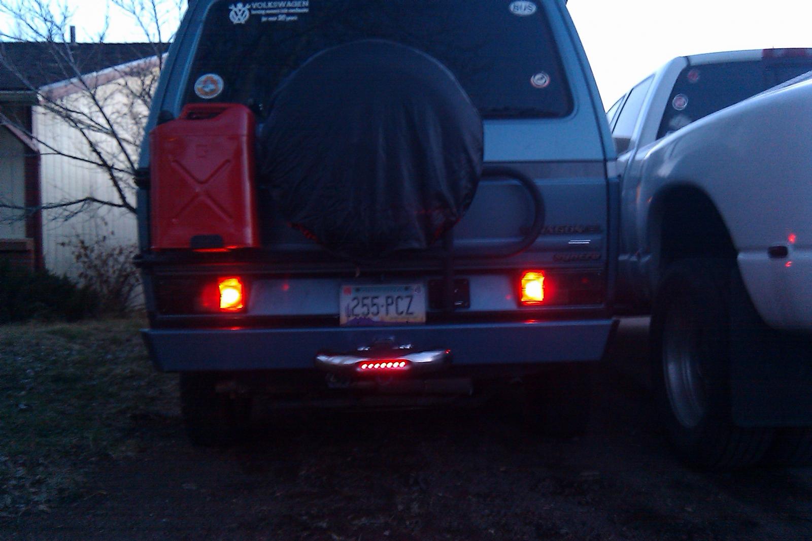

I for one wish that I could just "not like swinging it out of the way" to open the trunk! I have a gary lee, and I have also strapped to it a shovel, pick axe, hi lift jack, 5gal gas tank, and sometimes a bike rack.... in addition to a heavy tire/wheel, and I cannot open my hatch. The inconvenience of swinging it out of the way would be a blessing.
Don't get me wrong, I love the look of my Gary Lee rack, and love that it worked well for me. I may soon be moving on to a swing away though.
If I need to open my hatch, It takes a couple of minutes for me to remove the gas tank and tire, then I can pop the hatch.
Gary Lee's products are exceptional and truly impressive in quality. In my case, I just have strapped too much stuff to it!

I have the Gary Lee ladder with a gas mount, I have started removing the full gas can when camping as the hatch didn't seem to like the weight. I modified the stock tire location to hold a larger tire but would consider the Burley unit if I needed to move it, but prefer the stock location over anything else.
Added the yakima bike mount.

Love my Gary Lee rack, can open hatch in 10 sec. I can put the screen on love the fresh air. They are very well built . My ladder, I keep on the top rack, easy to get to. Extra gas is good , tire in back good, more ground clearance up front is good . Life is good! Very Happy
1987 syncro westy tin top sun roof , GW2.3, rear locker, decoupler, Gary Lee tire rack & winch mount, lift, south african grill, big brakes , rhein alloy ,15 BFG AT, Fiamma 10 foot awning ,140 watt rear 85 watt front solar , mppt, truckfridge, automatic fire extinguishing system, tencent oil cooler, And a RMW SS exhaust! - 1971 bug convertible 1776 engine- 2010 Subaru turbo - 1993 Toyota 4x4 truck - 1999 Harley 95 CI, big bore, Andrews cams . Also 80-84- vans. Stock 65 sunroof bug.
