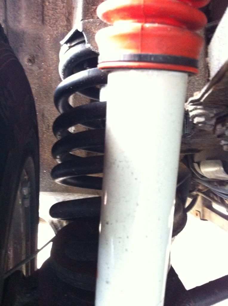

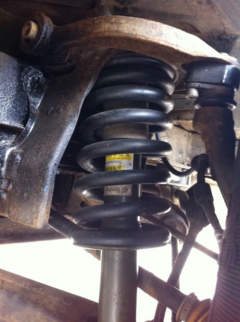

Thanks, i just took a couple pics of the springs with the weight of the van on them, not the clearest but its parked against a wall at the moment
fronts
and rear
these were taken with no passengers but with loaded roof box and full cupboards and a full westy luggage rack

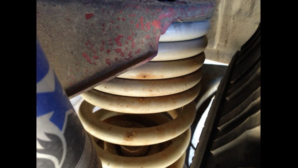

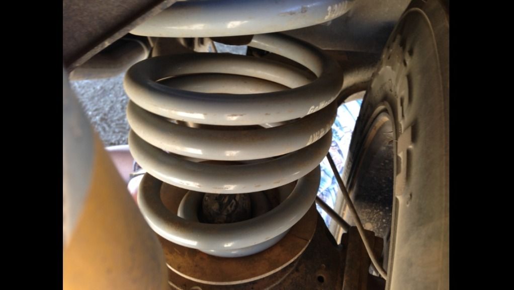

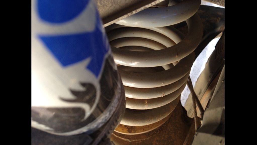

I hope you had a great weekend. I went to Big Sur with my Red Syncro Westy Camper with 2.5 AEl Tdi, rear tire carrier with 30.5" diameter BFG AT Ko's
It uses current issue GW +2 American Progressives. Here is a photo of my passenger rear spring. It uses 2.5" of shims to produce a ride heigh of 21"
And here is tdwestys SVX powered Silver Tintop Syncro, also at 21" ride heigh, uses GW Progressive +2's, HR issue, with 1.5" of shims, uses 29.5" BFG Mud Terrains
And here is ubercools 1.8T powered Silver Syncro Westy Camper, also GW's H&R +2 Progressives, only .5" of shim, to get to a 20" ride height. Uses 28" BFG AT KO
I believe tdwesty and I have similar vehicle weights of about 5200lbs but you can see that I need 1 more inch of shims to get to the same ride height. I think if ubercool was to raise to 21" like tdwesty and I, he might need 1" of shims, or possibly 1.5, not sure. I dont know his vehicle weight, but he travels heavily loaded.
