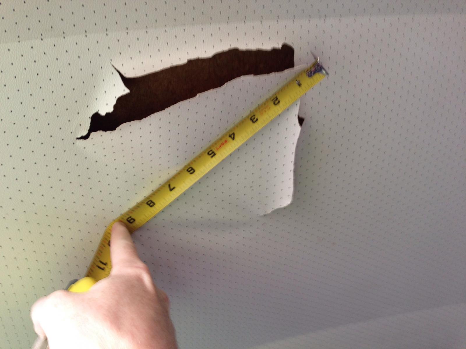

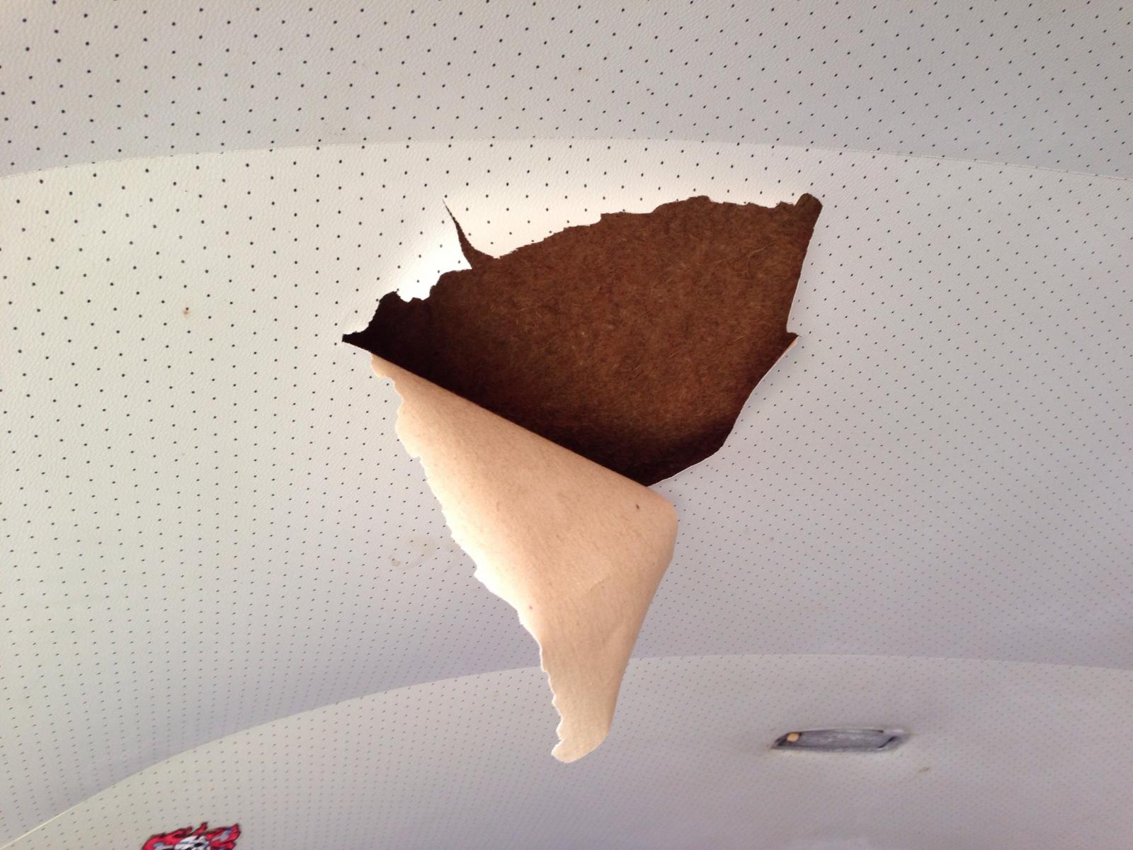

So I was cleaning out the bus, and while sweeping, I managed to poke a big nasty hole in my headliner. Mad

Measure the tear to see how much patch material you need to cut. Give yourself an inch or two extra.

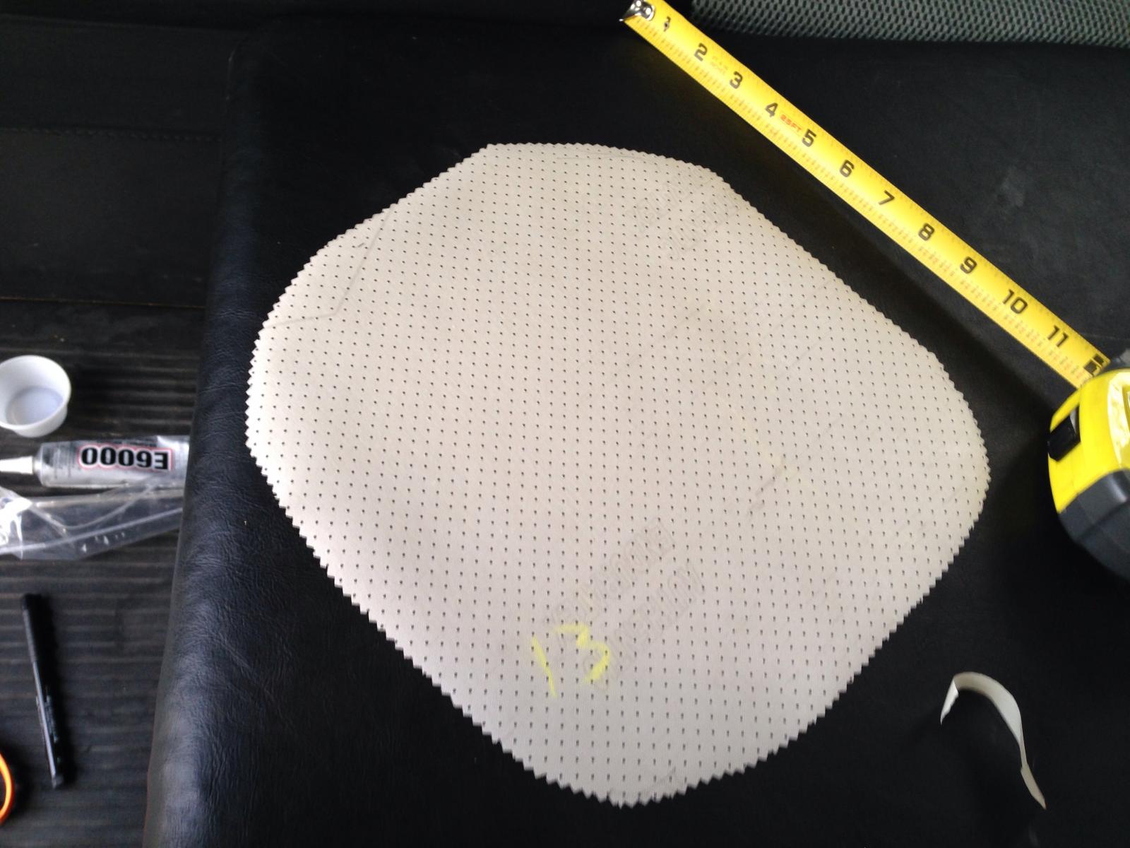

Cut out the patch material, use pinking shears so that the edges are harder to see (works better when your patch is the same color as your headliner).

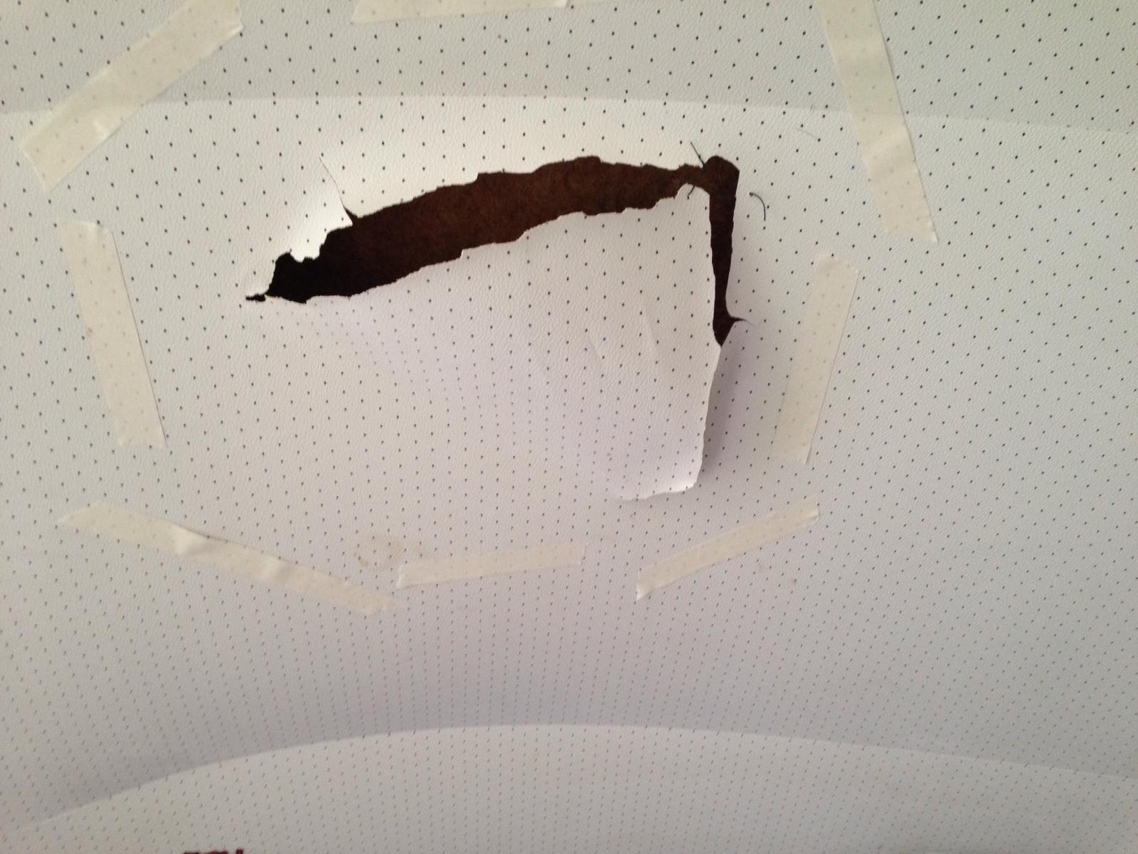

I used the needle and thread to tack the tear shut to make working with the patch easier. I also used tape to map out the outline of the patch to help when spreading the contact cement.

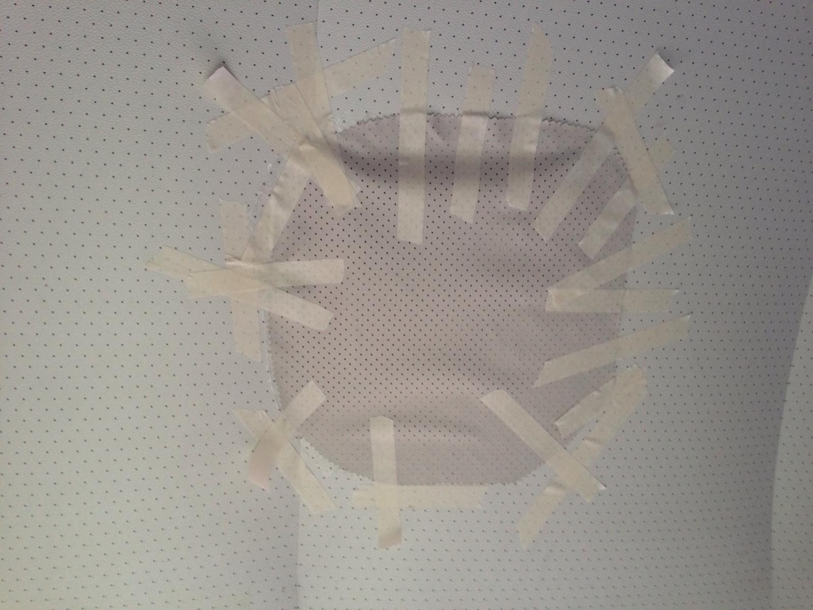

Follow the directions on your glue- I spread cement on the patch and on the headliner, keeping inside my tape lines. After that dried for a bit, I offered the patch up, keeping things as smooth as possible. I then taped up the patch to hold it in place overnight.
I know at some point in the future I'll probably replace the headliner, but for a quick, semi-permanent repair, I'm happy with the results.
