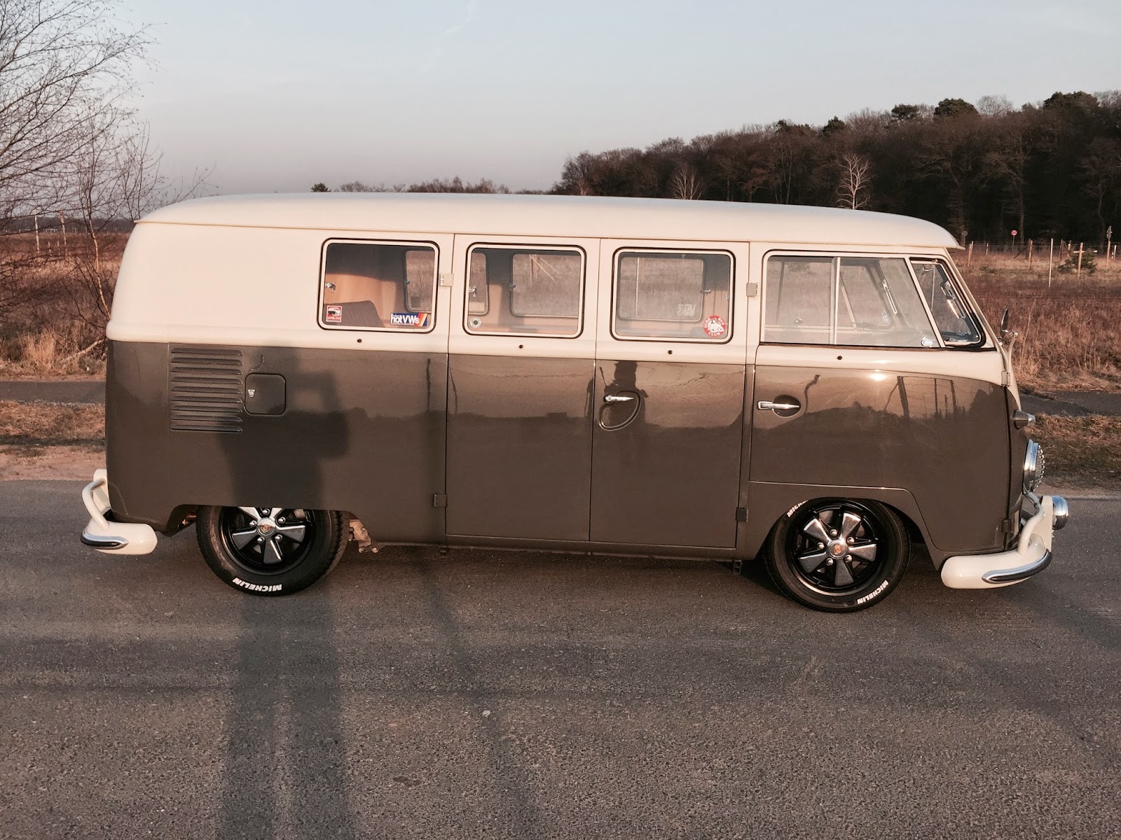

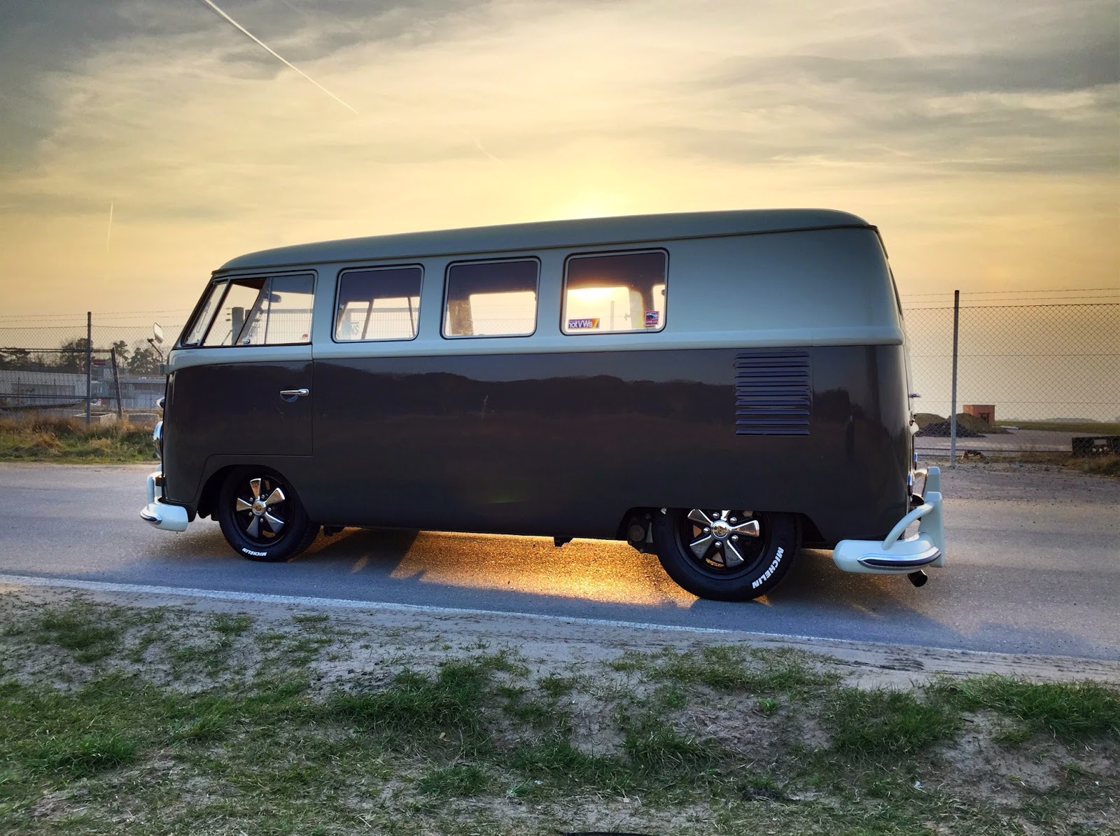

Does anyone have pics of cars on Fuchs detailed like this one?
I thought about detailing my ones like that, cause I've never seen this style on a car anywhere. But I can't believe there're no cars like this out there....
Thx,
Jan
Fake Fuchs, but no Photoshop this time Very Happy
Still fake Fuchs, but now on the Bus! Wink

Very nice ^^^^^^^^ Cool
