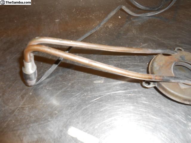

Regarding Tom's post about the inefficiency of the whole element heating up I don't think it does, this one looks used and it appears only the part on the sump plate turned blue:

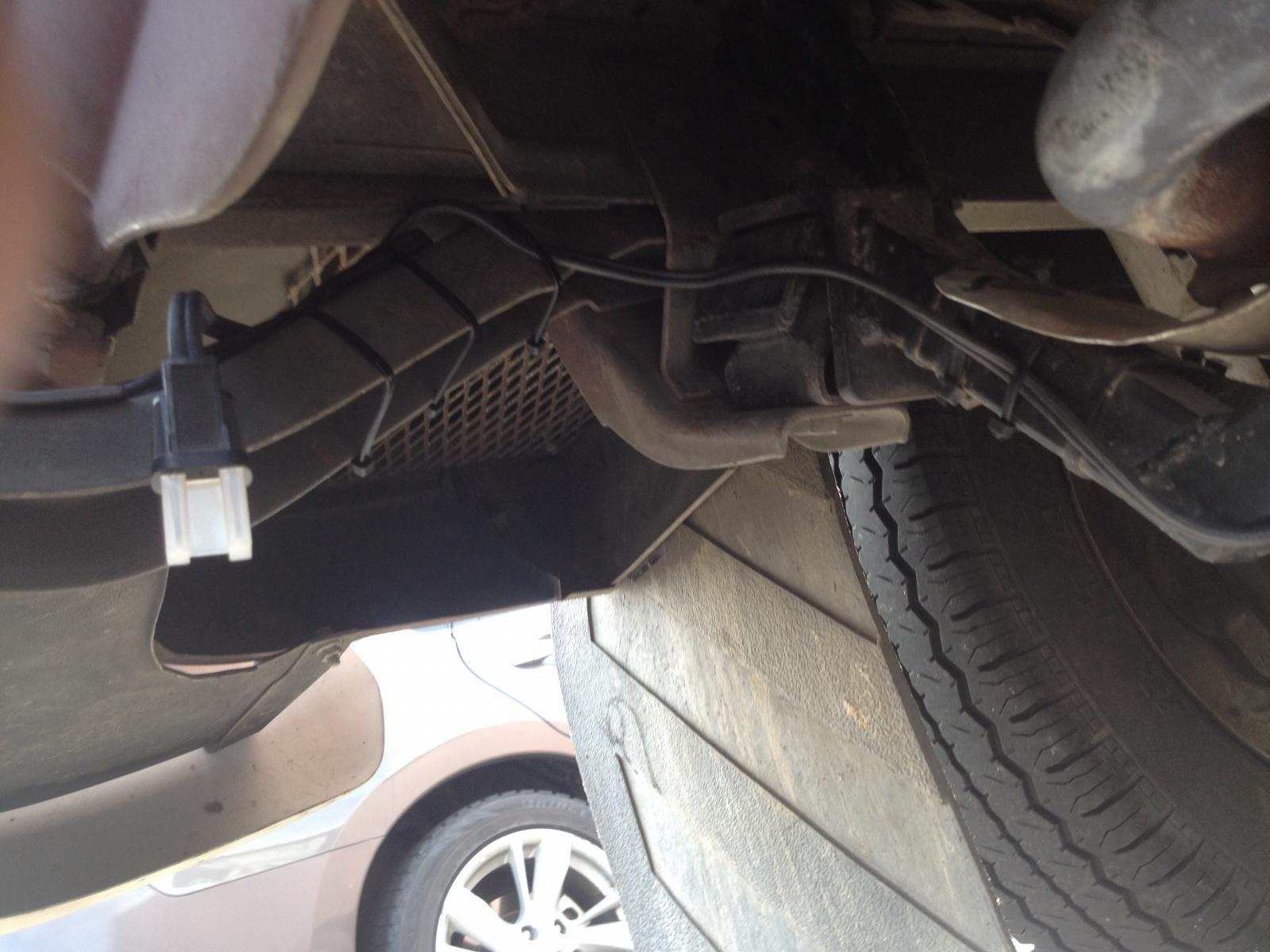

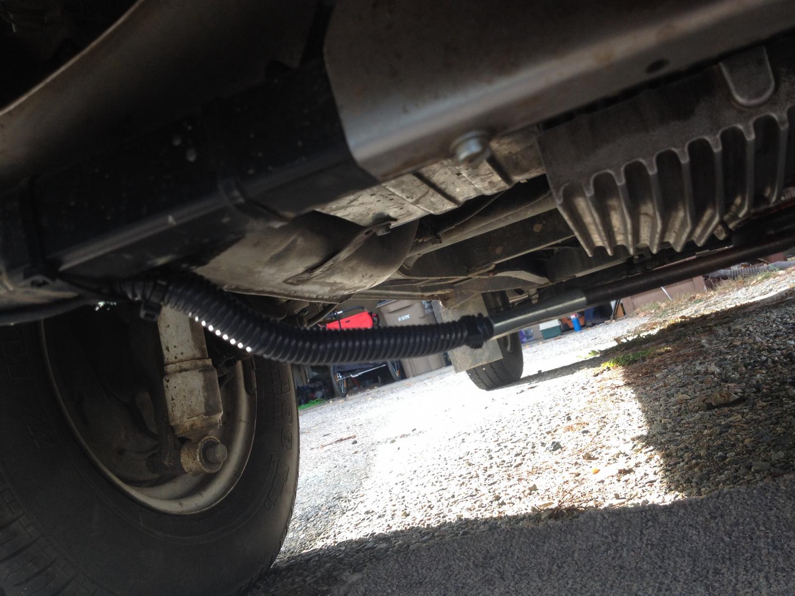

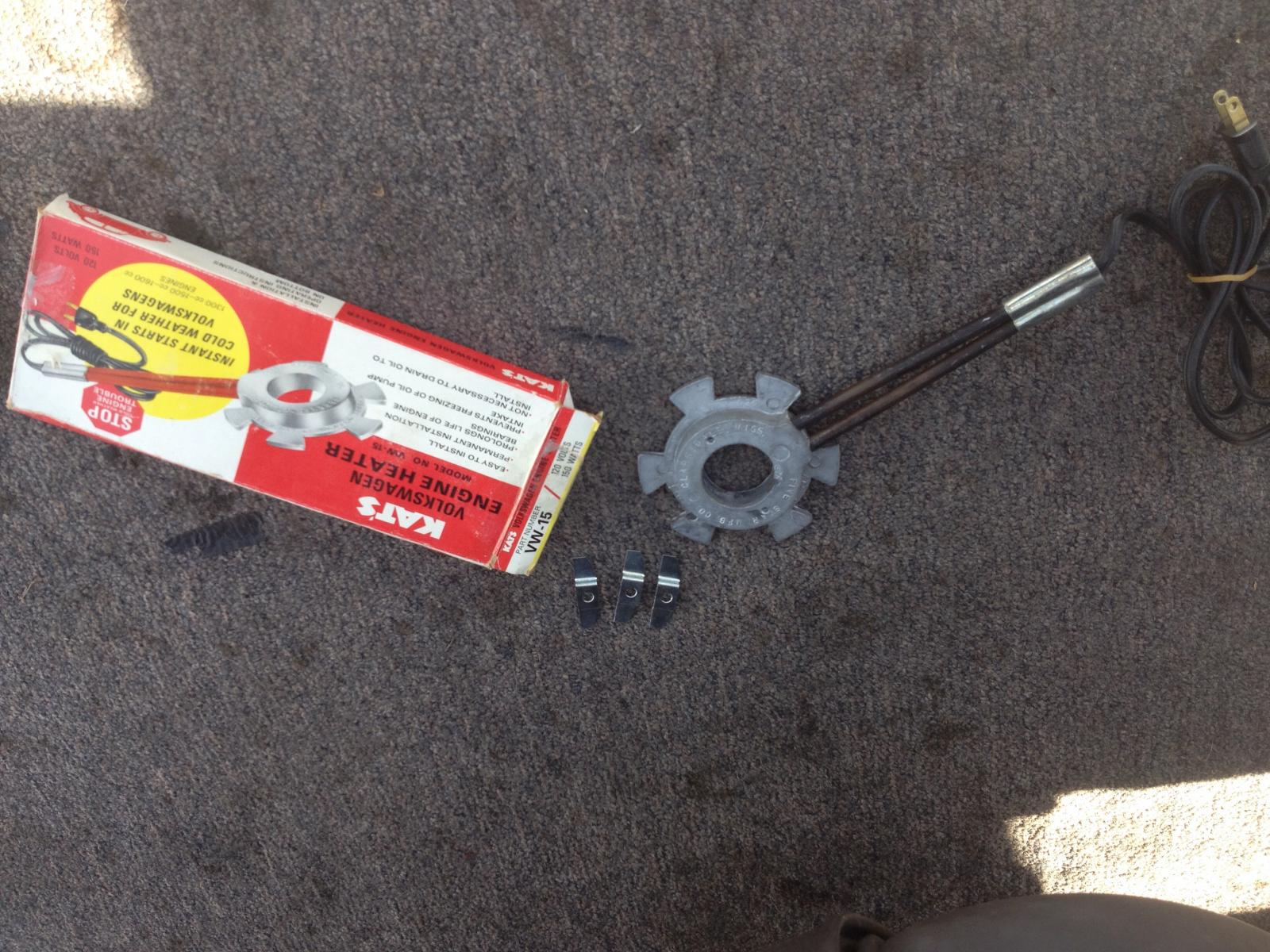

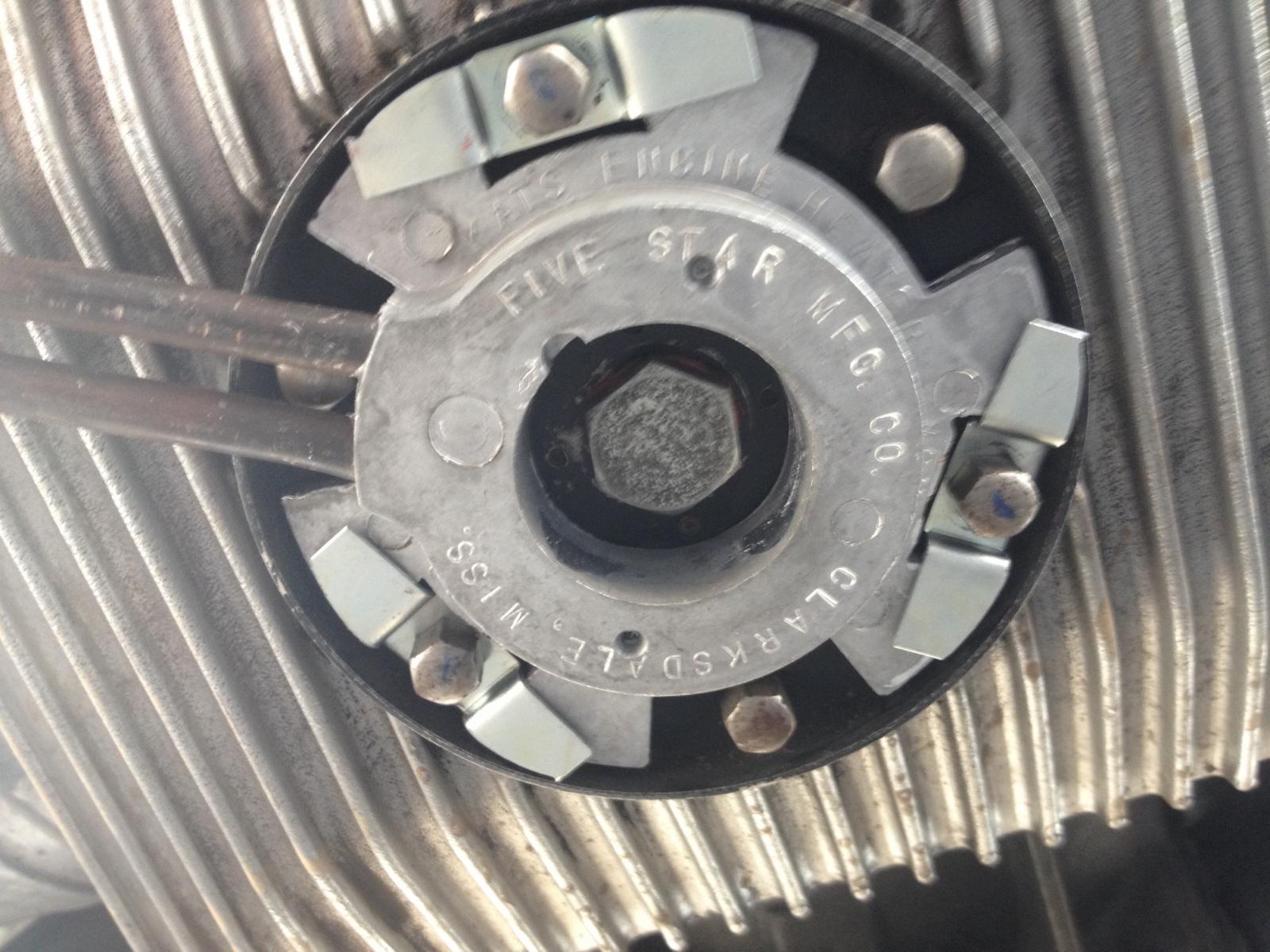

PostPosted: Sat Nov 22, 2014 1:58 pm    Post subject: Reply with quote
I recieved the Kats VW-15 oil sump heater yesterday. The box was a little ratty looking but the heater was indeed NOS. It took me around a 1/2 hour to install it with many beer sippin breaks. I was able to zip tie it nicely and make it look clean. I found a plastic cover for the plug ends in the garage. I used wire conduit on the exposed cord under bus to keep it out of the elements, as much as it could be.
The cast on the element was not the best. I went ahead and filed down the rough edges so everything would fit nicely together. I guess I'll see how it works on Monday morning.
