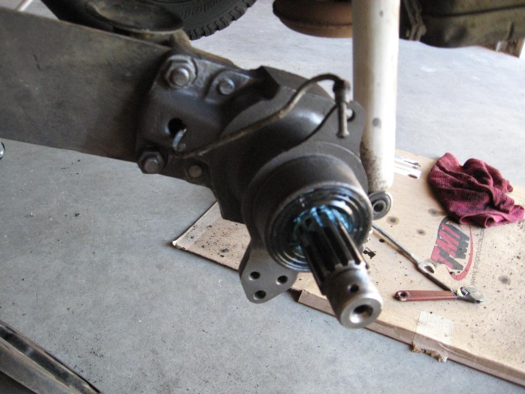

I did the driver side yesterday. The outer was toast. I ended up pulling the assembly off and using a press to do all the work. When I get to the pass side- it will go super fast.
Did you need use a press to just get the bearing into the housing, or did you use one to get the race into the outer bearing?
I'm picking up my new outer bearing tomorrow morning...hopefully that will fix the issue as SGKent described.

At first I bought a generic clamp puller from NAPA to push the spline out. That sucked ass! When I came to my sences, I realized that the press was my savior. I used it for everything. Pushing the spline out, pushing bearings out, pushing new ones in and finaly pushing the outer collar on - the one in which this thread was started for....on. But I had to go to Home Depot to get a pipe piece that would go around the spline be more than 4in long to push that prick on.
In the end I got it about 70% on. Ill need to hone the inside of the pipe out to get to 100% press a bilaty. But it didnt matter because when you put the hub back on it will press it on the rest of the way when you torque the big nut on the outside! Stopping on the spacer and inner bearing.
When I do the pass side, Ill lay out a step by step. Its hard to give nuggets of info to the average shade tree mechanic in us when Im privy to a wide range of cool shit in my cousins large ass covered garage that makes my wrenching life easier. But the press is a harbor freight deal that came in handy in this case.

the inner race should slide on, sometimes just finger tight. If it is too tight it may mean the outer bearing is oval in shape. That is what I ran into on the KMM bearings. Light taps is the most it should take to slide it in.

Well...got the FAG bearing and installed it. It definitely went in easier than the PEX one. Got everything back together and still hear that growling noise. Ugh...I'll do the other side now which will go a lot quicker....I'm just hoping this noise really is wheel bearings and not some stupid trivial thing. I have new CVs as well.
Anyway, thanks for all the advice. It helped a lot.
