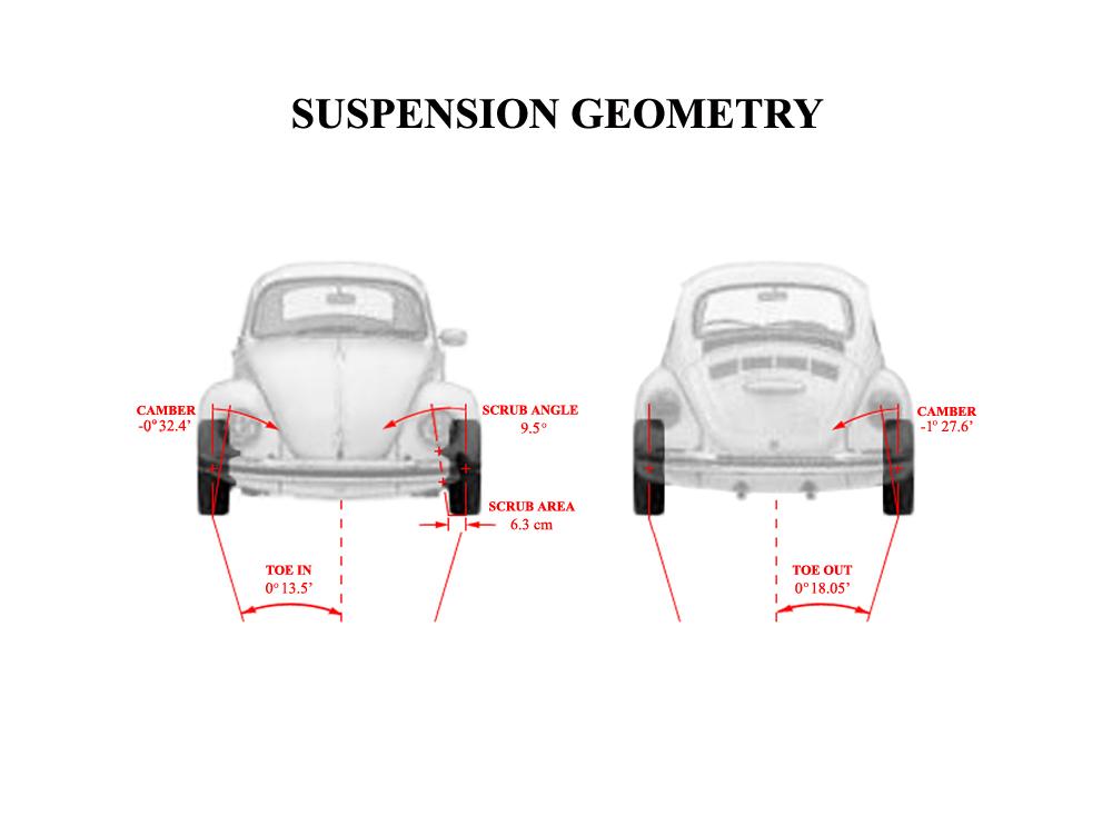

The last time I took my machine in for a "professional" alignment was back in 1997, right before the first of many cross-country roadtrips. I watched the guy put the car on the rack, hook up the machine, look in vain for the specs in the computer, take the car back off the rack without turning a single nut or bolt, and go for a spin around the block. When he came back he said, "Yep, alignment's good." And then he charged me $25. So now I do my own 4-wheel alignments with a string line, plumb bob, angle gauge and tape measure, and it never ceases to amaze me how simple it is to do.
For what it's worth, if anybody wants to have an idea of what the SAI and scrub radius of a late model, Type 1 standard Beetle is, here is a little illustration of the current specs on my machine:
Note 1: I use the terms "scrub angle" and "scrub area" for Steering Axis Inclination and Scrub Radius, which might not be technically correct, but there you go.
Note 2: I have drop-spindles with a disc brake conversion, which kicks the track width out by about a quarter inch per wheel, the wheels are about one inch smaller in diameter than stock (24" as opposed to 25"), and I also have the front camber adjusted for max negative, all of which will affect SAI and scrub radius accordingly.
