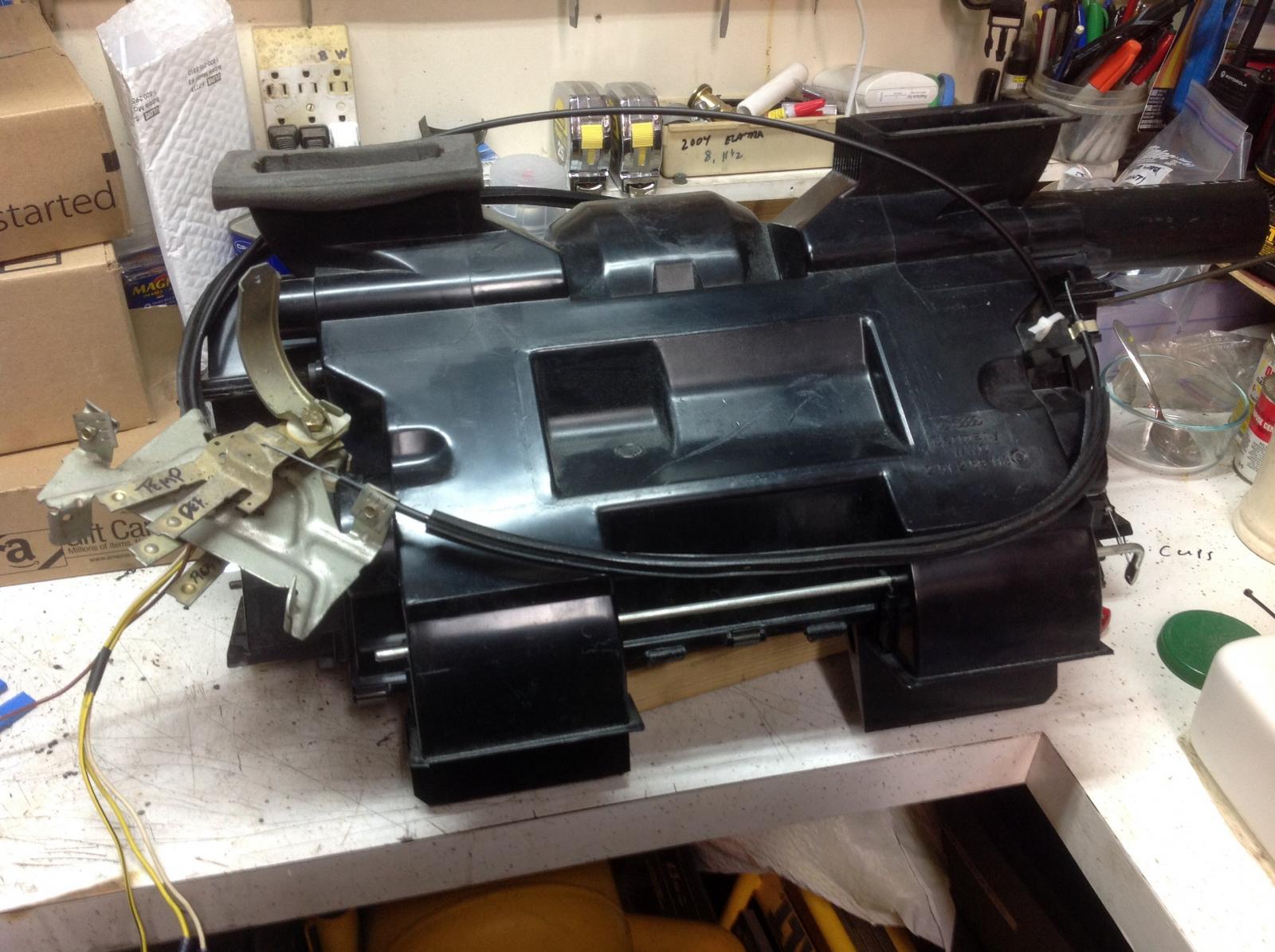

Ok,
The unit is reassembled. I used the recommended clips, VW Part #321-819-059, eleven are required.
As I reassembled I tested the flap operation watching for binding. I lubricated the pivot points, all were good except for the Floor Heat Flaps.
The operating cable for these flaps was severely bent at the control levers and had been for quite some time based upon the deep gouges in the lever body from the cable end dragging across the metal.
I don't know why but the outer sides of the heater flap pivots was distorted, as if it was melted?!?

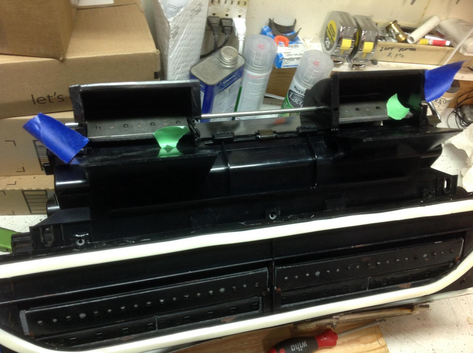

I removed the flaps.... The ONLY flaps that are easily removed! (Depress the lock tab on the retaining tabs at each pivot point)
I used my heat gun and reshaped the plastic back into the general shape it should be.

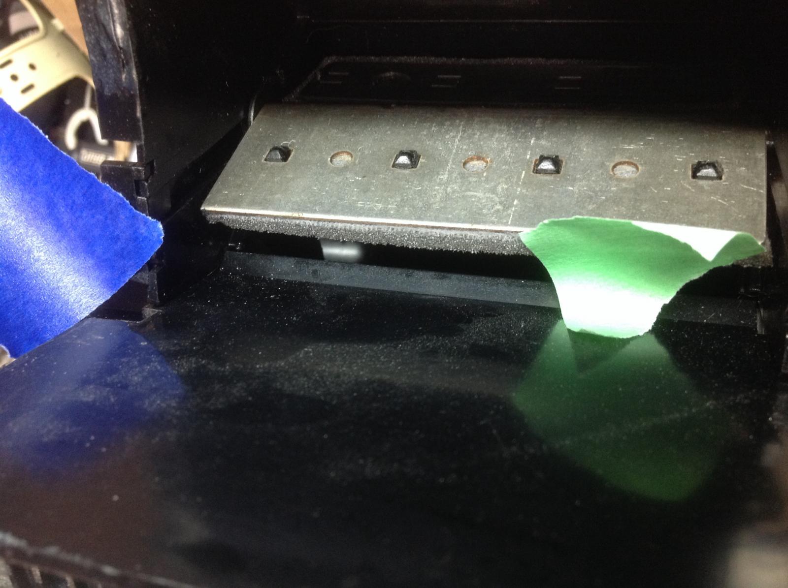

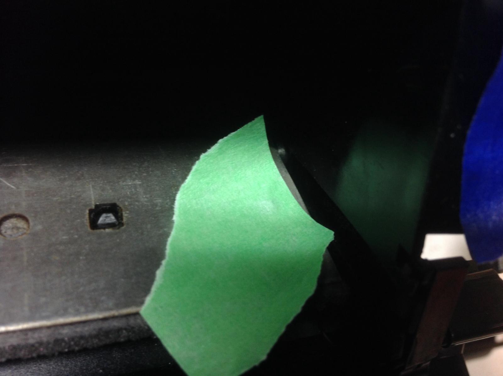

I now had some severe binding to fix. The flaps were rubbing on the sides and catching on any irregularities.
A washer at one end fixed that one point but others required filing off almost an 1/8" of flap!
The blue tape is where the plastic was Misformed, the Green tape is where I had to file the heat flaps.
All said and done, it now pivots effortlessly! Smile
Now, here the cables are reinstalled. The control unit is adjusted, the cables completely lubricated inside........ SWEET!!!
Now to install it for a test fit, I need to determine the new air flap operation interface and install the cabin air check valve on the 2" black pipe that I added onto the top.
Sadly, one of these heater flap retainers is missing...... It works fine without it but it would be nice to locate one........

It's been a busy Saturday but I finally found a bit of Van Time........ Wink

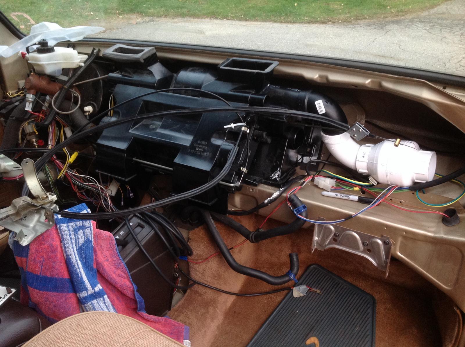

Having the Air Box reassembled, I carried it out to the Van and set it in place.
By doing this I Was able to determine the length of the new Fresh Air Flap operating cable.
I am using the cable that the factory supplied to open and close the rear fresh air flap to operate the new fresh air flap..... (Bottom Lever).
I was also able to determine the length of the 2" ABS Cabin Air Recirculation Pipe I installed onto the Air Box.
I brought the unit back to the warm garage......... And RAN OUT OF PROPANE!!!! Rolling Eyes
Still, it's out of the wind and the garage is 54* so not bad. I do have a small electric space heater pointed at me as well. It cannot warm the garage but it does warm my aging bones!

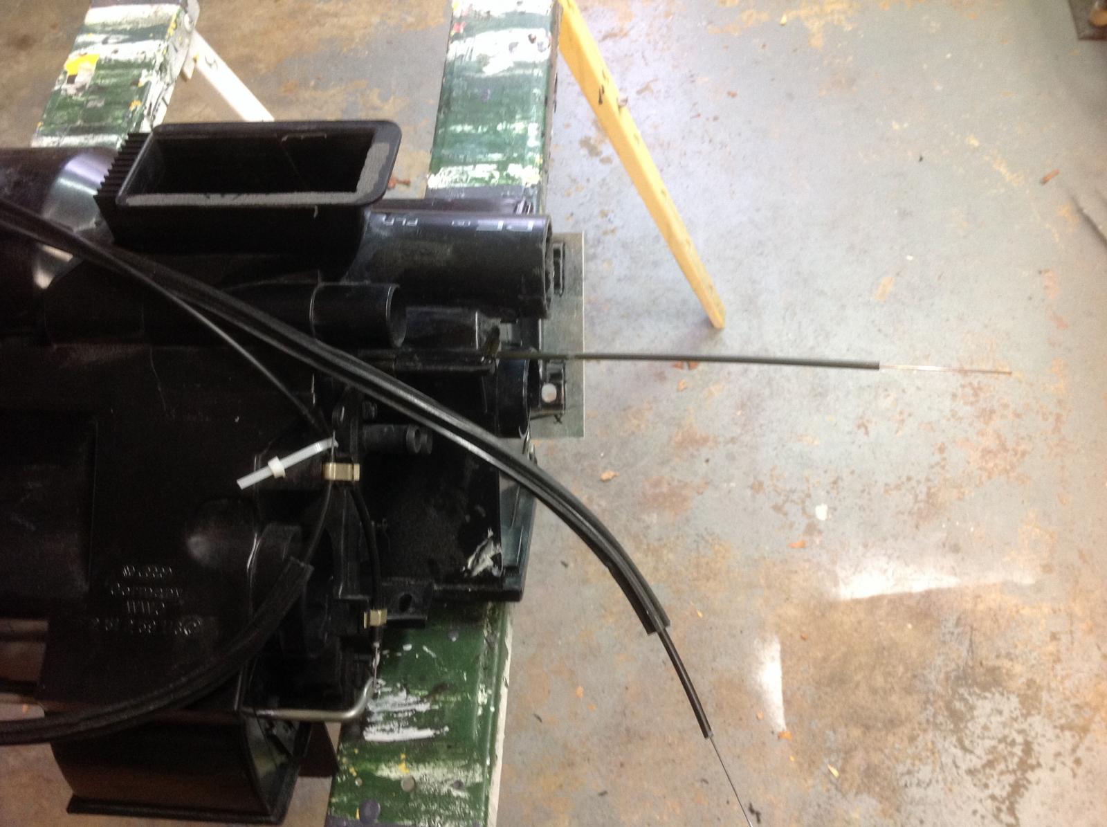

Anyway, cable and air pipe cut off, the two cables need to be connected........
What to use??!!?........ I've boxes containing 50 years of misc car crap....... Let's take a look............ Nah...... I've got my Dads stuff as well...... I'm thinking 80 years of accumulated crap!.........
Hmmmmmmm........ A cable clamp........ If I replace the screw with an allen set screw on both sides I can use one screw as an anvil and tighten the 2nd against it, squeezing the operating cables tightly but NOT deforming them.....
So, using some Gorilla tape, I Temporarily taped the two cable housings together.
I was then able to determine the cable operating lengths and clamp them firmly together......... BEAUTIFUL!!!!! ..........

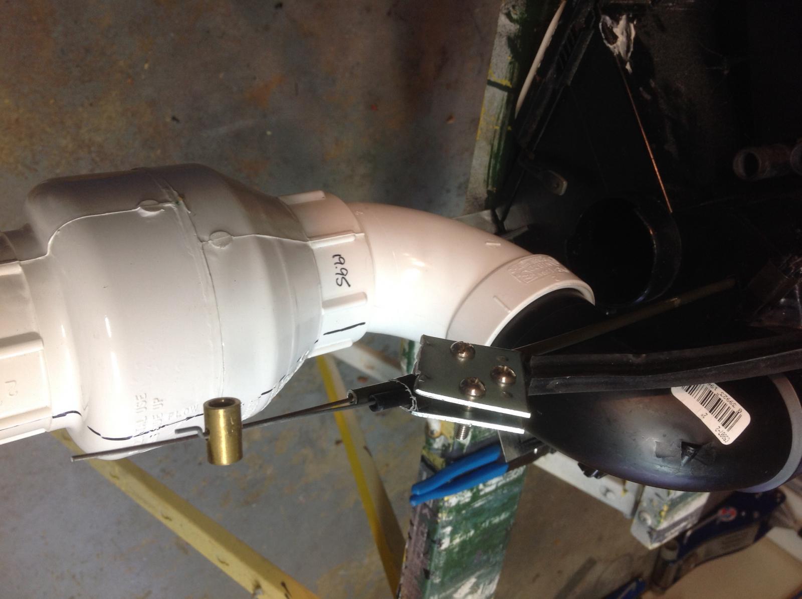

I purposely left the rear fresh air flap cable unmolested, I enlarged the hole to get the 90* crook through....... You never know...... Don't go burning bridges behind you!..........
Next was a permanent cable housing clamp. I used the same 90* angle bracket that I used inside to hold the cable housing in place but I cut it in half so I had two flat plates.
Using 10-32 screws and nuts I securely clamped the two cable together.......
Photo shows the cabin air check valve as well. I stepped it down so that I can brace it from vibrating under the dash.........
Before clamp......
After Clamp.........
Now to go test fit this as a complete unit.
I need to reinstall the wiper mechanism and the washer nozzles before I bolt it into place........

Now I know, most of you will look at the photo and say "Big Deal....... A Heater Box!"
I however look at the photo and think "YES!!!!! I did it! A fresh air shut off flap and cabin air recirculation!!!"
I'm a happy boy! Wink
Now to put the wiper system back in...... Clean the electrical ground trees, bolt the air box in and reinstall the dash!!
It's like Christmas!........... I'm so excited!!!

An update.....
Real World use report on my fresh air flap modification......
yes, Yes, YES!!!!!!
It worked WONDERFULLY!!!!
As desired......... I Had plentiful ram fresh air, I Had fan forced fresh air, I had NO fresh air and recirculated the cabin air.
Possibly the best feature was when using heat, by manipulating the control levers I could either cook myself out of the Van or just have the faintest whisper of heat to remove an evenings chill.
Very very happy with the results.
Dave
