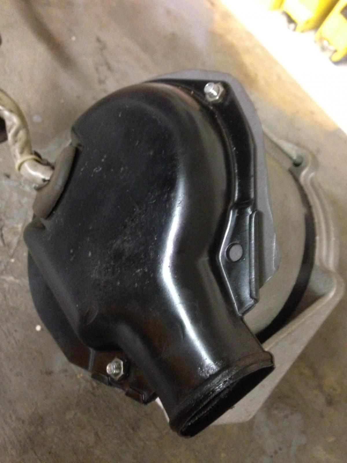

I'm sitting here with my 021 903 655 D. It has a "D"-shaped outlet. Here's a photo:
Is the thing to the right of the part number not a "D"?
Can anyone here that has replaced this part on their late bay bus please add to the conversation?

I'll outline the facts:
1. All 3 boot types have a round inlet end that fits into a round hole in the fan shroud. When the c-clip/wire is in place, yes, it does distort the inlet to give it a slight D-shape.
2. The 021-B boots have a smaller inlet end than the -D boots.
3. The 021-B and 021-D boots have a prominent molded, D-shaped outlet end to fit the 50A alternator. I posted a photo of mine earlier.
4. The 022 boot has a round outlet end to fit the 70A alternator.
Outside of these facts is VW Heritage's part they are calling "021-xxx-xxx D" which is visibly NOT the part it claims to be (again, see my photo of an original part).
I don't contest that the 022 part with the round outlet may fit the 50A alternator. However, the original 021-D part does NOT have a round outlet and it does NOT have a D-shaped inlet.
I'll contact VW Heritage and report back with findings.
