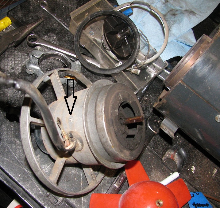

In my vast amount of skill and stupidity I managed to break the grounding screw on the motor housing.
It all started when I was inspired to find out why my fuel pump on my BN4 decided to stop working 8 months ago. Per this below post. “Heater (fuel pump) question”
http://www.thesamba.com/vw/forum/viewtopic.php?t=3...p;start=20
After trying some similar procedures I discovered the pump would work as long as I had the spark plug disconnected. This also worked in reveres so I surmised perhaps I too needed to check and clean my points. This would be a new adventure being I never had the BN4 fully dismantled…
A long around step “8. Remove the screw holding the brown ground wire to the motor housing.” I broke the screw off in the motor housing… BLAST!
I believe this unit has never been disassembled so you can imagine everything is very had to take apart.
Now I need to know something before I really screw it all up.
Can I still proceed to step “9. Give it a tap and the motor assembly will come out of the housing:” without destroying the unit?
I have tried to tap it out but it is well stuck from all these years of being used.
Where should I apply the force if I can in fact tap it out with the grounding screw still in?
///Mink wrote:
I wasn't sure where to add these pics, so I'll put them here since I spent most of my debugging time in this thread. I troubleshot mine to the point that i knew I needed to clean my points, but for the life of me I couldn't figure out how to get to them in the first place. There were lots of references to "just pull the caps off and bam, there are your points". So I figured these might help someone else.
To get to the points, the fan motor has to come out. So pull the heater out of the car and get it on the bench.
1. Remove the 4 screws along the seam in the outer case
2. Pry open the case enough so that you can get to the clamp holding the fan assembly in:
3. Using a 10mm wrench, socket, whatever, remove the bolt and the clamp.
4. Disconnect the 4 fan wires (brown/black/green/white) and feed them through the outer case while pulling out the fan assembly.
The fan assembly is out!

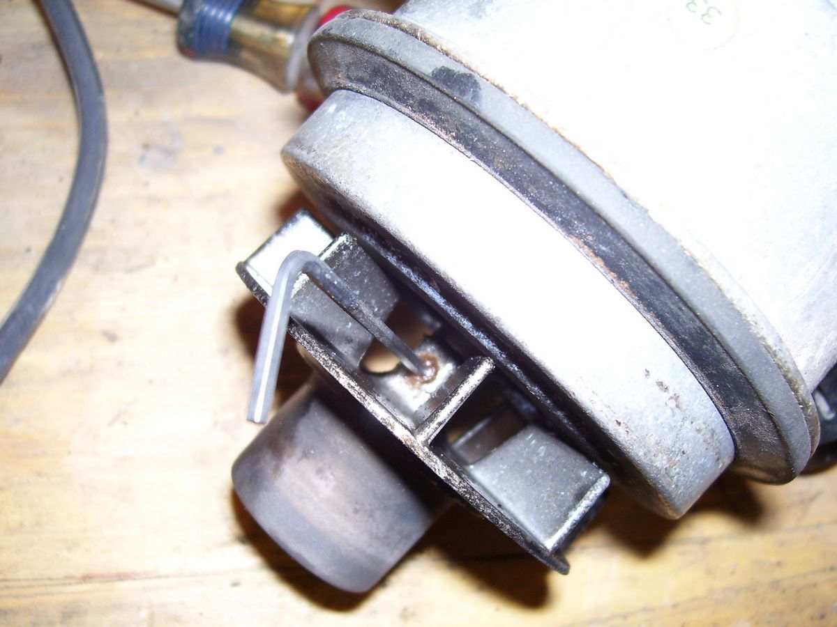

5. Remove the small rear fan - it's held on with an allen screw. You will probably have to clean some gunk out of it to see it.
6. Remove the big orange fan - thread a 4mm screw into the brass fitting to push the fan off the motor shaft. A Bug taillight screw works great for this.

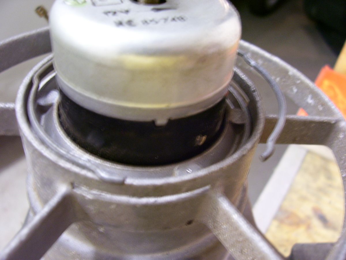

7. Remove the clip holding the motor into the housing:
Now you can follow the procedures in the rest of this thread to clean and adjust the points and/or replace the capacitors.
I hope this will help someone in the future.

I am being defeated on getting the small set screw holding the inner fan out. I have broken or bent every allen wrench that I have of the correct size. Have soaked the screw well with several different sprays. Thinking that it might be time to try heat. Somewhere I have one of those tiny butane torches so will try that. Guess I should make some form of heat shield to go between the fan and the cavity underneath it.
Thoughts?

I guess soak and heat as you suggested, if that fails I guess your gonna have to drill out the allen bolt and if you must maybe tap one size bigger if you mess up the threads drilling it out good luck

Heat worked, I couldn't find my little Butane torch so I used the oxy-act rig with the smallest tip I have. Made a heat shield that fit between the impeller and the housing and gave it a few seconds of heat against the hub. Came free very easy.
What someone needs to do is come up with an electronic pulse generator for both the pump and ignition points. They electronics could just sit up under a cover on top of the unit with all the rest of the controls so would be easy to access. I wonder what is used on newer heaters?

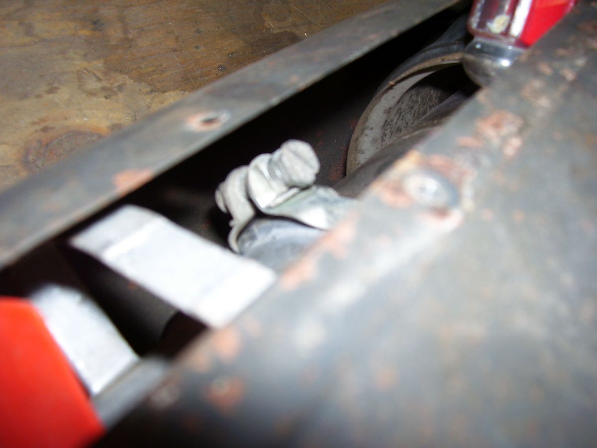

I have my heater torn apart. I followed the flowsheet to determine that the fuel pump wasn't receiving the signal from the points.
Got it all apart to reveal the points on both ends of the fan. Both were pretty dirty, a little corroded, and there is a lot of very fine dust inside the caps!
I was just curious about the best way to clean all that up? (I'm thinking contact cleaner should do fine.)
Also, what would be best to lube up the gear for the fuel pump points?
And while I'm in there, can I somehow lube the bearings of the fan? When I initially got it to run, it was making some bad noises but it quieted down. It sounds much better but is still a little noisy.

I ended up using white grease on the gear, and some silicone lube on the rubbing block for the other points. I attempted to dribble some silicone down into the motor bearings by the shaft though I don't know how much really made it down in there.
Since I couldn't easily find the info in the thread, I'll say that the point gap I used on both ends was .018. I used a metal nail file to clean them up, and hosed the whole area down with contact cleaner before lubing.
When I first tried to fire it up, the pump still didn't run. But just to see if it would fire up anyway, I clipped a jumper wire from the wire that is controlled by the points, and grounded it at roughly 3/second as I saw was the rate.
The heater fired up pretty quickly doing that. After a couple minutes, I quit manually working the pump and it was going on its own. I have no idea what the initial problem was, but that worked.
I let it sit there and run for a while, and the thermostat was cutting the pump in and out properly and all that. Also it times out after the heater is switched off properly.
