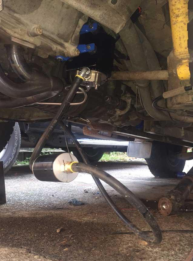

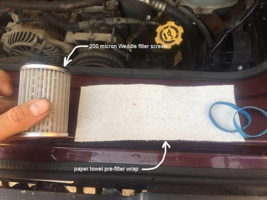

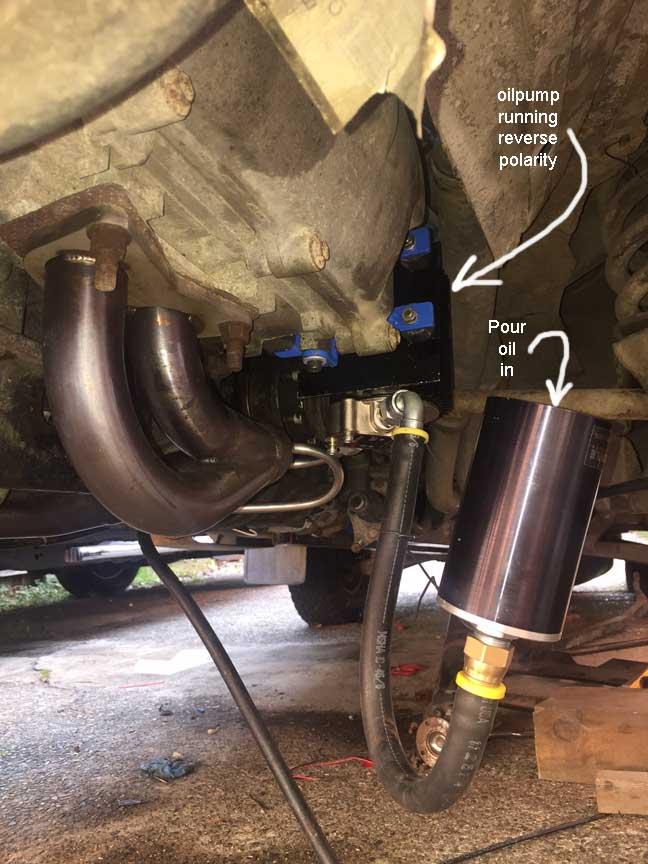

I can still do that, if this method doesn't satisfy. Here's some pics of what's going on.
Filling the trans with motor oil 15W-40. It sucks the 15w-40 in just about as fast as you could pour it from a quart bottle. That gives some idea the volume being sprayed at 4th gear. 90 might flow well at 150*. ??

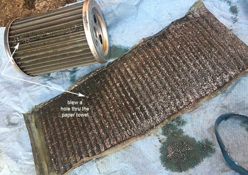

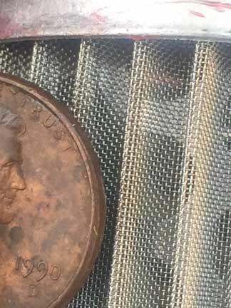

Here's the 200 micron screen of the Weddle filter.

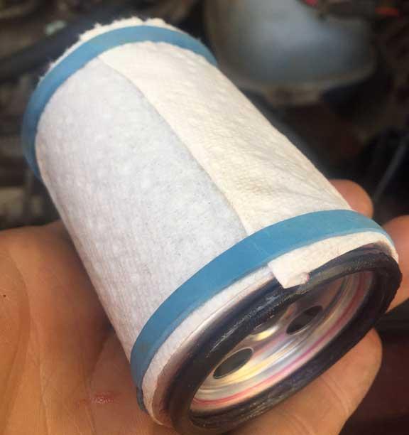

Decided to add a pre-filter of paper towel
Wrapped around and held with broccoli bands.
Ready to pump oil. Only the filter, no radiator.

The van is idling, 4th gear, no half-shafts, pump running/filtering, 15w-40 oil. trans temp is 117*F, ambient is 60*F. Its ass-end up, on wheel ramps. I need to hook up the shafts and change it to nose up tomorrow, and filter for awhile more. Maybe thin the oil with some solvent to get more stuff, I wonder what is OK for the seals?
I am on the 3rd pre-filter wrap. There is a LOT of trash in there. It's disheartening how much there is, but the filter is catching it. On the other side of the filter is sparkling clean oil. Thinking of what was in that trans from 0-9,000 miles gives me the willies.

Agreed Ron. I think it benefits from the pre-filter paper & lighter oil in the beginning. I don't think you could use the pre-filter paper towel with 90wt. Probably should try ATF, for an oil that will splash around & wash real good.

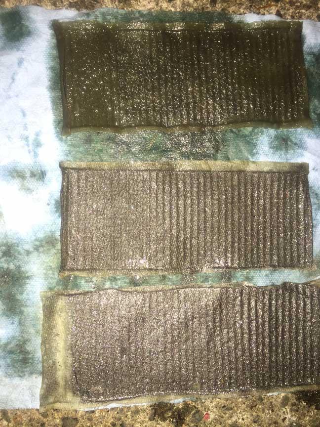

Heres pics of the pre-filter of the first flush. Second flush looked the SAME ! I get the impression that the oil is circulating pretty good!
I ran it for awhile with one axle stopped, so the diff had to "work". I think the Peloquin probably has a LOT more capacity to hold trash than a normal diff.
I'm running it mostly with both flanges spinning (diff NOT diffing), idling in 4th gear Sometimes I run it up to 75 mph and hold it for a minute or so. All the while the pump is circulating oil thru the filter. In the driveway, axles OFF, its now up to 120*F, about 60* over ambient. I suspect MOST of this heat comes from the engine contact. SOme from a tight new pinion bearing perhaps, and stirring oil.
It 'plugged up' then blew a hole thru the paper. Blew a hole in 2nd filter too.
The paper filters good. Here's oil coming out of the paper/screen - its sparkling clean.
Heres the first 3 flushes. #1 &#2 are not much different, LOTS of stuff. #3 (top) has very few shiny filings. But the paper is dark, like it's catching the very fine dust. The oil isn't dark, it's clean like honey.

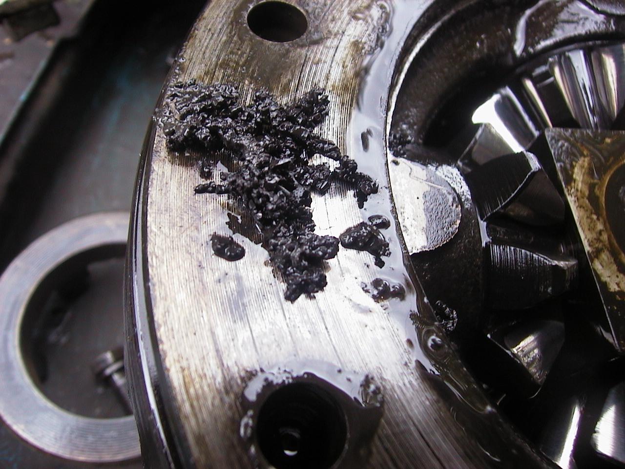

Here some pics how it looks inside a diff before cleaning.
No way to get this out without dissansambling because off the centrifugal force.
I dont know if a used peloquin looks the same.

I wouldnt say so. A box with 100k km looks simular and still can go over 100k. It is just not a proffesional (best) work.
Here a pic of my current tranny work. Diff opened 5 mins ago.
They look all the same.

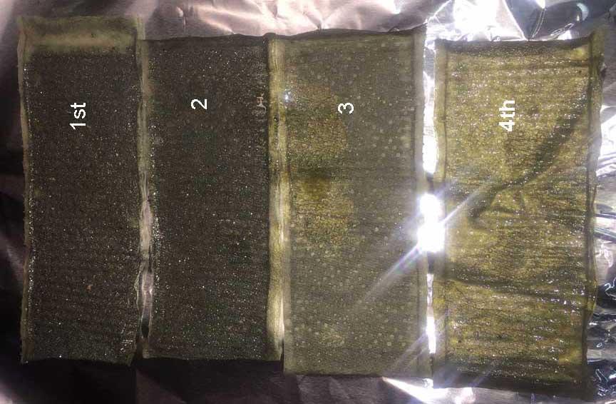

Recap: Flushing trans because it was realized the differential was not properly cleaned (of metal contaminated oil) during transaxle rebuild. Not that everybody needs to do this but the exercise illustrates what a pump and filter can do.
Here's a pic of the 4th filter. These 4 filters represent clean 15W-40 motor oil pumped thru the trans during 2 hours of van idling in 4th gear with no axles. Plus a few attempts to disturb the fluid by reverse, forcing the diff gears to differentiate, and a little bit of time revving 3600rpm in 4th gear. All with ass-end up on ramps.
4th filter has a few metal bits, but mostly clean, clear fluid. Next I'll tip the front end up and see if more stuff comes out.
