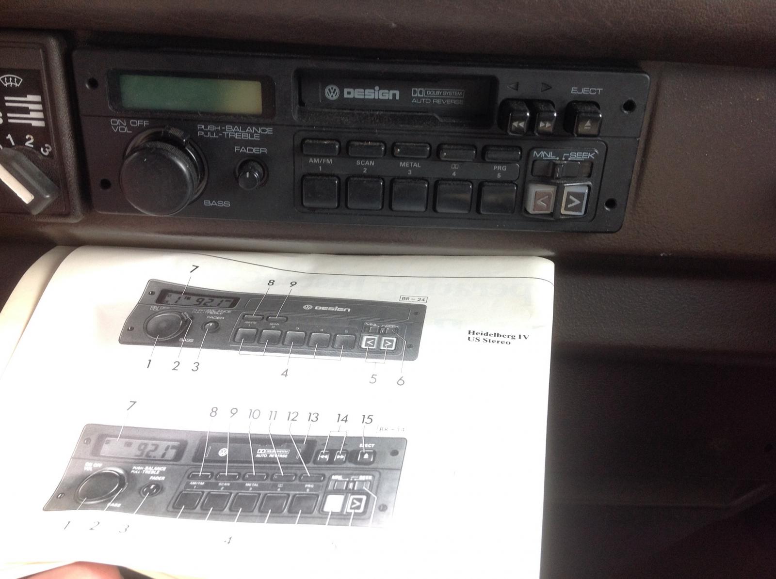

PostPosted: Sun Mar 20, 2016 4:45 pm    Post subject: Re: OEM Stereo Woes Reply with quote
My 91 has a Heidelberg unit, and it squeals when I play tapes in it, any idea what's wrong with it or how I can fix it??
Thanks!!!

Do a Google search for "cassette tape player squeal"; lots of potential repairs come up. Smile
Thanks!!!
Cassette tape transport has a lot of moving parts inside. Many of them has rubber wheels for their frictional characteristics. There is also a slip disk (typically a felt pad sliding on a nylon disk) on the takeup spindle to accommodate the viable diameter of the tape spool. The kingpin of the cassette that regulates the tape so it run at constant speed regardless of the diameters of the two tape spools (dispensing one and the collecting one) is the capstan which also has a rubber wheel. All these rubber parts don't do well over the span of two decade as the rubber continues to vulcanize, oxidize. Then there are the abuse they take form users lack of hygiene in keeping their cassette from dust and grits. In some older transport design the rubber friction wheel at the capstan does not retract when one turn the cassette off after playing. Overtime the rubber wheel ceases to be round...
You might be able to service some of these parts, clean and lubricate the bushings inside. Servicing cassette transport in a DIN size head unit is not a job for average person as the inside is jam packed with PCBs, interconnect harnesses. Often you have to unsolder something just to be able to remove it.

Me?
I'm still rocking old school OEM audio.
Music is no more than background noise when I am fighting to stay alert or my Wife dozed off.
Most of the time we watch the countryside slip by, I listen to the Van (it's always talking to me), the wife and I chat and we do at times listen to audio books for hours on end. (Most recently "A Walk in the Woods")
As long as I can hear it (I tend towards deaf) and it isn't garbled and tinny...... I'm good!
Also, I keep it because I like the look of the old radio, it belongs there.
I just cleaned out the volume knob control because of static when adjusting, works great now.
I added Bluetooth music and phone via a cassette adapter and a Knivo Bluetooth setup.
I am happy with my classic tunes.
Dave
