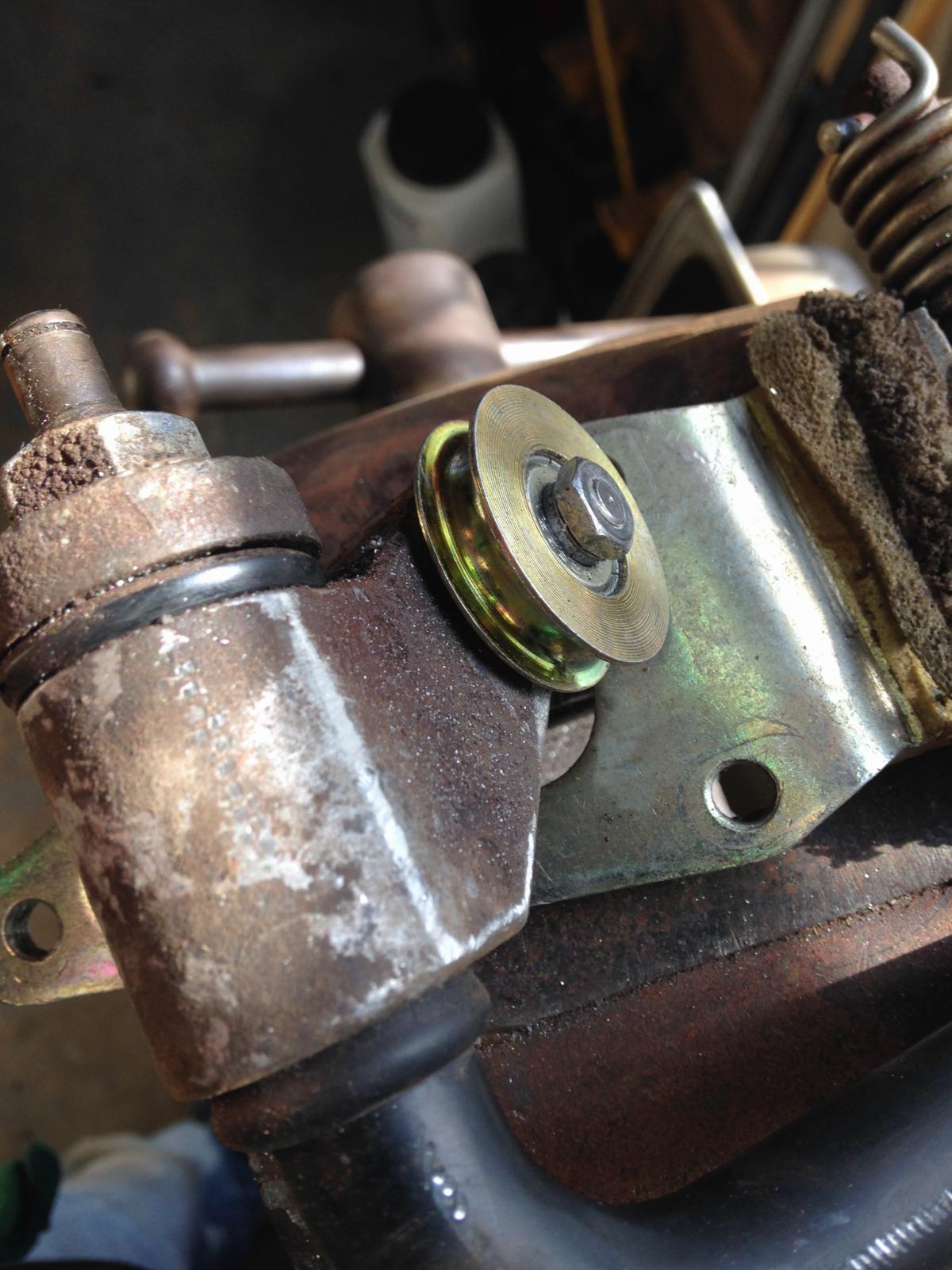

Long ago abandoned thread but the roller purchased was in the left package shown in the photo, 2 for $10 I just purchased this item this morning.
This will work in lieu of this bearing, Now a $30 part.......

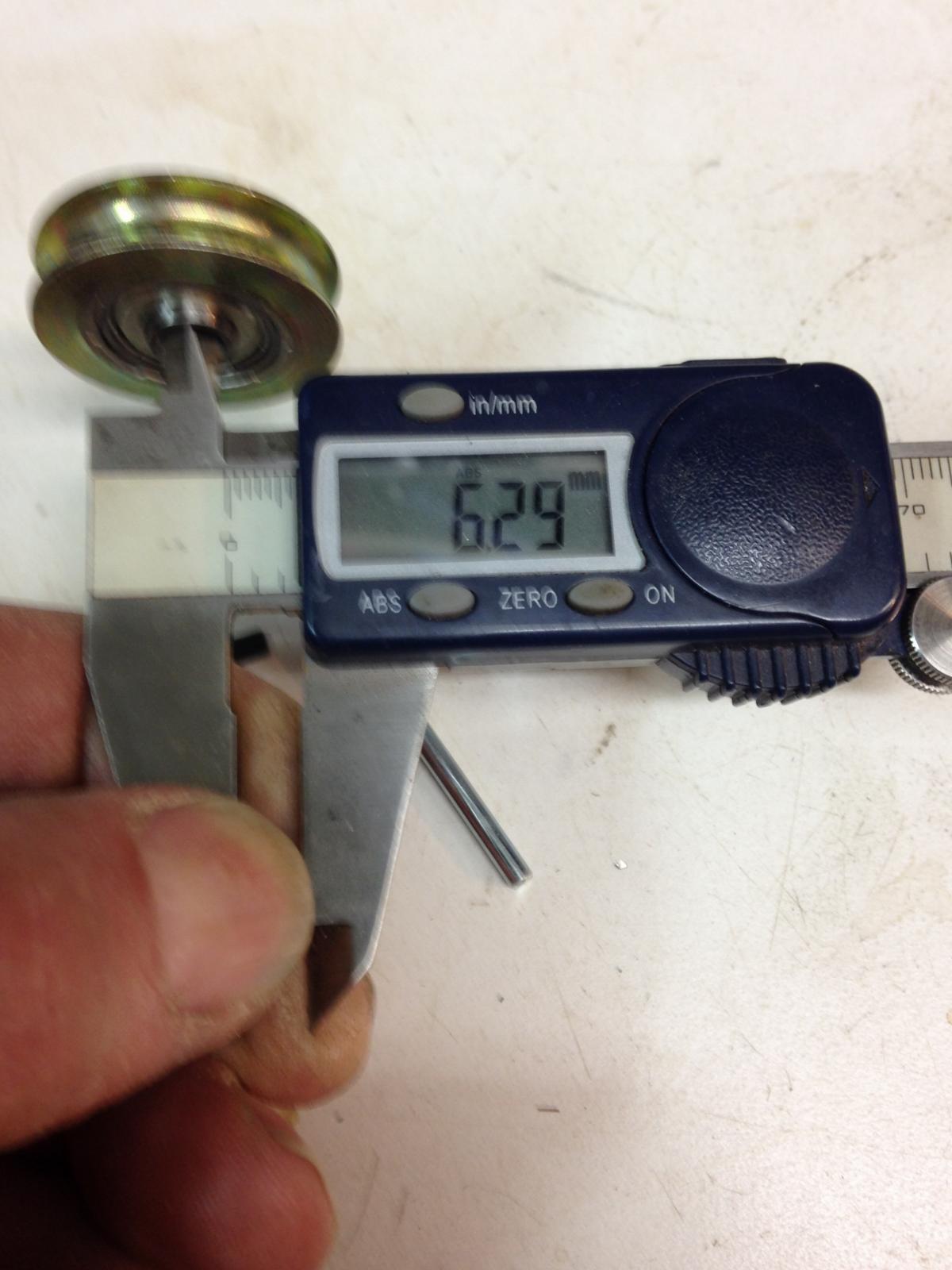

Terry, I didn't drill out the bearing....... I don't have the drill bits to do so nor the precise equipment needed.
Look at the bearing, It has the inner race protruding about a 1/16" - 1/8" on both sides.... (this photo is the enlarged bearing, look at the beauty of the inner race) Laughing
I simply got out my Dremel, which any reasonably equipped home Mr CanDo has on the bench......
I have a selection of chainsaw sharpening stones, 3 different diameters actually, I selected the larger of the three, the pretty Pink one!
I clamped the roller in to my vise with the center just above the vise top.
I then took a small screw driver and held it against the bottom of the center that protrudes the 1/8" acting as a brake to prevent run away spinning as the grinding wheel spins at an alarming rate...
The amount removed is not huge, I'm only shooting for 7mm and am starting at 6.29mm.
I did allow the center to spin as a slow controlled rate which produced a very clean and even interior grind.
YOU MUST TAKE IT SLOW!!! Do NOT overheat that center spindle!! I would do a little, let it cool, do a little, let it cool.... until I achieved my 7mm size.
It wasn't hard, it wasn't rocket science but it worked extremely well.
I will post a photo later but to get the new bearing to set in the same plane as the OG unit, I had to grind off the 1/8" center protrusion on one side. No biggie......
