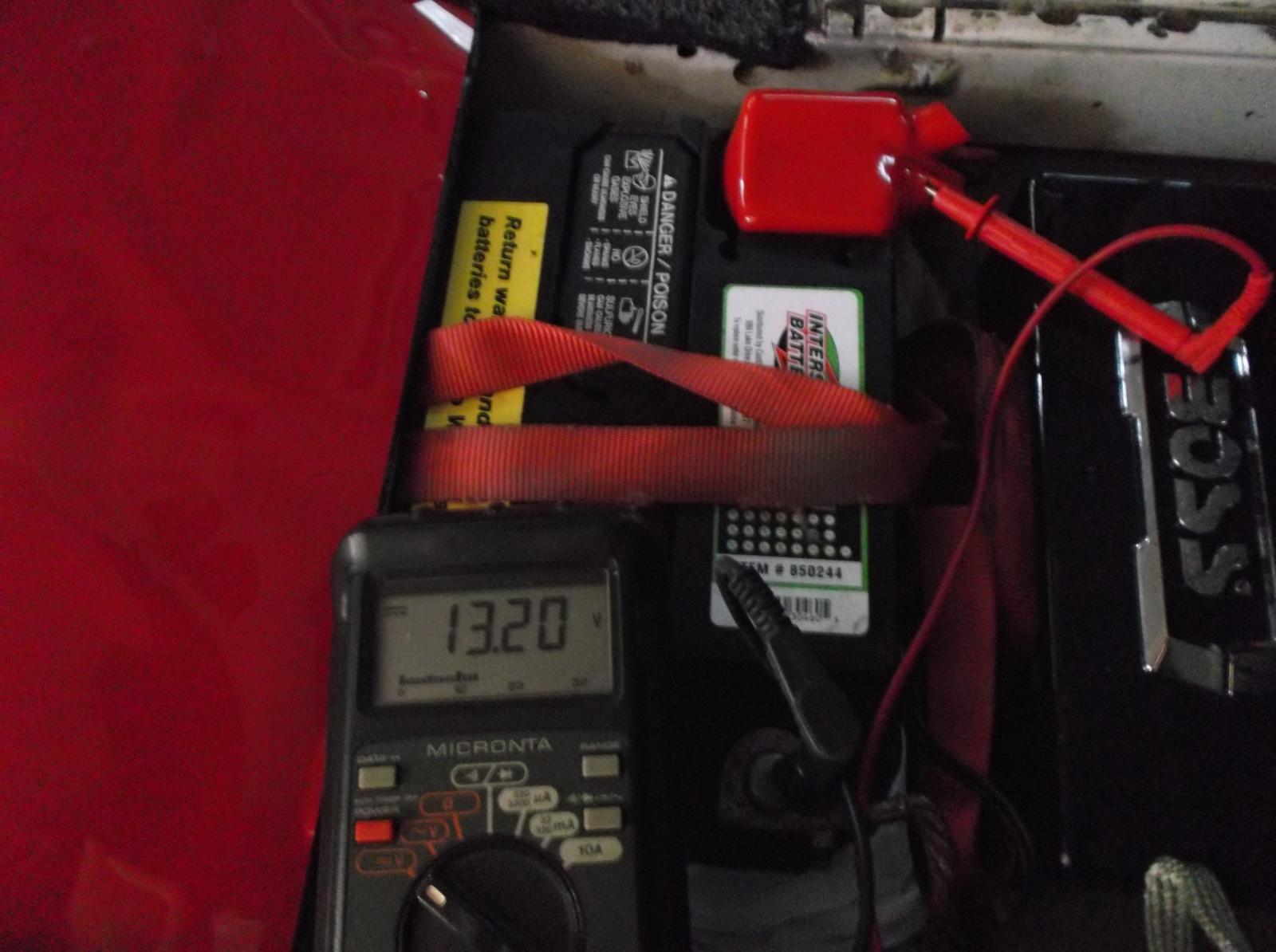

I guess mine is charging to 105% THis is a brand new group 41R battery bought at Costco for $72.00 fully charged. the first picture is with the van off, the second with it running. * note I have a 1.8T with a 90 amp alternator and brand new regulator.
14.8V is too high for normal alternator output... You must have to add water really often....

Yep, the battery had a trickle charger on it and it was just removed, the alternator voltage is high because the battery is fully charged, it is not loading it at all, I plan on keeping an eye on the new regulator but am confident after a load is applied and the battery floats down it will also drop down. 14.8 will cause some oxidization and maybe a little out gassing, 14.5 is desirable. |
one must also wonder how percise the meter is. when was it last calibrated? _________________ Help Prevent VW Engine Fires, see this link.....Engine safety wire information
