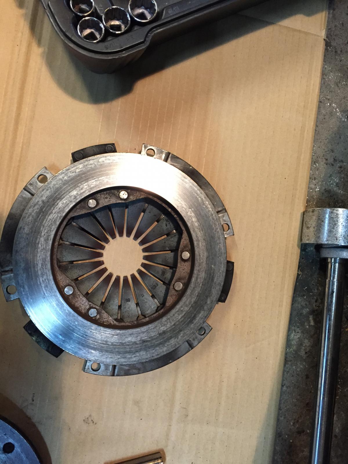

Remove the six bolts that hold the cover to the flywheel and you will find the clutch disc pinched between the cover and the flywheel.
To remove the cooling fan, you just remove the three bolts and then gently pries the fan away from the fan adapter.

PostPosted: Wed May 17, 2017 9:17 pm    Post subject: Re: Seeking advice - 1st time engine/tranny drop Reply with quote
Those are the fingers of the pressure plate, you turn the perimeter bolts
1/2 turn each to release it, the disc is sandwiched behind it.
The reason you turn the bolts 1/2 turn, criss-cross fashion, is to remove
it slowly so it does not warp the spring.
The fan looks like it should just pop off it- the outer three bolts are gone,
can't see in the photo, there is also a locating dowel & special washer under
there, don't want to misplace it.

PostPosted: Thu May 18, 2017 6:37 am    Post subject: Re: Seeking advice - 1st time engine/tranny drop Reply with quote
pressure plate looks pretty good.

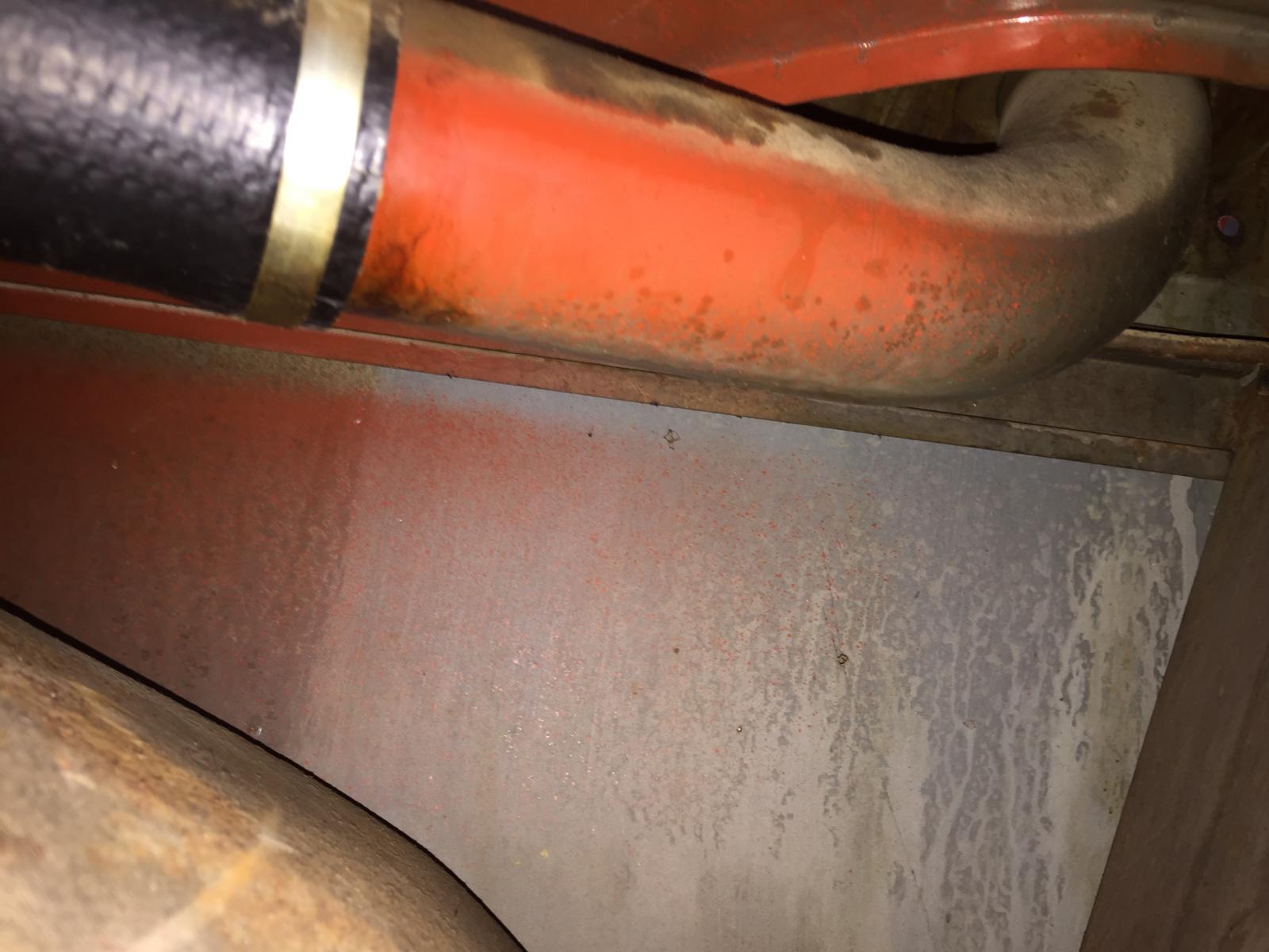

Also - am pulling the tank. I plan to replace the vapor links but they appear to be in decent shape for being there for the past 44 years.
Plus- the metal filler neck looks solid. How do I evaluate the condition of the rubber portion of the filler neck?

Replace all the rubber associated with the fuel tank while you have easy access, including the filler neck. Read up on alternatives for the ell shaped filler hose, the generic Napa hose does work as do some of the other ideas. I can pretty much guaranty you can rip the little vent hoses apart as you take them off. I know mine were totally shot 20ish years back.

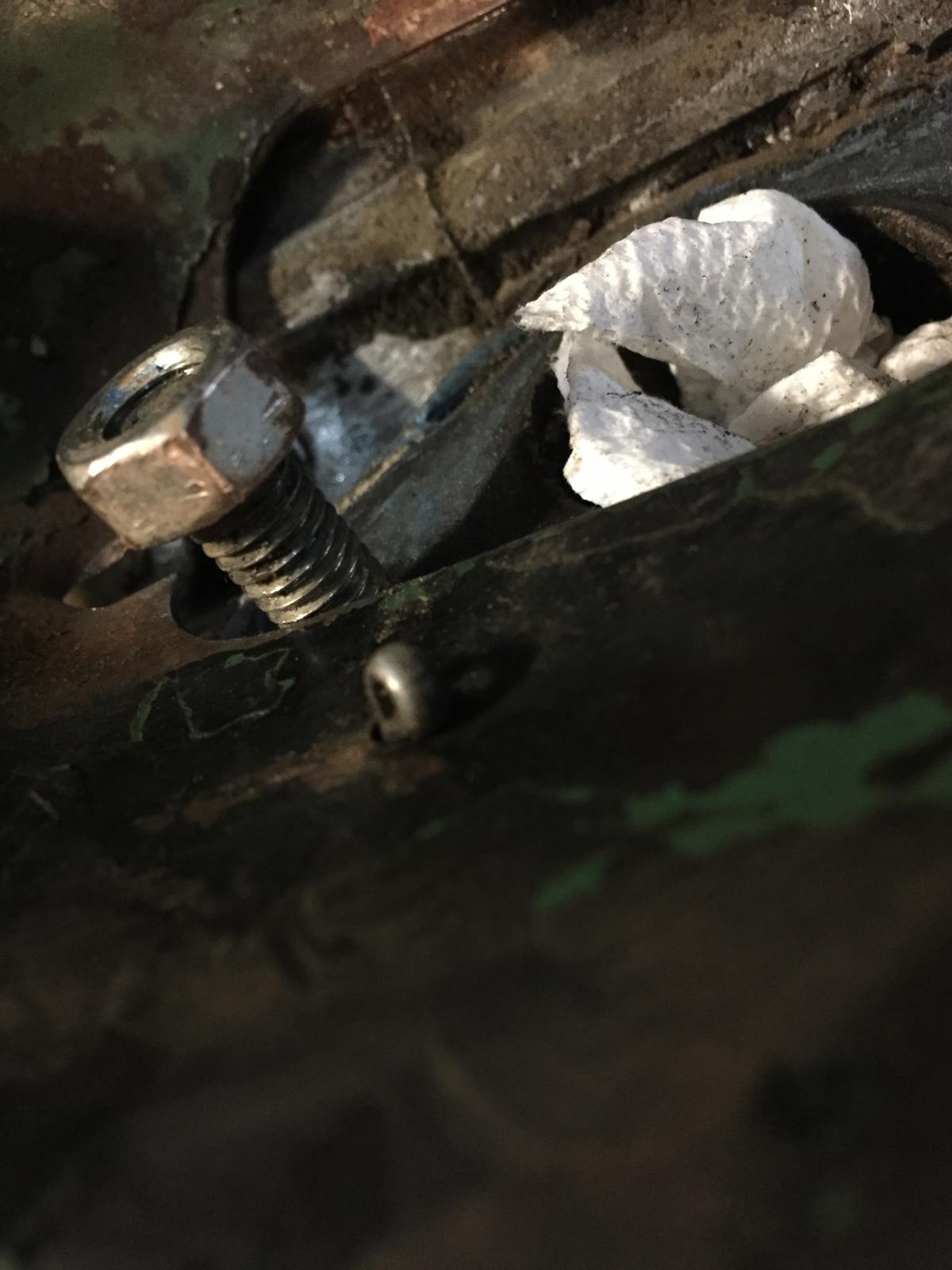

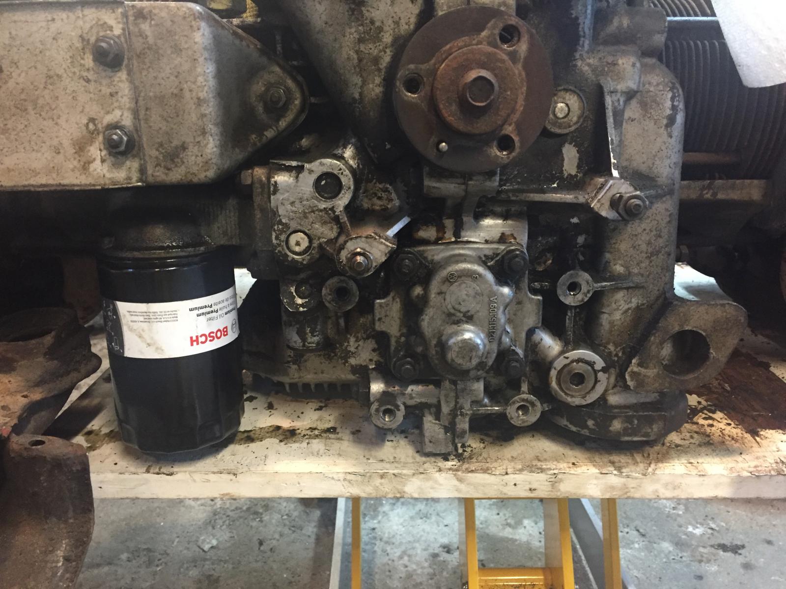

Also removed the moustache bar to get acces to the lower portion of the engine for cleaning. There was a fair amount of oil and dirt built up. I don't think any of the galley plugs are leaking but noticed that all four nuts securing the oil pump were looser than expected - I gave each a 1/4 turn.
Also, discovered two short bolts on the side of breather tower and above the dizzy that something mounts to but I have no idea what this would be.
I looked back in other photos of he engine and the mystery item was missing then as well.
What am I missing here?

You might consider replacing your engine mounts as the rubber tends to delaminate and crack with age. The one nut in your picture also looks loose.
You are just missing a couple of nuts and washers in your last picture. Those fasteners just hold the case together.

It is pretty normal for the block to be that dirty, though to have standing oil is not. I would scrape, wire brush, spray the block to clean it and try to figure out where the oil is coming from. Remove the nuts from the oil pump, clean around the studs well and then apply some silicone to the stud and surfaces where the nuts sit before replacing the nuts.

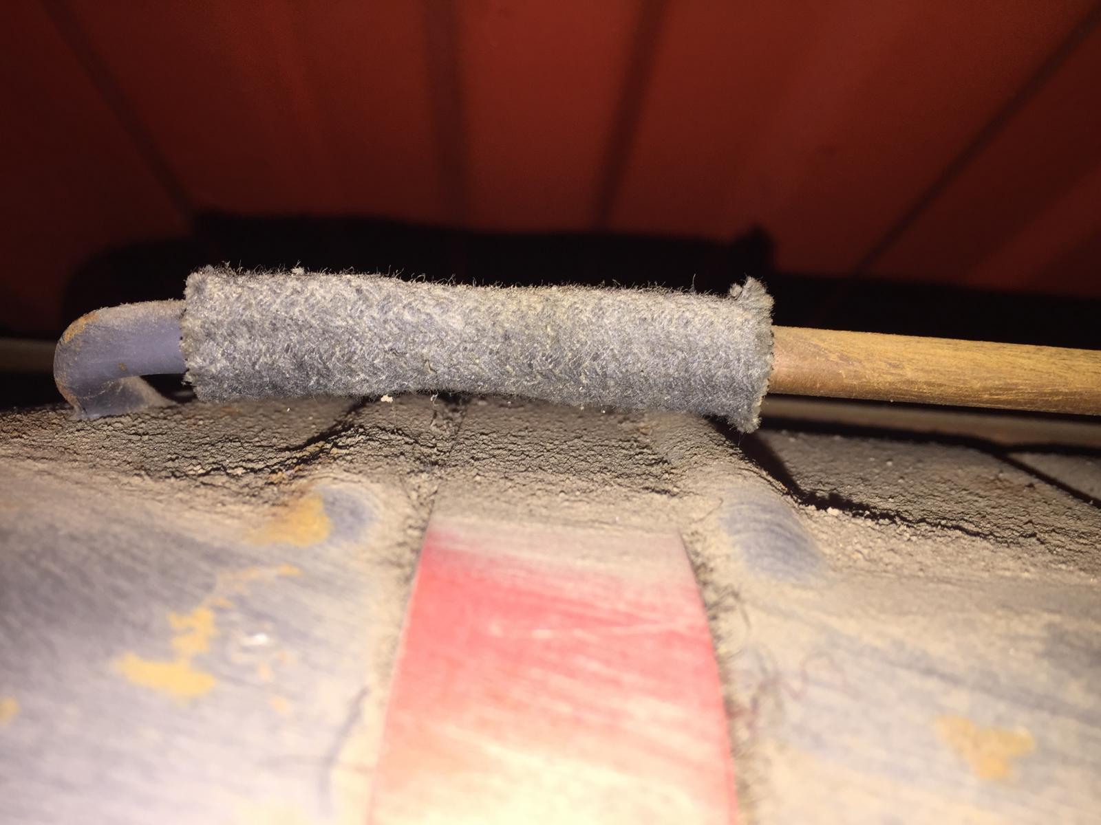

In prepping to put things back together, I discovered a small cotter pin attached to the tins that go directly above the block. What is the function of these two pins located directly above the intake manifold ports?

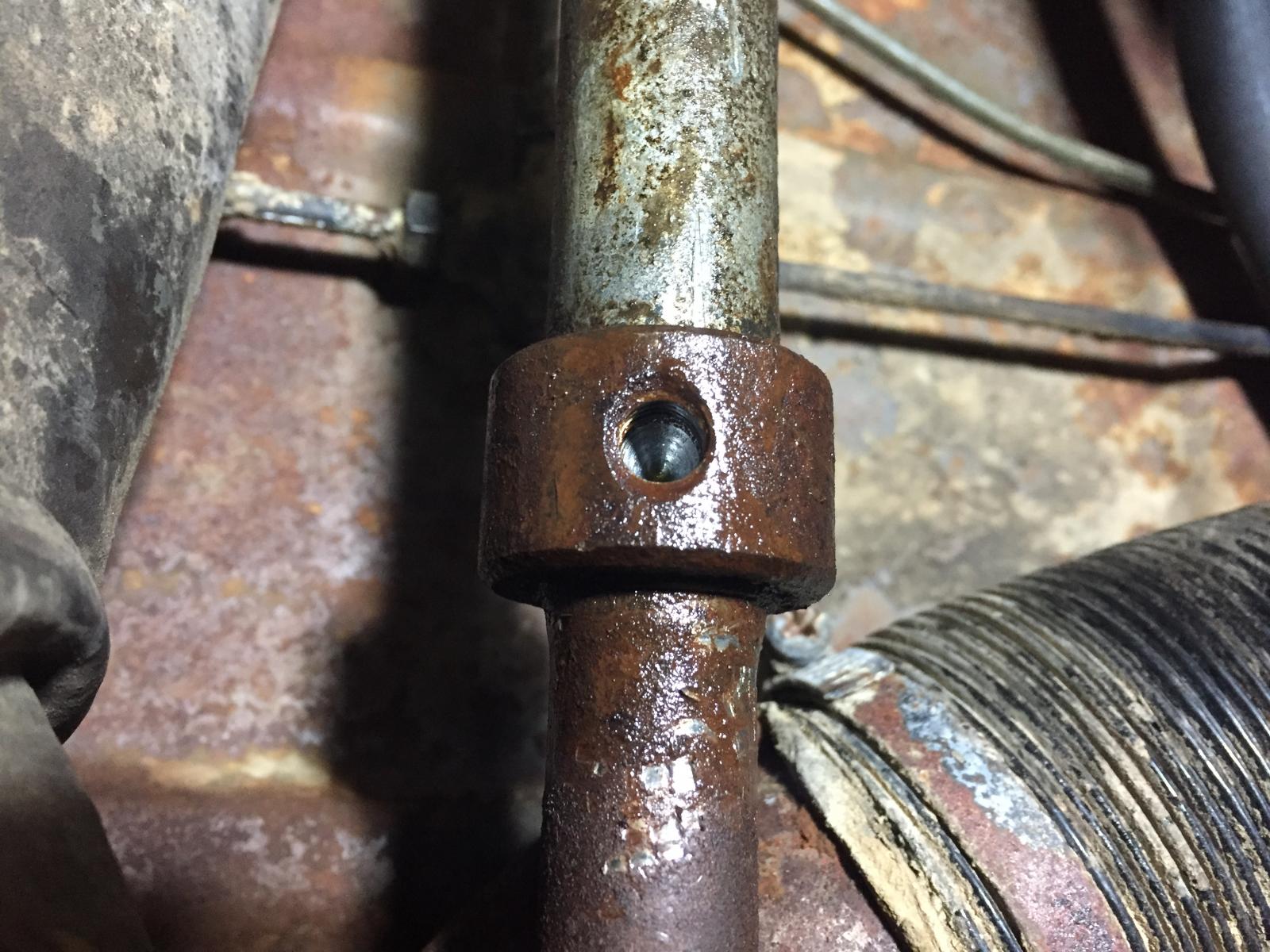

I'm posting more photos to document my work and solicit any feedback and suggestions.

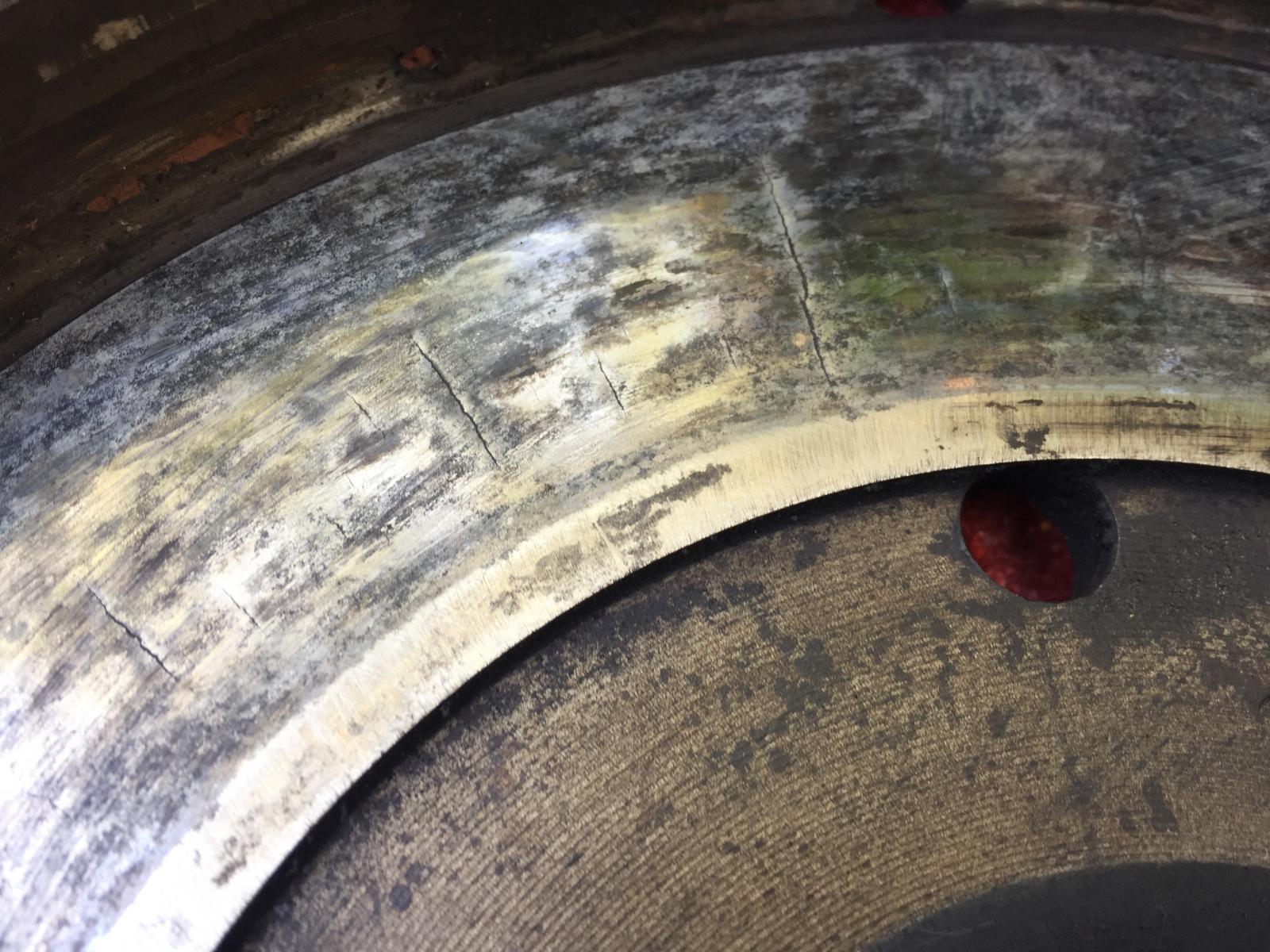

I removed the clutch plate to evaluate the parts and this is what I founnd:
I think the pressure plate has life left in it and there is plenty of depths seen near the rivits. The cover needs cleaning and possibly to be replaced.
Not sure about he fly wheel. Will remove it and have it looked at by a local machine shop to check its soundness.

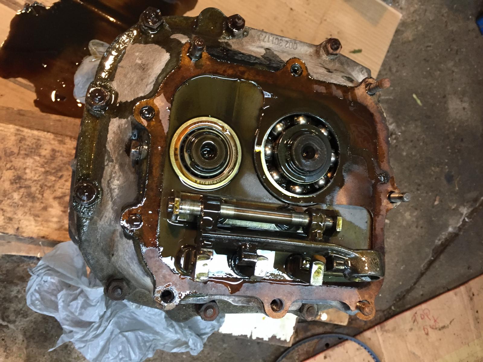

Also removed the nose cone to replace the ball and shift plate. Took the nose cone to the machine shop to get the mating surface perfectly flat per the instructions from Waddel. Being a noob, I was surprised that the gear oil came out and man, it's rank.
Do I need to remove the huge Allen Kay plug to drain and the refill?
Also, the old seal was made of paper and someone put a flywheel shim in there.
Also cleaned and painted all the tin work.
Lastly, have all new boots, gaskets for the shift rod tube but am having a hard time getting the two halves to separate. Any hints for how to do this?

PostPosted: Fri May 26, 2017 5:32 pm    Post subject: Re: Seeking advice - 1st time engine/tranny drop Reply with quote
I would replace the clutch disc no matter what, from the pictures it looks like it may have a bit of odd wear anyway. If the clutch cover and flywheel wear surfaces are fairly flat when you lay a straight edge across them they can be rerun. They will tend to get worn to a slight cone shape over time. Whether to replace any part or all of the clutch is subjective.
You can set an open end wrench or crescent wrench against the collar on the shift rod and beat on the wrench with a hammer. That should jar the two halves loose.

PostPosted: Sat May 27, 2017 1:46 am    Post subject: Re: Seeking advice - 1st time engine/tranny drop Reply with quote
My reason for wanting to replace a used clutch disc is that there are other failure modes beside just wearing out the lining. The springs can get fatigued and worn and the rivets can work loose. I almost always replace the pilot bearing whenever I have access as well.

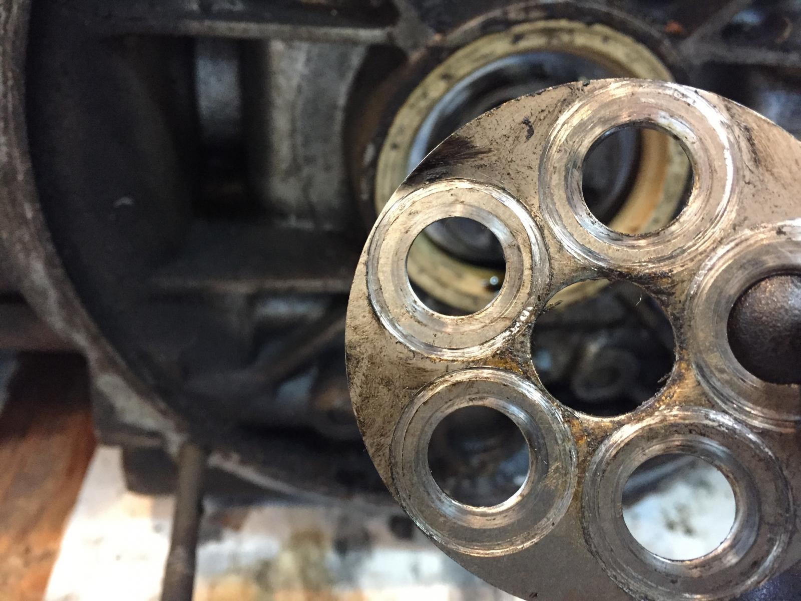

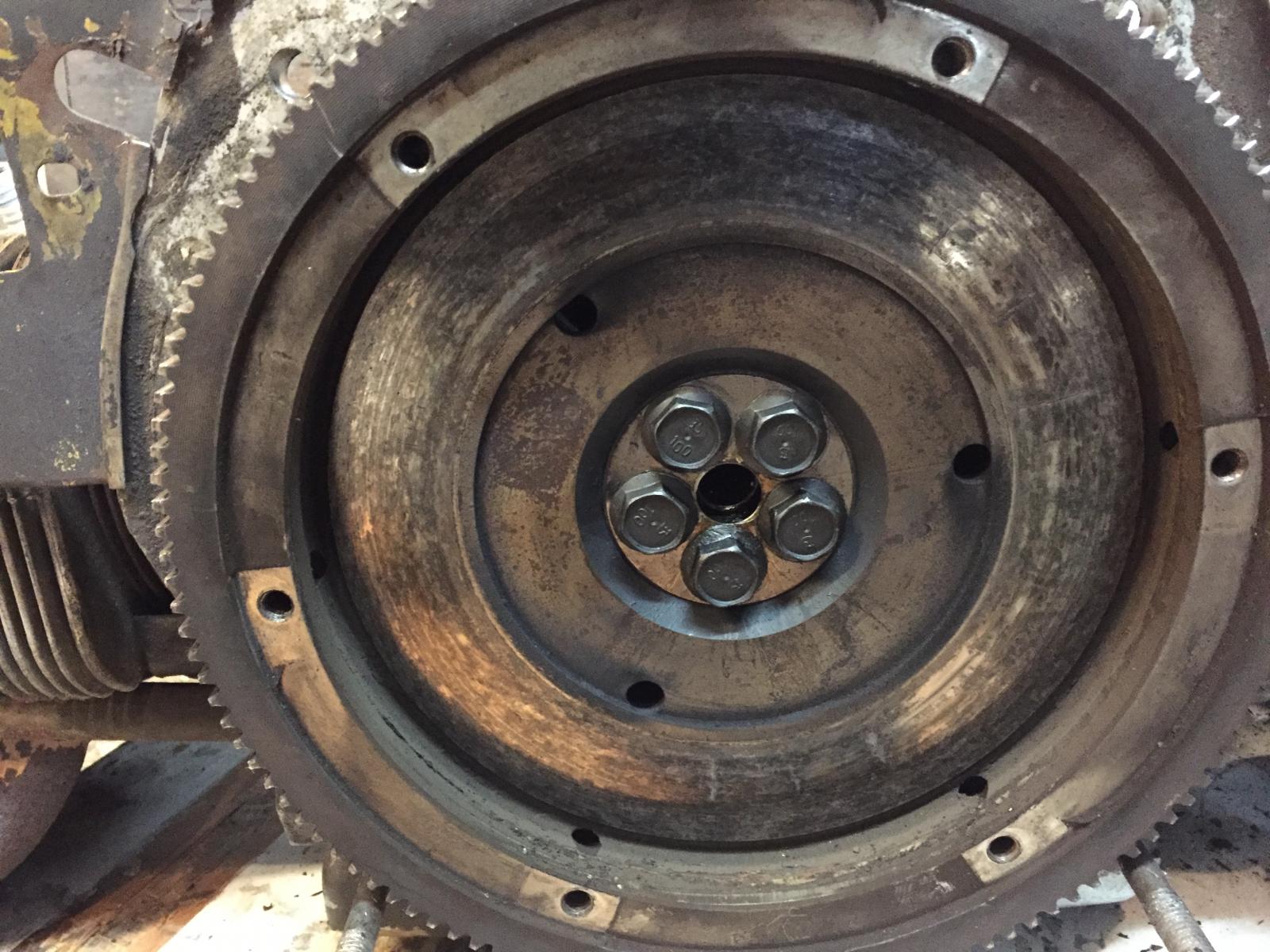

PostPosted: Mon May 29, 2017 7:43 pm    Post subject: Re: Seeking advice - 1st time engine/tranny drop Reply with quote
More work today. Removed the fly wheel and found the main seal to be leaking.
I have ordered a new one from GoWesty. The question is, how to I install this? The Bentley shows a very large and complicated tool for the 5 bolt flywheel installation. I doubt this is easily available for a guy like me.
It looks like the oil galley plugs are solid and not leaking. Should I clean up all this sludge and oil? or is this a normal state of how things look?
Also, read that I need to replace the bolt plate - I looked on the Bus Depot site but could not find this part. Where might I purchase this?
I've read that there is supposed to be a felt ring but did not see one when I removed the flywheel. Is this found behind the main seal? If I don't have one, what is a good source?
I also have a new pilot bearing to install. Being inexperienced, I check the one that's there and it is solid and all the rollers are in tact.
I've read about pulling these out but it looks like there is a special tool as well. Any advise here would be appreciated.
Lastly, I found cracks in the flywheel so have located a new one. I will have my machinist shop look this one over, but from what I have read, I think mine is not salvageable.
Thanks as always for advise and input.
