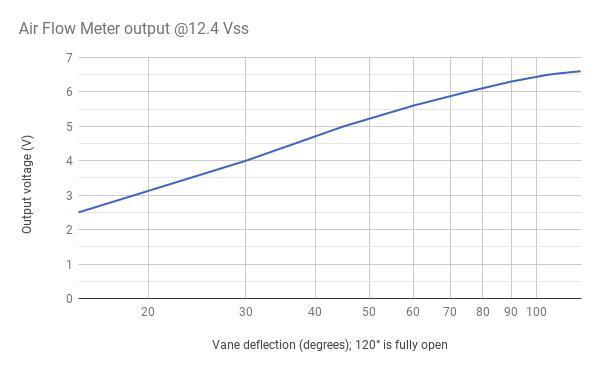

You should be measuring the AFM voltage signal to the ECU between:
- Pin 7: air flow signal
- Pin 6: ground
That should give you a curve of voltage vs. angle of deflection of flap that is not linear, but rather logarithmic(-ish), as is the relationship between air flow and applied force to deflect the vane. I did this measurement a while ago on a non-bus AFM, but if I'm not mistaken, the voltage range and variation is similar, if not the same. The power supply voltage was 12.4 V.
Notice the dead zone at the start of the track, where the voltage does not change until the fuel pump contact has been opened.
Here's the curve:
Same, with logarithmic axis for the vane deflection angle (i.e. force exerted by air flowing):

I've measured the voltage between PIN 6 and 7
It seems that the AFM is OK.
Any other thoughts?? Thanks

Yeah, looks ok rangewise. The only thing I noticed in the video is when the multimeter goes to "OL", but I think it's just it switching ranges in the auto mode. What do the resistor track look like? Is it particularly worn on a given spot?
Does the distributor advance (both centrifugal and vacuum) work?
