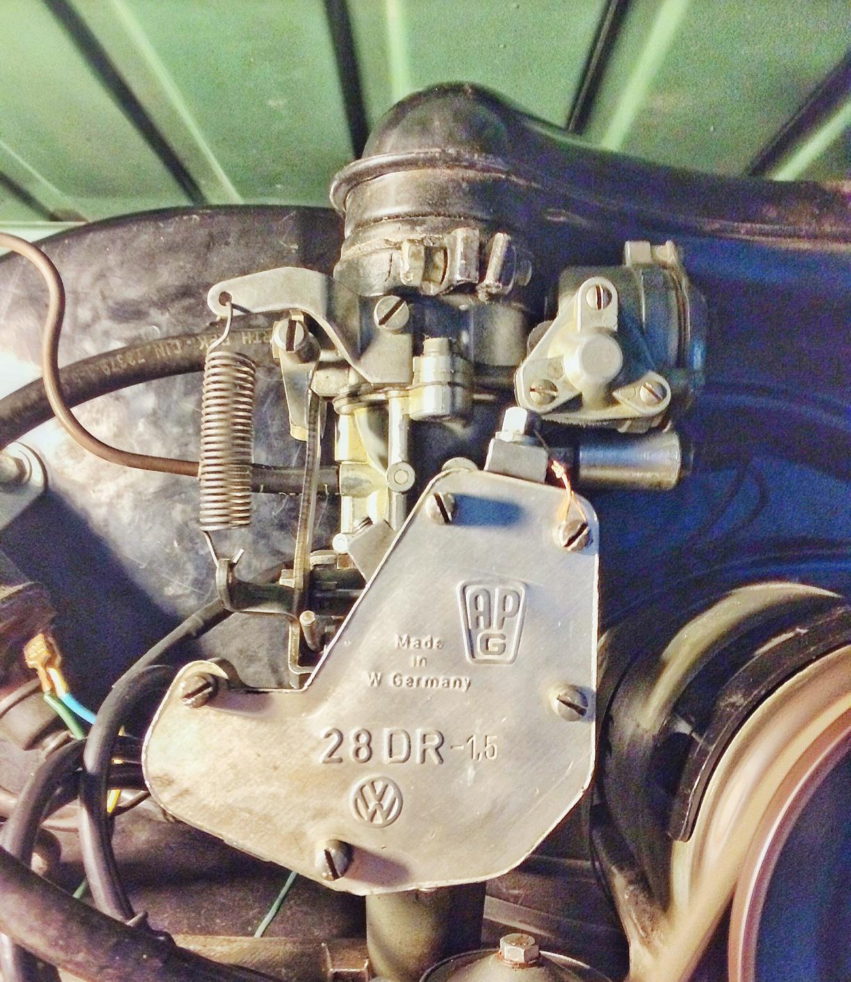

I´ve restored my governor in a 1500SP engine. the K screw is not tight to keep the intake clap as open as possible. I don´t know if it´s right.
So, at slow motion (no foot in the pedal) the RPM aren´t stable. It goes up and down (800-100-800-...) all the time.
Does anybody have the same problem? Is it right? Vac leak maybe?
It has no seal or loctitte in the front top, is it right?
I´ve read the hole thread and there´s a great info here. Congrats!!
Thank you very much!!
tasb
The Distributor Distributor
Joined: April 27, 2002
Posts: 6725
Location: Pentwater, Michigan
tasb is offline
PostPosted: Sat Feb 04, 2017 5:13 am    Post subject: Re: Yee Haw, got my governor working/adjusted! *Video!* Reply with quote
Hi back attcha, Smile Welcome to The Samba! the picture on the left doesn't look right. the tension spring does not appear to be attached to anything. It does sound like you have a vacuum leak. Try sealing the cover to the housing as originally done.

The left pic is before i restored it! The left one is how it is now...
I'll try to seal the front cover.
Thank you tasb!!

In the first pic you can see how i´ve put the K screw. It´s not tight to keep the intake clap as open as possible.
I don´t know if it´s right or not.
That´s my question.
Thank you Everett!
tasb
Posts: 6725
tasb is offline
PostPosted: Sun Feb 05, 2017 2:00 pm    Post subject: Re: Yee Haw, got my governor working/adjusted! *Video!* Reply with quote
If you increase the tension on the top main spring the butterfly (flapper) will not close as quickly. There's also and adjustment screw missing from the bottom that will keep the arm from coming down fully. Sounds like you are trying to install the governor but not have it do any work? That's common now a days and better than just curtting/removing the butterfly which destroys the governor.
