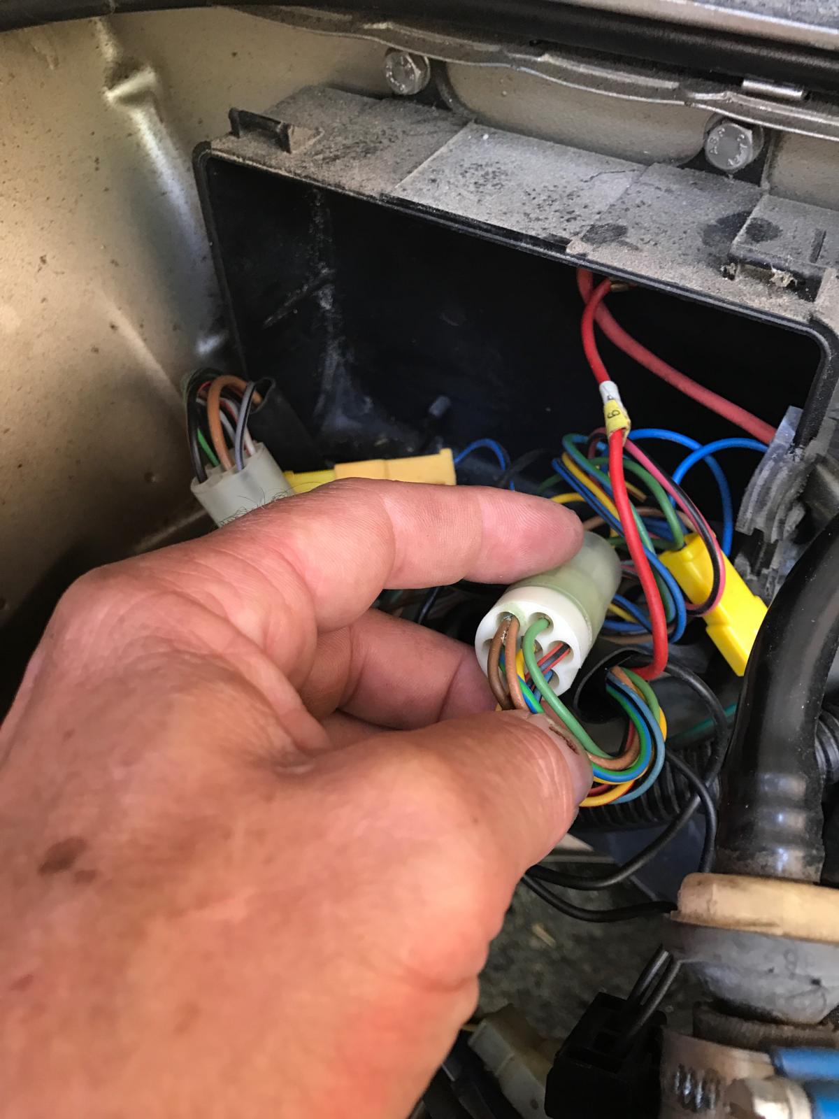

PostPosted: Tue Sep 05, 2017 2:09 pm    Post subject: Re: Ground Locations - 2.1L Reply with quote
Another possible bad ground point us in the "Distributor Box" on the LF of the engine compartment.
Connectors 7/ Connector (lights) and 7a/ (gauges) both have ground connections.
Here is a photo of my 7a/ connector. This set of grounds serve the coolant level light and temperature gauge sender.
