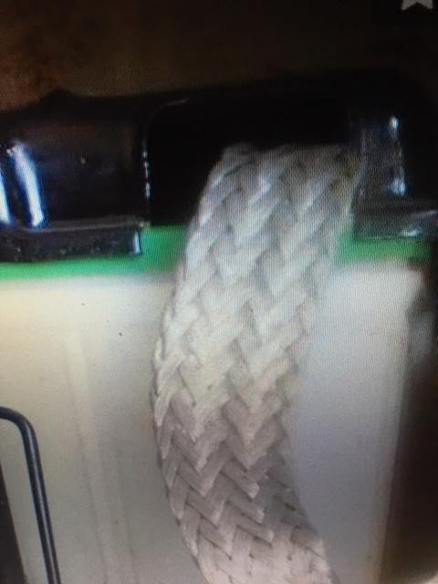

PostPosted: Fri Aug 24, 2018 7:09 am    Post subject: Re: Battery strap too short. Reply with quote
Not in a Bus but since I was driving the car off-road, the original clamp was not enough to keep the battery in place so I made a bracket to secure it out of a section of angle iron & threaded rod.

Battery choice may the problem.
I googled the battery in TDCTDI's picture above. Walmart's website says it's 8.9 inches high and 6.9 wide (226mm x 175mm).
I'm using a Bosch S3 065 battery that is 175mm high x 175mm wide.
A strap would need to be 100mm longer (about 4 inches) to go up and over TDCTDI's battery than the Bosch.

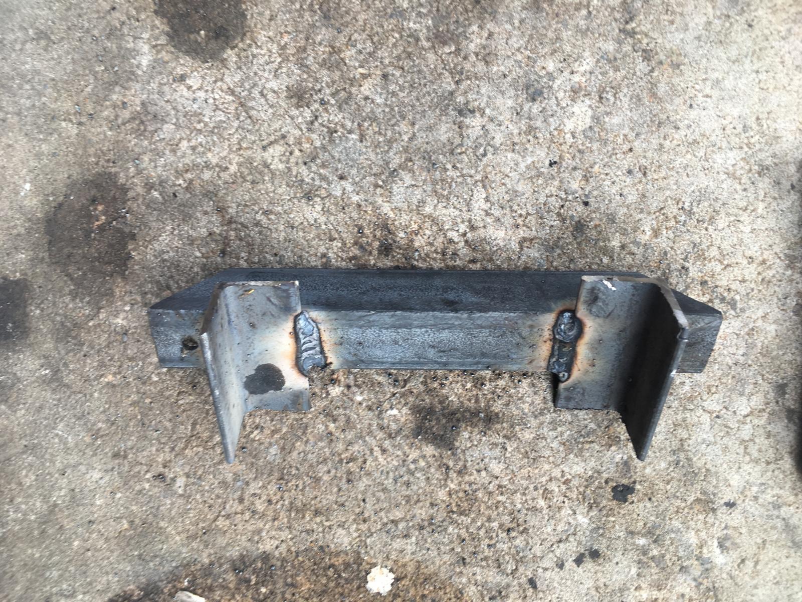

PostPosted: Mon Sep 03, 2018 8:26 pm    Post subject: Re: Battery strap too short. Reply with quote
Linda, here is my setup in my '66 bus converted to 12 volt. Tall battery like a 6 volt but it is a 12 volt with cutouts in the battery cover.

PostPosted: Tue Sep 04, 2018 9:05 am    Post subject: Re: Battery strap too short. Reply with quote
Linda, here is a picture of my 12V Interstate battery shaped like a 6V from an old thread and other ideas.
https://www.thesamba.com/vw/forum/viewtopic.php?p=8167955&highlight=#8167955
