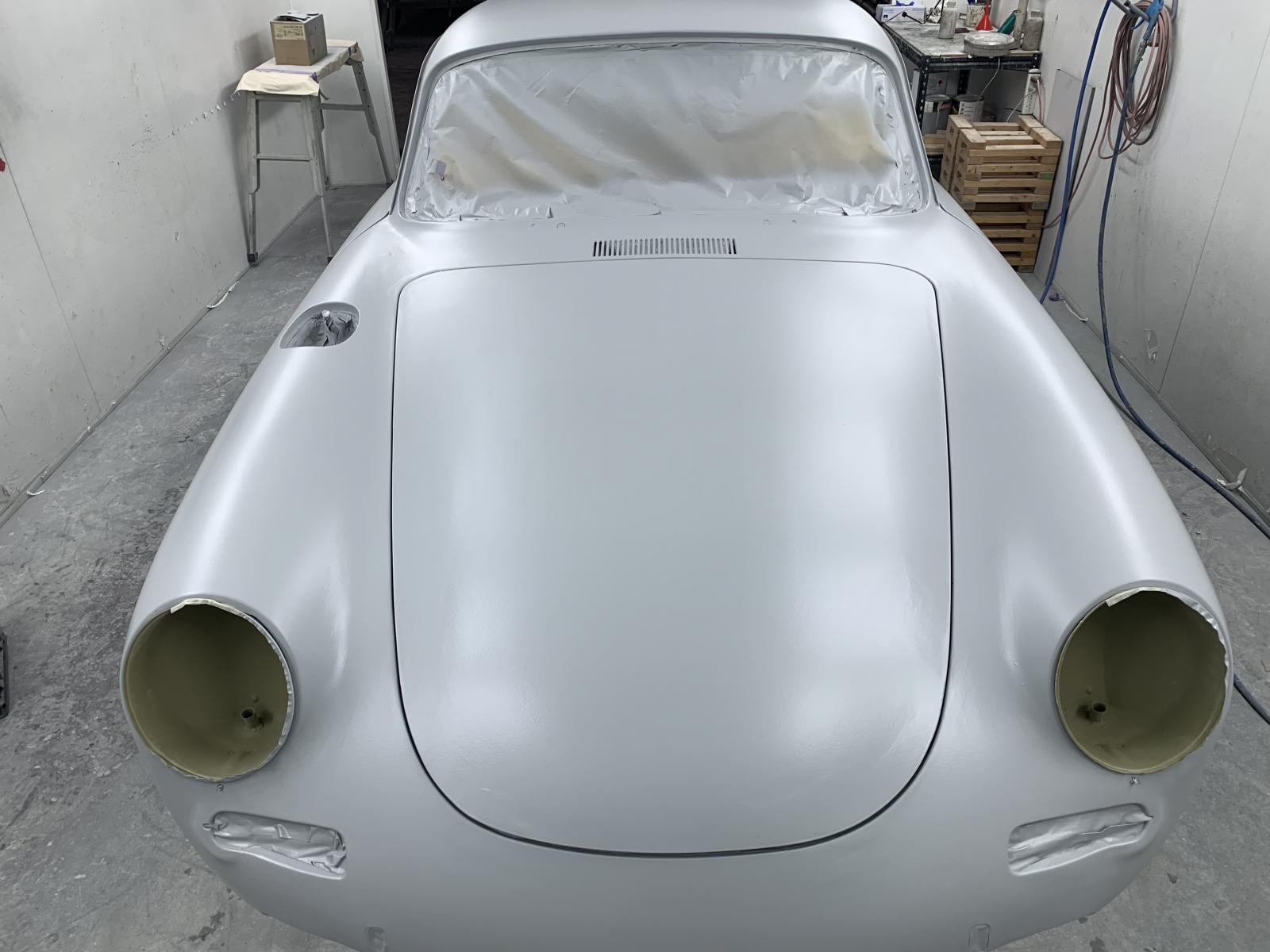

There has been more physical effort on the 356. There’s no doubt sanding is physical. There’s been another layer of epoxy sprayed on the vehicle...
Then the first coat of polyester.
More sanding to come with epoxy to create the water seal then more polyester then more epoxy to keep the water seal. Soon paint. Oh so exciting. Laughing

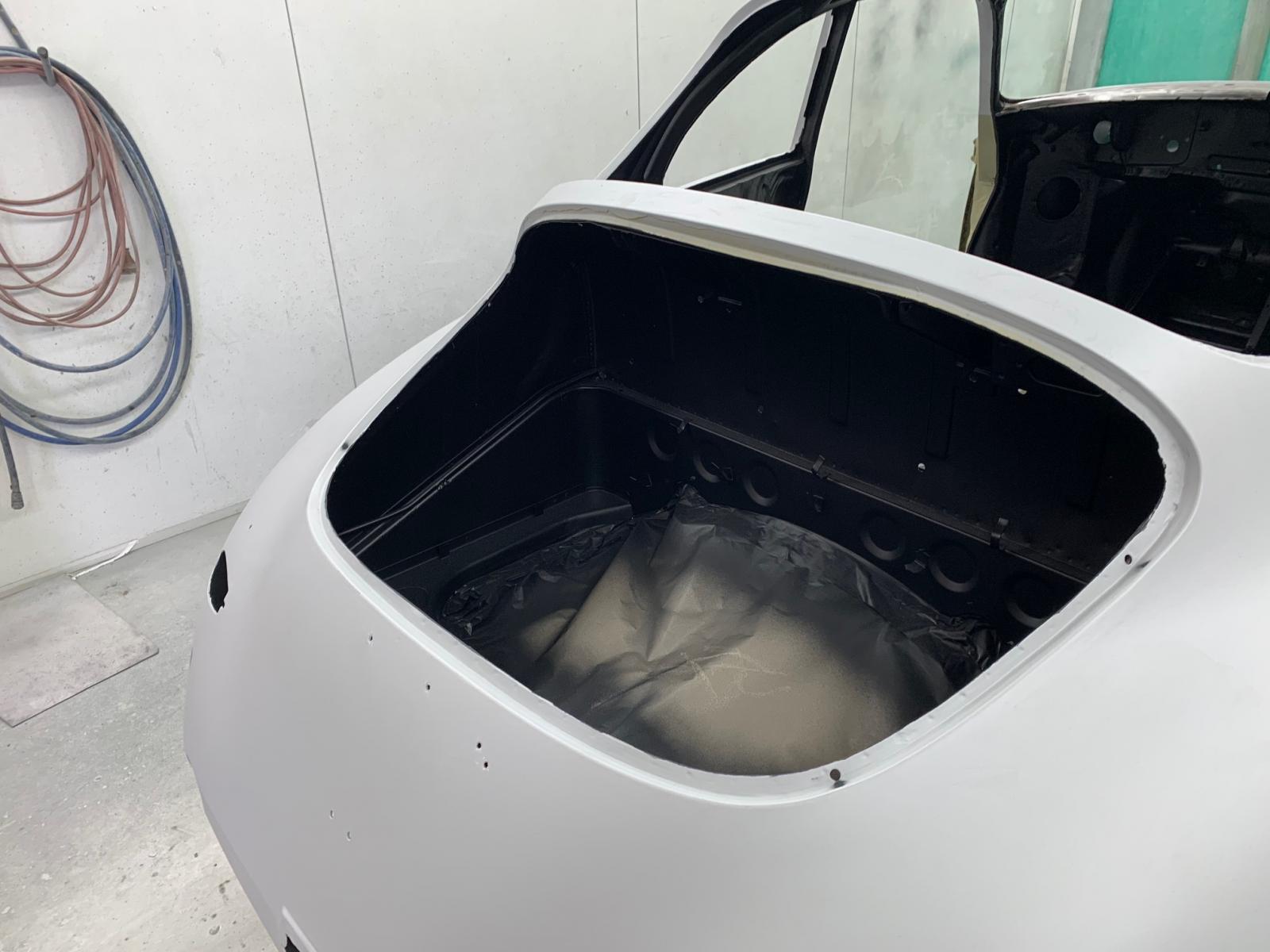

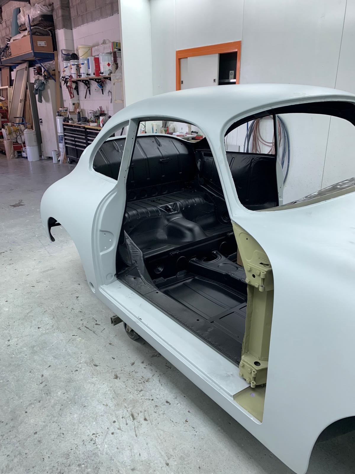

This week the interior section were prepared and then coated with that black epoxy stuff.
The front trunk...
the engine compartment...
The passenger compartment front...
the passenger compartment rear....
Soon the dash will go in...

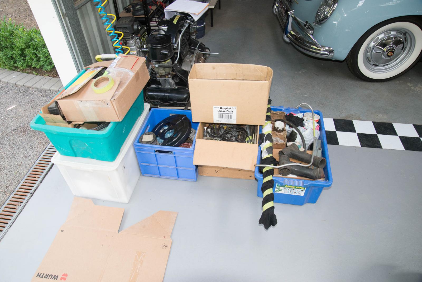

I've driven the Passat down from Sydney to Melbourne and visited Peter Hardt the proprietor of Hardt Classics. http://www.hardtclassics.com.au.
Peter has kindly been storing some of the parts for the 356C. the relationship started with the previous owner, who is a regular client and carried over this year after I took it on. I had expected to be here earlier but life has its way of getting in the way.
Peter has jigs and set-ups for the RHD conversion of the pedal cluster, handbrake, steering box and fuel tank. These bits we've fished out from the pile and he will complete them soon, hopefully by Christmas.
I had a really fun couple of days re-boxing the parts and getting Peter to help Identify certain parts for me. I'm no 356 expert but he's put me onto a few reference books that will clue me in on how this puzzle goes together. I particularly enjoyed seeing some of the cars in the work shop. There was an "A" coupe, a "B" cabriolet, and an "A" speedster all completed at one end. In the middle there is an original race vehicle that driven to win major races in Europe during the early 60's, so apparently its worth million$. Peter is also working on a few special replica Porsche race cars that only exist now as drawings. The original vehicles having been destroyed after the racing campaigns of the day. At the back of the work shop a GT and 911 as body shells being meticulously restored. All fabulous stuff and I enjoyed myself immensely.
Now about my project...Here is the engine ready to be lifted into the Passat for the ride to Sydney. It's had kits though the carb, fuel pump and had other maintenance done to have it in a running state. It just needs the front & rear tinwork, the exhaust, heater boxes, muffler and outlet pipes added to be complete.... that and a fill up of oil and other minor tweaks.
These boxes contain the brake callipers and front discs, front suspension, rear suspension the bumper overriders and a hug lot of other things. I'm amazed at how densely packed I've managed to get this!. There are a few missing things like the rear mirror and some of the air controls but I'm not too worried yet. I will find something out there either old or repro. I found two ashtrays, one with and one without the slotted plate. Its the same piece in the Karmann and I have a spare plate with that!
The Gearbox below is ready to go into the car. It has had seals and bearings replaced and the axle tubes repainted and installed. The brake discs are mounted with new outer bearings.
Finally this pile is the seats, headliner, bits of upholstery. Much need to be re-done but will serve are reference for replacements

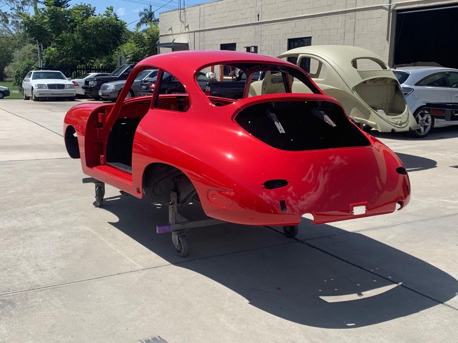

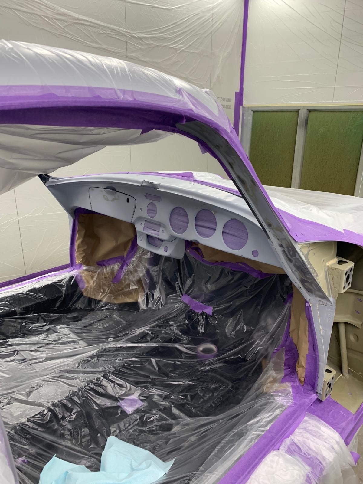

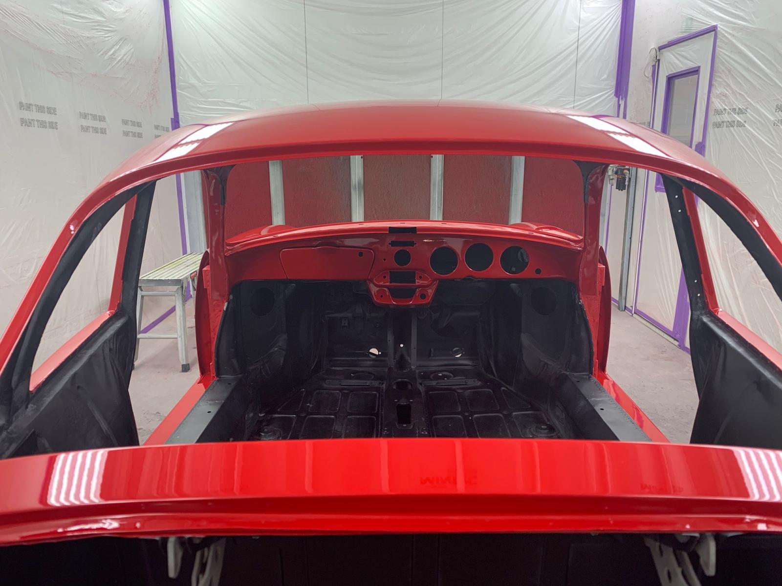

It has been a while but recently the Dash was installed and finished, Aerial hole drilled, Sill moulding holes drilled, Bonnet emblem holes drilled.....
Then we applied paint!!
Then we wheeled it out into the sunshine to enjoy it.
Ain't fresh paint something!
