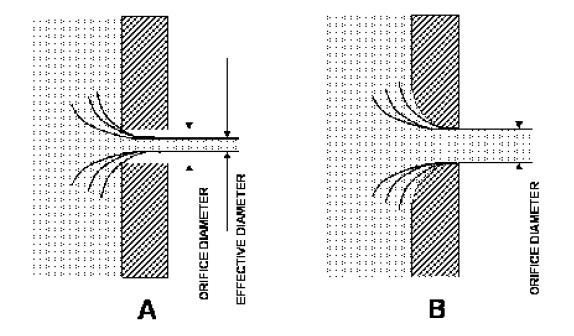

If anybody installed a drilled hole in plug restrictor replacement and isn't relying (or know) bearing hole size... consider chamfering (countersink drilling with a couple bigger size drills) the pressure side of the plug.
If it's sharp edged... less oil may be going through the hole. Example "A".
