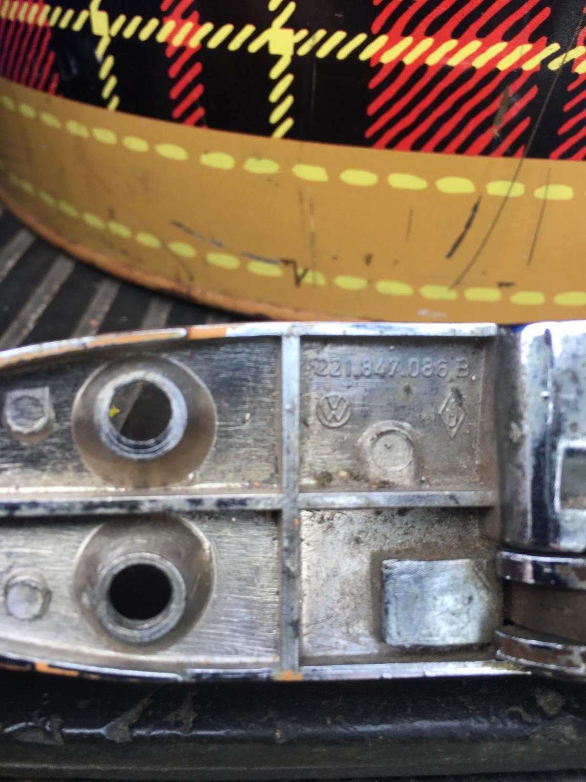

I finally found the window latch for my bus. My friend Lance was able to hook me up with this “split bus unobtaninum”. I’ve owned my bus for 13 years and I’ve never been able to find one. I just need to clean it up, make the metal piece that attaches to the window, and buy a piece of glass. I’m really excited to have this piece.

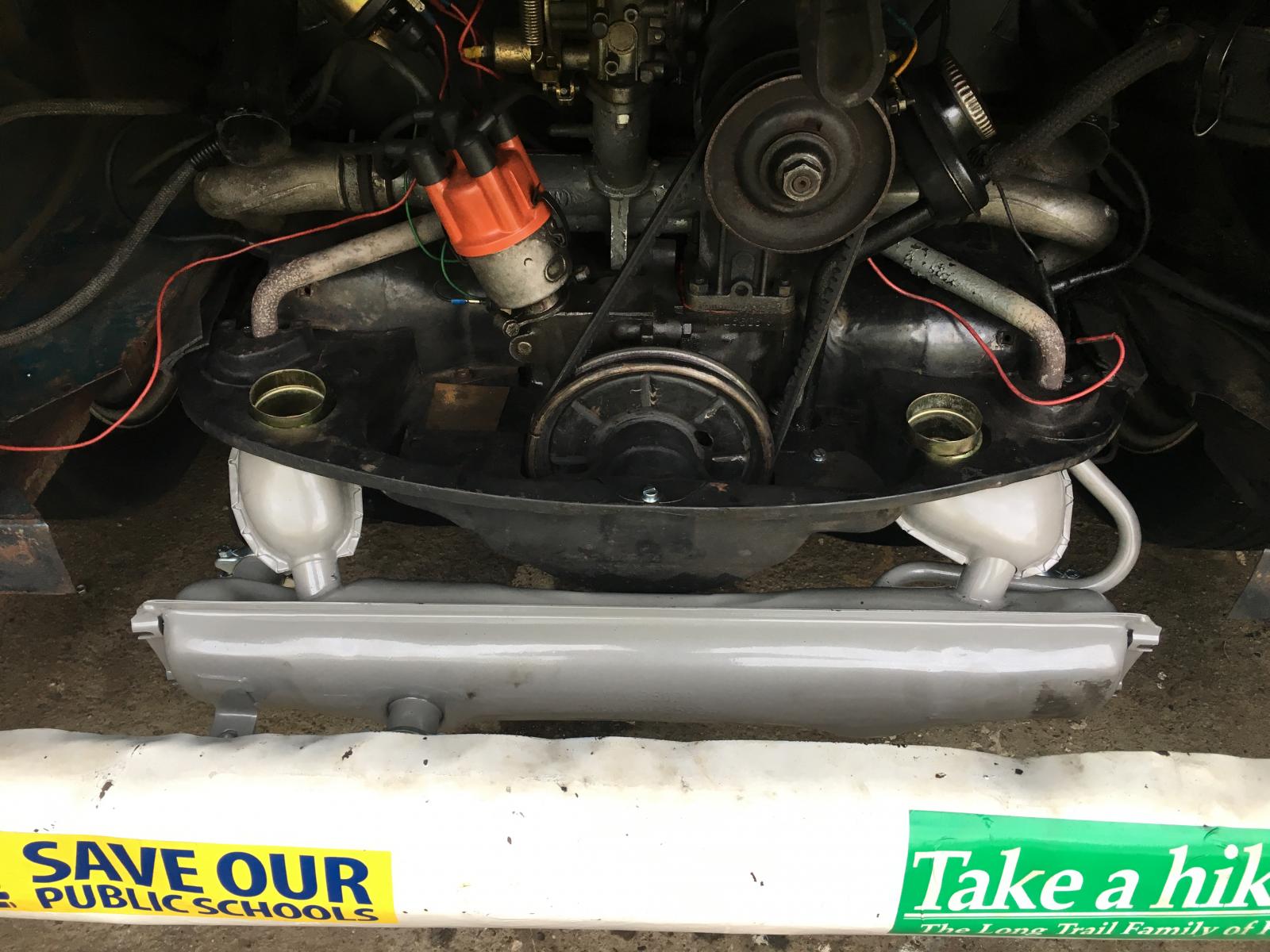

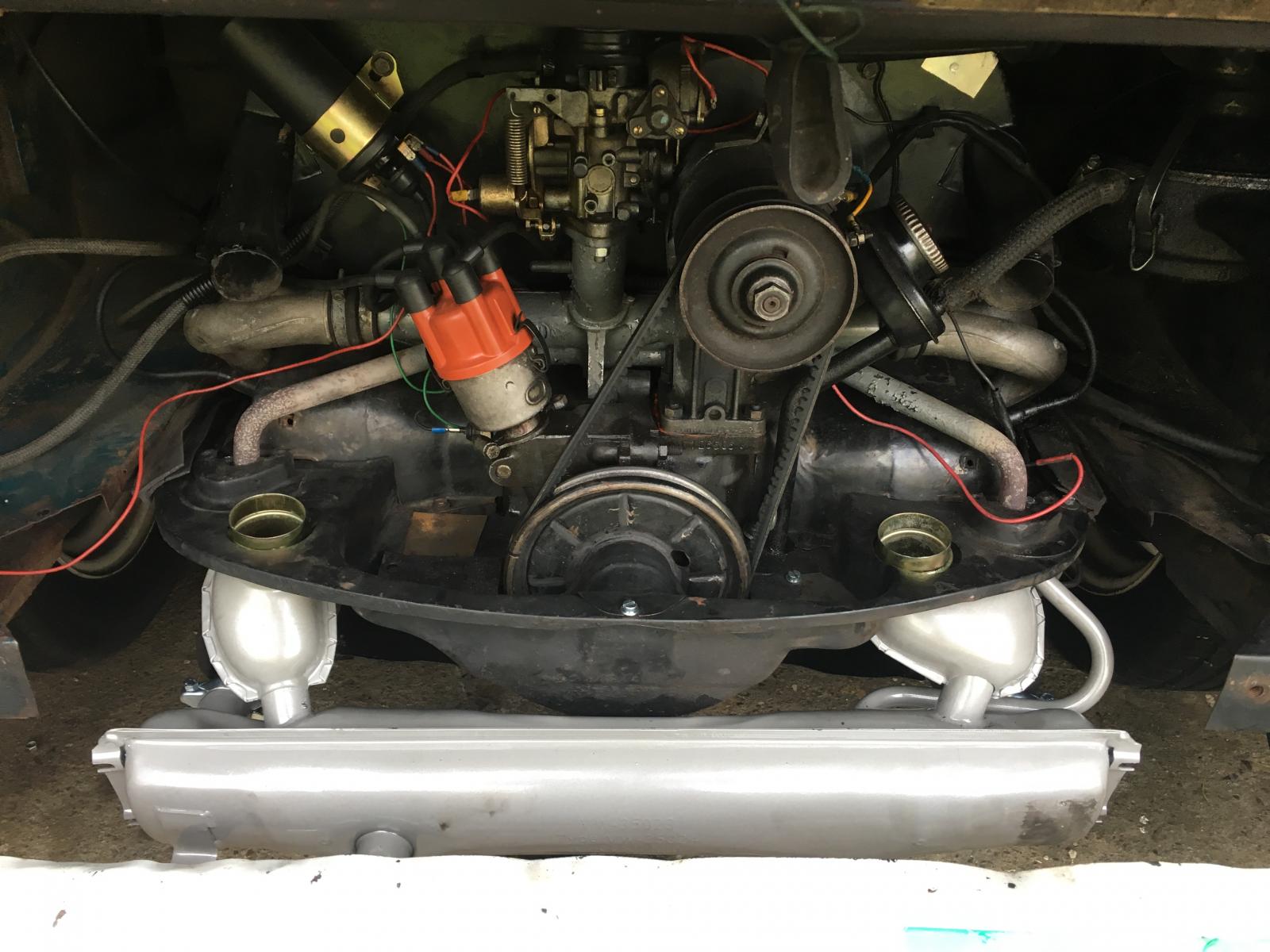

This spring I finally ditched the merged header system for a stock exhaust. It is so much better. Quiet, runs cooler, and no leaks.
Also fixed my rear bumper. The passenger side over rider had stripped out so I welded a new bracket on.
Enjoying the spring.

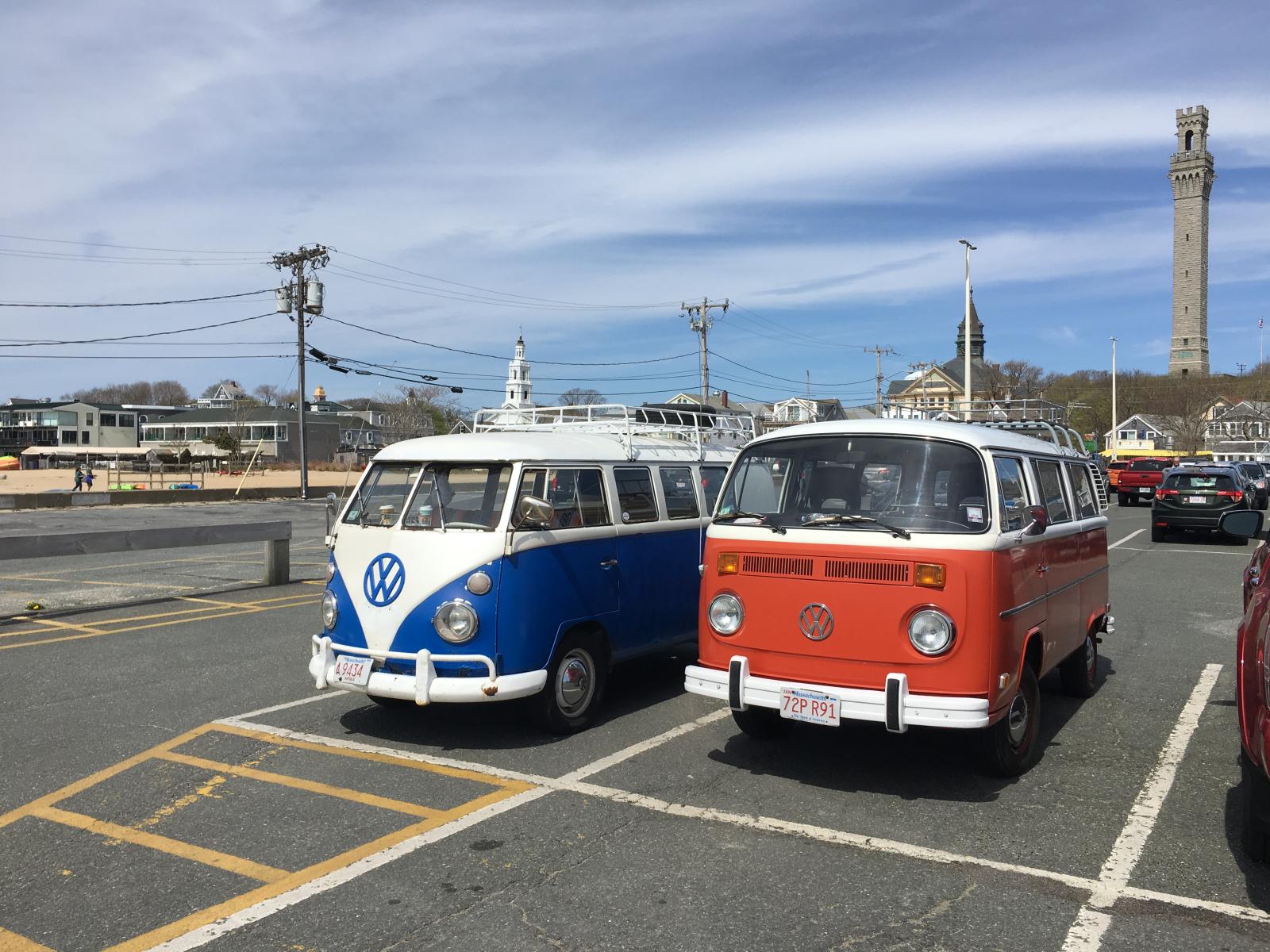

Driving over the Cape Cod Canal on the way to my brothers wedding:

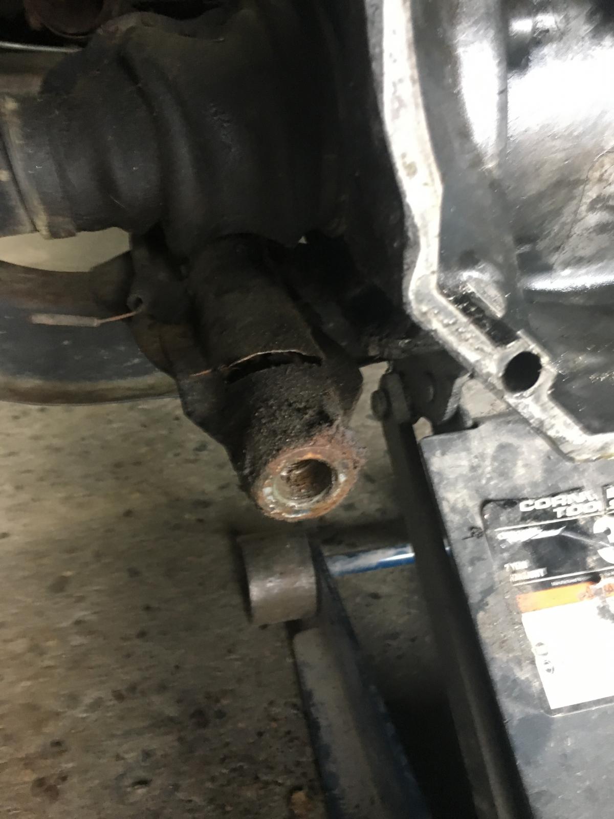

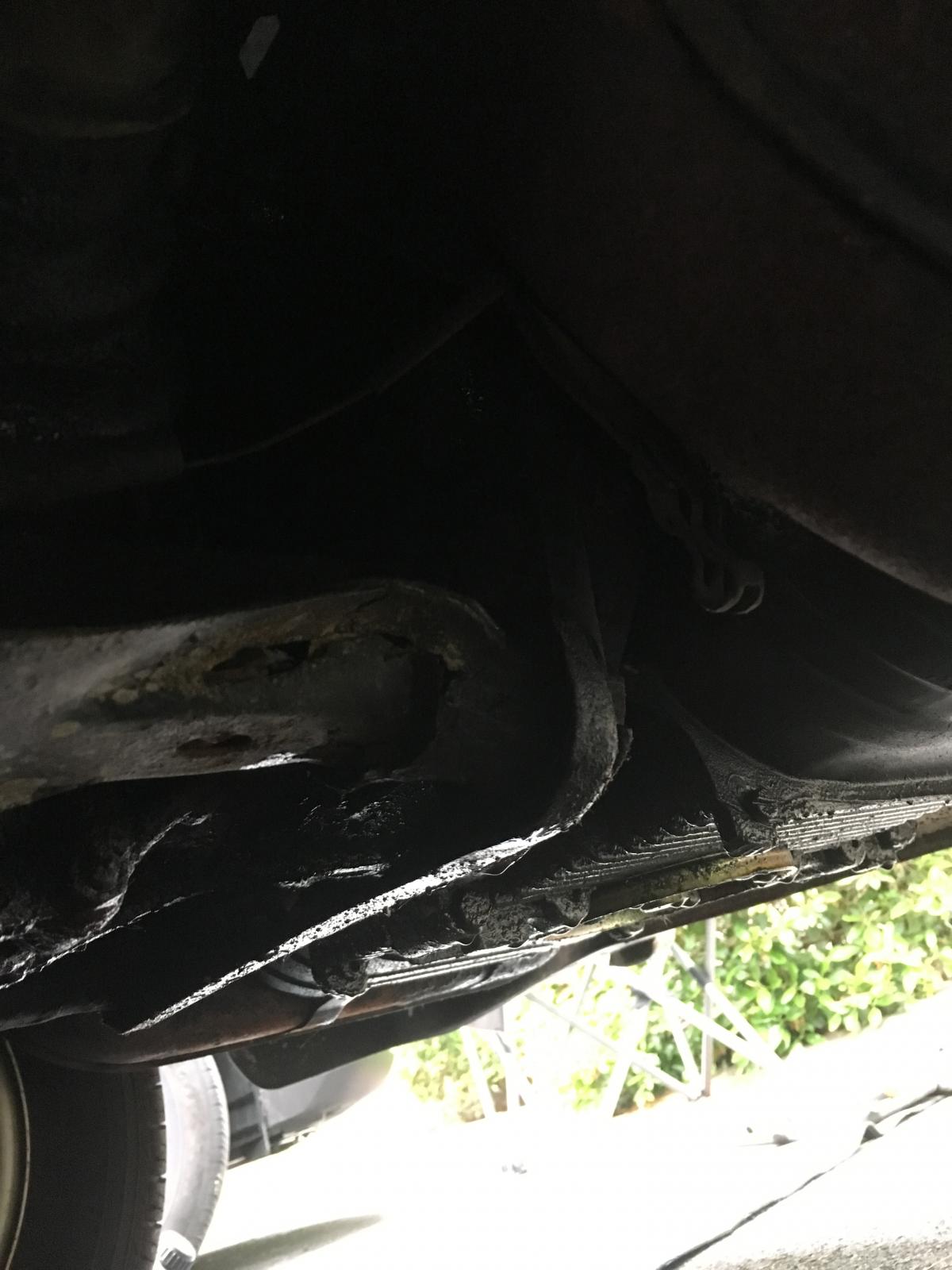

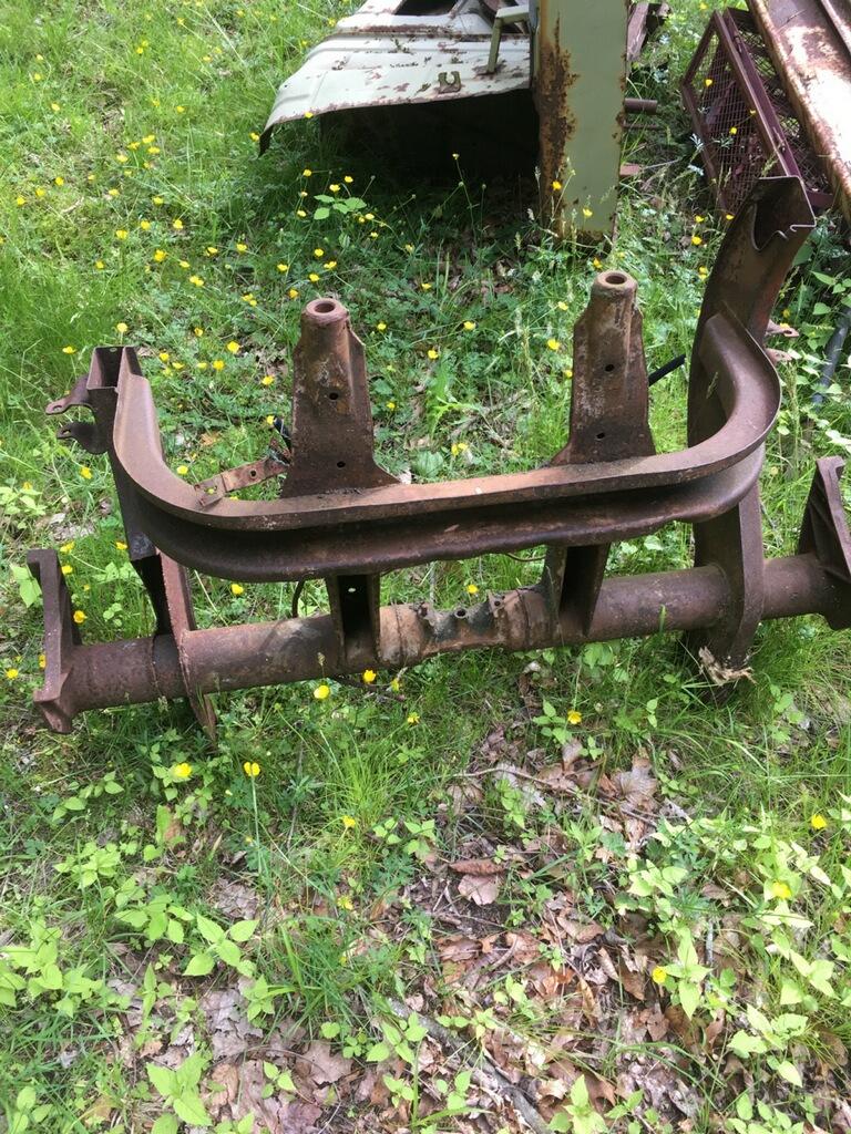

The bus has been off the road since last month. I was doing my spring time driving around town and noticed one day that the air cleaner horn + rubber tube was not connected to the oil bath. For some reason no matter what I did it wouldn't reach... Think It was also running kind of hot and needed a spring tune up. I crawled under the bus to start doing a valve adjustment and noticed this:
The bottom of the drivers side frame horn has rusted out. Shocked Causing the engine to sag. This is why the air cleaner tube wasn't reaching. So I called around to the local bus guys and Clay had the metal I needed.
I have been sidelined with this task. I thought that I should sell the bus and be done with it. I've had my bus for 15 years and only took it off the road once to rebuild the front axle. This is going to be a huge project. Transmission + engine cleanup. Any tips on this would be appreciated and helpful.

edgood1
Joined: September 30, 2004
Posts: 2099
Location: Plymouth, MA
edgood1 is offline
PostPosted: Wed Jun 26, 2019 12:26 pm    Post subject: Re: 66 slider Reply with quote
How is the other horn? I think cutting out the horn section off from the torsion tube and the lower support member is the way to go....it's actually not that terrible of a job with the engine and transmission out. You should have good access while sitting in the engine bay. If the other side horn is questionable ,I'd consider replacing both horns and the support member as a unit . I'd inspect all the surrounding metal too while you're in there.
we don't live too far apart. ( i think we've met at some of the shows) I can help out however I can.

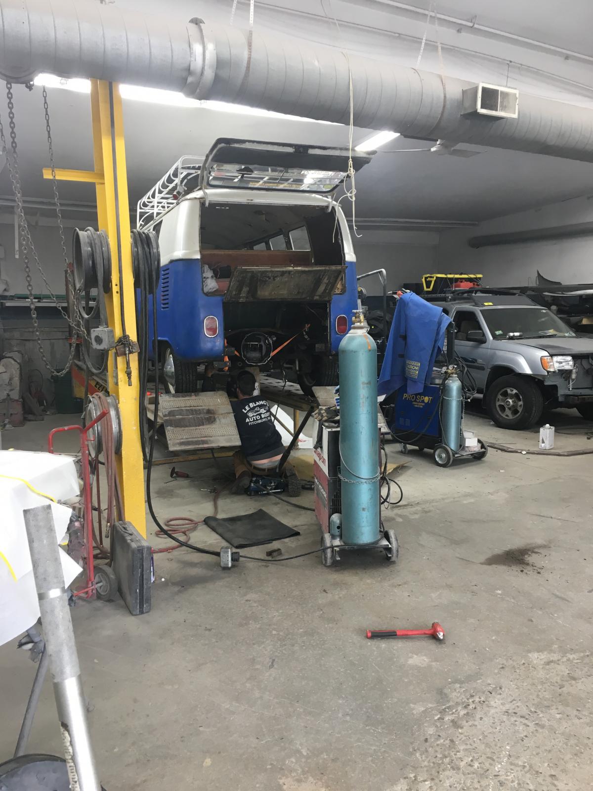

Update...last fall my buddy helped me weld up the bus.
removed engine and "hung" the trans. We only had the shop for one day so we didn't remove the rear axle. Found the damage.
chopped and cut the donor piece
Out with the old. Pretty bad. Turned into a nice boat anchor.
Welded it in. Nothing fancy.
