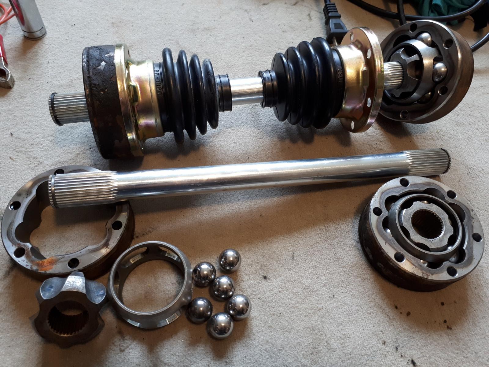

Another challenge was to link the Chevy CV shaft to the VW CV shaft. By chance, I was able to find really short CV shaft EMPI 15 5/8" AXLES 33 SPLINE, rework those and build two short complete CV shaft with the original Vanagon CV joints.

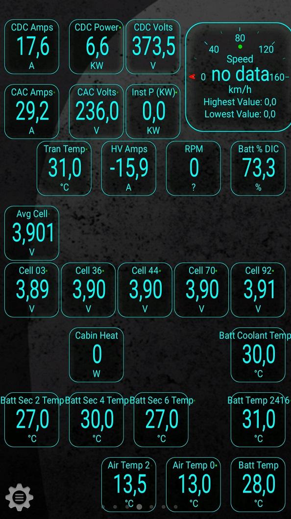

So I have now a digital cluster and a touch screen in the middle of the dash. With torque pro, I have access, on my cell phone, to a lot of detail during charge or during driving (temperature, power, SOC, cells voltage).
