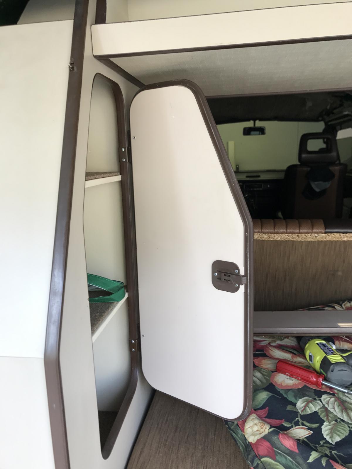

Recently I replaced the rear cabinet. It did not have the rear most door. I sourced another door for it. However as you can see it doesn't quite fit properly. The top shape is a little too narrow for the opening. I had another rear door and it too was the same size. The cabinet looks like a normal westy brown one. It apparently there was a small change made at some point. Anyone familiar with this better yet do they need my door and have one that fits my opening?

OddN wrote:
Actually, it was more of a model change.
All Joker/Club Joker models have the tall door. And all California/Atlantic have the shorter door.
California first appeared in late 88, and the Atlantic in early 89. But there were some overlap Joker production after that (up to 90 I believe).
Hate to be a pedant, but my Euro spec 1989 Joker has the short door.
