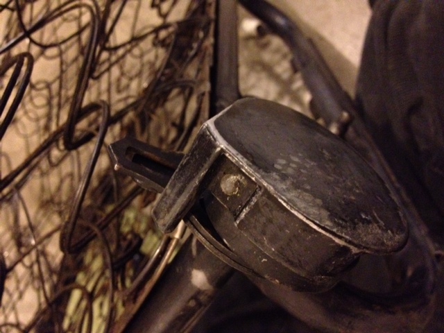

I'm curious if these are worth pulling apart to clean up and repaint? They seem like they can be tricky to put back together and I'm worried about breaking or messing up the pins on the inside.
1) Has anyone taken these apart?
2) is there a procedure listed anywhere (I've searched high and low to see)?
3) If not worth taking apart, should I tape off and spray and then paint brush the small parts to avoid gooing the mechanism up?
Thanks for any help

I wouldnt do it. The pin is tough to get out. I did it to an old set I had and its a pain. just rough it up as best you can, prime and paint. it wont gum up the mechanism if you paint it.

The 61-65 Bentley talks about it briefly, but it only just shows them using a punch to drive that pin out, and not really anything else. I'm not sure if the later seats are much different from the older ones, I can't recall ever taking the later ones apart before.

Thanks! Does anyone know what the flat disk with the tab sticking up (the tab has the middle hollow) is used for? I can't figure out the purpose.

Just went thru that with my Ghia Vert build. Someone had beat the heck out of the back of the seats and bent in the seat tube and binding up the rod for the seat back release. It is not hard to do, just have to study how it works and reassemble. There are 2 rods or tubes that go thru there one is for the seat back release attached to the pieces you asked about and 1 for the seat back angle adjuster. The pins that hald the angle adjust is really a screw nail and will come out easily enough.

So, I finally broke down and took apart a set of these seats. The hardware is pretty straight forward if you look at it before taking it apart. The hole just opposite of the nail head is for a punch (or in my case I sawed off the point on a thin long nail). Just insert and hammer that screw-pin out. I left the spring in it's normal spot. Notice the grey cap in the middle - it goes on top of the spring.
FYI in case anyone tackles this in the future

I am in the process of tearing my seat frames totally apart so I can powdercoat them. I will get pics soon. As far as removing just RE-read this thread.
There are two tubes inside the seat frame tube.
- One tube has the adjuster knobs held on by the 2 inch long spiraled nail. Once you remove the nail it takes some beating to get them off. On the inside face of the knobs is the spring with plastic cap the indexes the four positions of adjustment in the side of the seat frame(4 dimples).
- The other tube has the plates press fit on the end.
