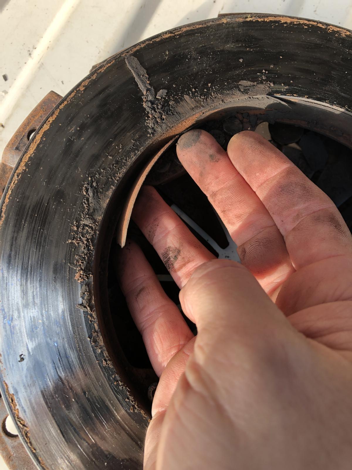

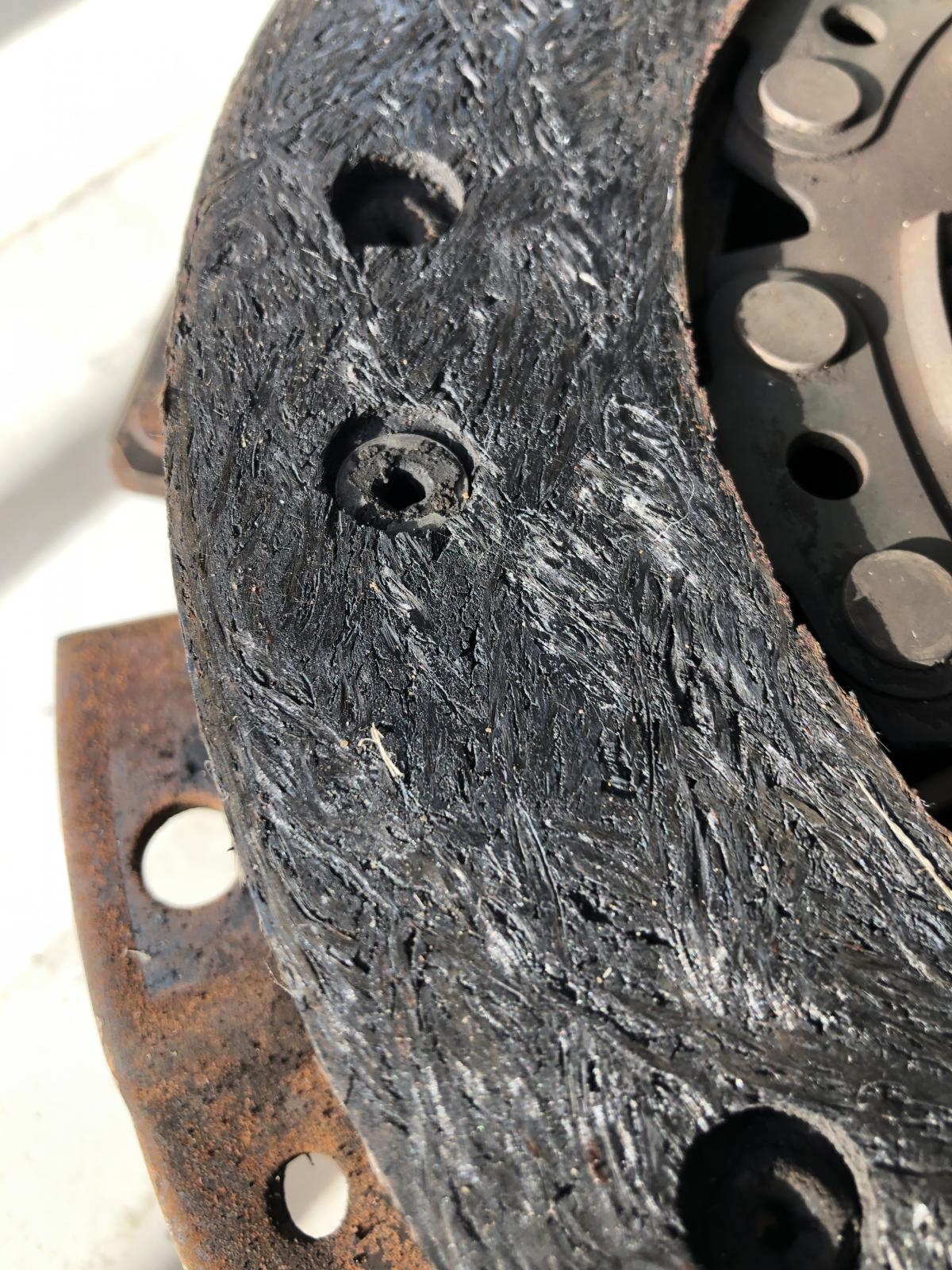

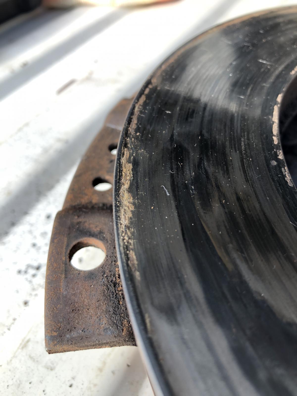

Today was the first day in a month I’ve had to work on the van. I pulled the transmission off shortly after the original post. I also removed the master and space completely. I have since received my replacement master and slave cylinders. Even if they’re not the culprit, I figured I’d replace them once and for all.
Today I removed the pressure plate and disc from the flywheel. They’re toast. Photos below. I also removed the flywheel and dropped it off for resurfacing.
Thankfully I’ve got a brand new SACHS clutch kit in the garage that I can throw on, but I remain perplexed as to how this happened.
I’m don’t really care about finding the mystery as if it’s some map on the back of the Declaration of Independence. However, I can only assume this will happen again if something is left in the same way that caused this in the first place.
Checking boxes: The wheels spin freely and I have no reason to believe the brakes have ever seized to the point that it would overwork the engine. The flywheel end play is just above spec at .006”, but that shouldn’t be a big deal. Everything’s been torqued to spec.
The only suspect thing here is the leaky master cyclometer. However that doesn’t explain a slipping clutch at all.
Any help would be much appreciated. I really need this van back up and running again for a trip with the kiddos soon.
Lastly a comparison between the disc I just pulled and a brand new one, just for kicks.

I'm curious if during your panic stop the engine went so low in revs as to stall with the clutch engaged -- and/or too much was demanded of the parts while working the clutch.
Just a thought. I've mentioned heel-and-toeing here several times but have yet to get a reply from others knowing or using this (and Mark Ward surely does).
Also, the pressure plate seems to have a chunk of clutch on it as if ground off by a ton of stress. It looks very similar to a clutch drum after toasting a clutch on a small race motor when caused by heat and/or chatter.
Glad you nailed it regardless.

Clutches are not damaged on the low end of the torque curve.
That clutch is burned up from slippage while the engine is turning fast and putting out max torque..
It could look like that from either a malfunction such as a stuck cross-shaft bushing, or improper use (which you have not mentioned).

jeremypbeasley wrote:
For the record, I’m entirely open to this being improper driving/operating. Damage is done. I would just want to know what I’d need to do differently.
I drove five miles home at about 20mph immediately following the heavy braking incident. I stopped 3 times along the way just to let it rest. Once home, a week later, I drove it around the block just once. Maybe I’m ignorant, but could I really fry a disc as bad as I’ve shown in under 6 miles of driving?
Besides what I’ve described just now, what would be improper use?
PS, I don’t think there’s any malfunction in the cross shaft. It appears to operate flawlessly despite its age.
I would have expected the clutch to stink like crazy if you suddenly got it hot enough to do that kind of damage. If no stink, I would be inclined to say it happened previously when pulling a hill with the pedal down and for some reason you just didn't notice the stink. Maybe you were having a strong cross wind or something at the time the damage was done.

Kinda along Wildthings' idea, I am wondering if the clutch had been slipping off and on for some time, but had gone largely unnoticed?
For example, I had an old Cabriolet that had a slipping clutch. It would mostly only happen if I were to try to power up a particularly steep hill. I let off and it would quit slipping. But frequently the slippage could be minimal and perhaps not be noticed if things catch up with themselves pretty quickly.
Another time, with a different Cabriolet, I had decided to change the clutch for one reason or another. I drove to my friend's house in Wichita (two hours away) and we changed the clutch with a part he'd gotten locally. Everything seemed fine, but when I was about halfway home, going up a steep hill on the interstate, the brand new clutch gave out. It was slipping so badly the car couldn't go up that hill and I had to get a tow. I swapped in a new one at home and all was fine.
So sometimes stuff is just bad off the shelf.
One other thought I just had is, you might want to really flush out the hydraulic lines before replacing the slave cylinder. There could be some kind of crud in there that was preventing the fluid from returning fully, which would show up as being like you were halfway pushing the pedal. (I don't recall, on a Vanagon are there rubber lines in the system? If so, I'd get a new one-they can fail internally.)
