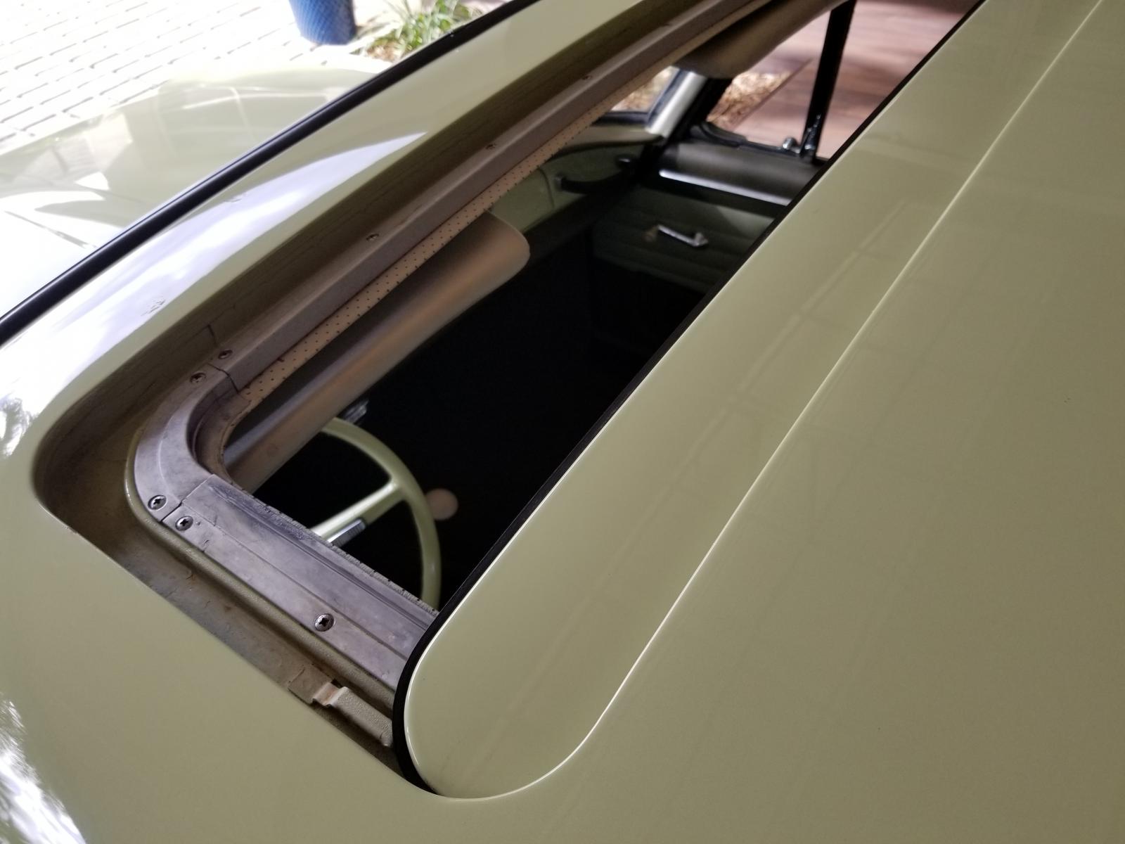

Turns out that with a little patience, the right approach and JB Weld can fix nearly anything. It works! It's ridiculous but this small success felt like a major accomplishment.
Also replaced the door latch mechanisms with NOS units, corrected an oil leak on the new engine and put 100 miles on it this week. A few paint touch-ups and then it's back to work on my '64 Samba.

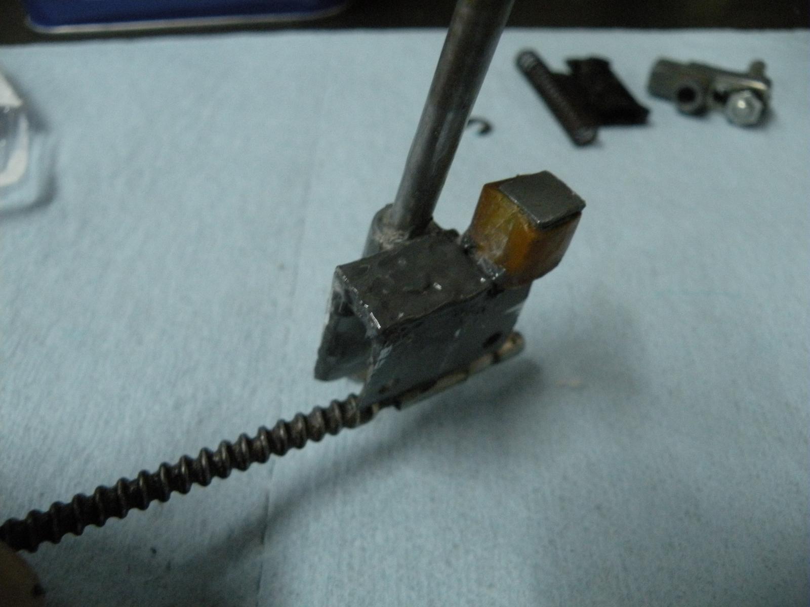

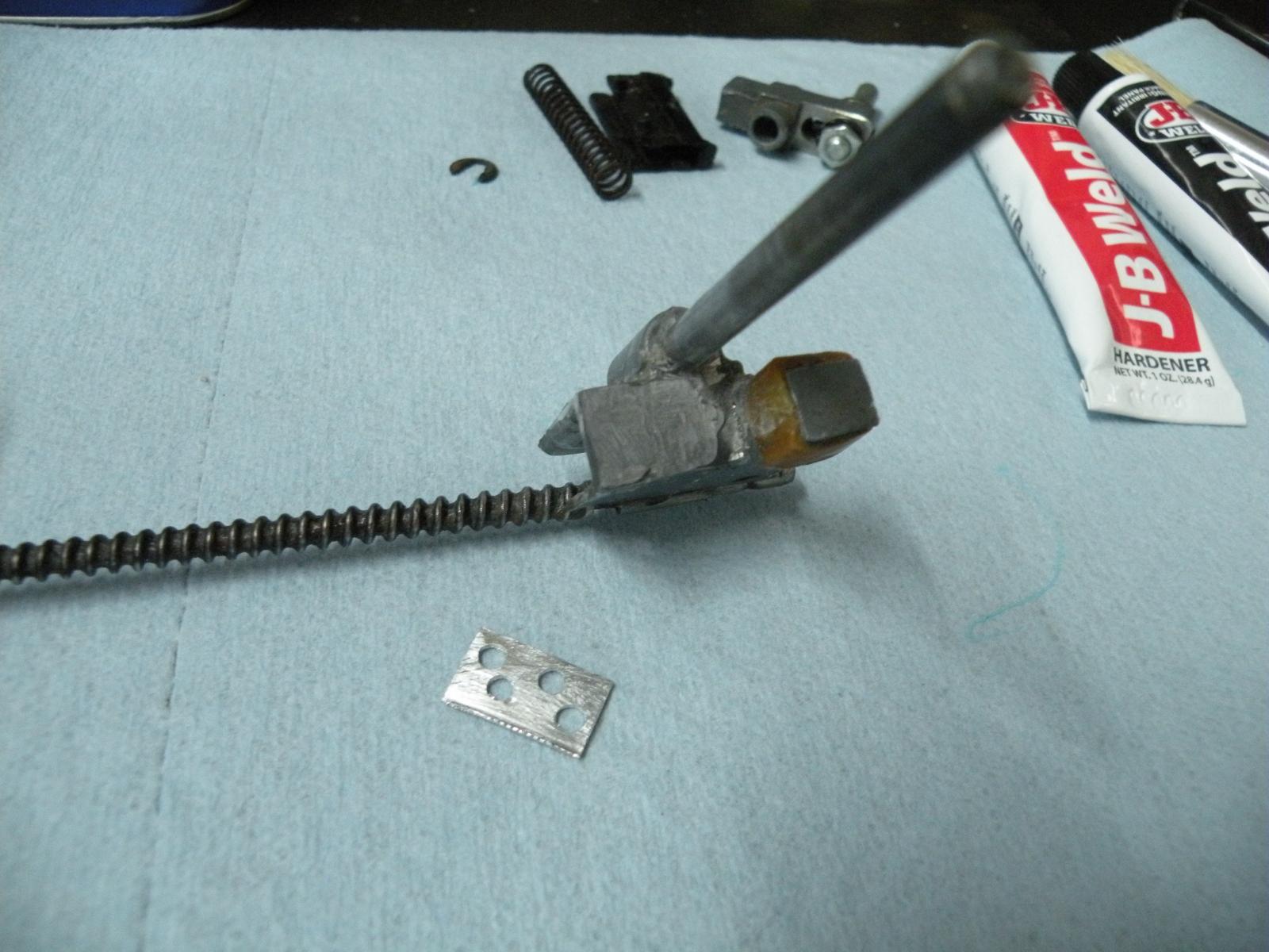

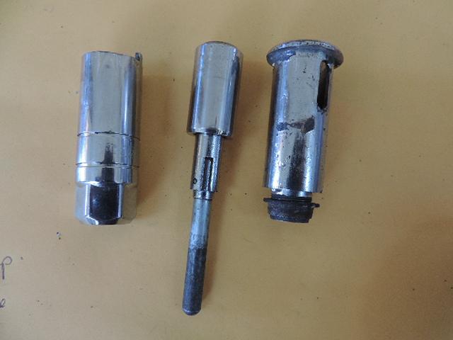

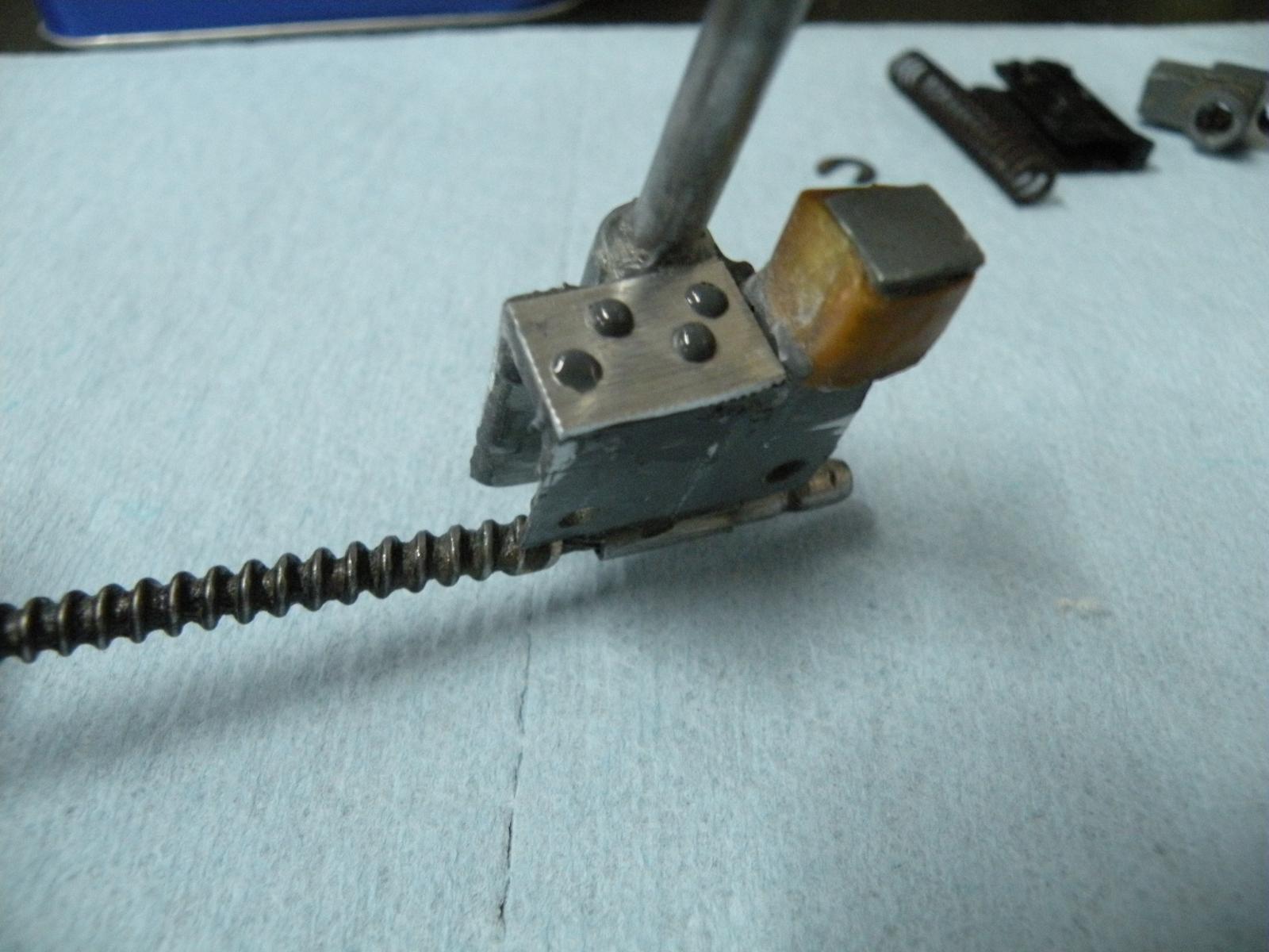

Forgot to comment this earlier: The aluminium piece on the outside of lock frame was loose, I'll guess? The piece which has latch axle inside?
Mine had that problem on the driver side door so I took the lock apart and the problem is basically a rivet failing and being loose. The aluminium part is just riveted to the lock frame with one aluminium rivet. No wonder it eventually fails.
Drilled and threaded a M3 hole to rivet, bolted it and now it's as good as new. Have some pics too, but those are poor so I didn't publish them on page. User error on focus as autofocus couldn't focus that near.
Here's partially disassembled lock and the end of the rivet with a already threaded hole can be seen in the middle.
http://kharon.suomiforum.com/www/ghia3/P1122252.JPG
Here's same thing with bolt and washer installed.
http://kharon.suomiforum.com/www/ghia3/P1122253.JPG
Hopefully you can see something as I had that thing on the desk, I know what it looks like so it's easy to imagine the rest even from poor pics.
Useful info for sure, but both of my latches were simply worn out: the lock pivots themselves were shot, and the lower face on the driver's side had a fair amount of it's face worn off. They weren't re-buildable.
And thanks for the encouragement Bob... yeah, sometime ya gotta make do. Sunroof works great, but with summer coming it's not gonna be used for awhile. Laughing

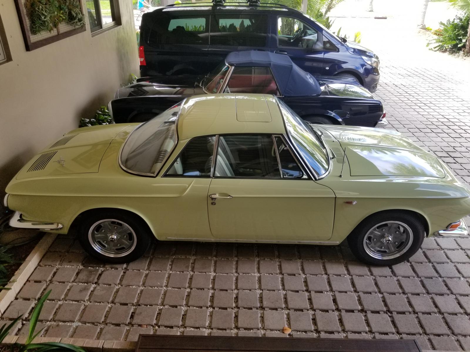

Now that the paint touch-ups are done, the punch list of niggling issues is nearly complete. Replacing the antenna with a proper Hirschmann next week, and the clock will be serviced. Meanwhile, it's back home for regular daily use.
Parked next to our 280SL illustrates just how big der Grosser Ghia is! Nearly identical dimensions. Never woulda thought... EDIT: a better photo-

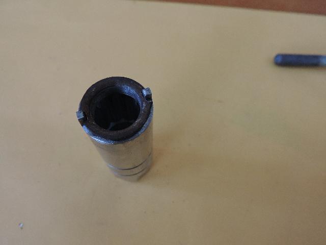

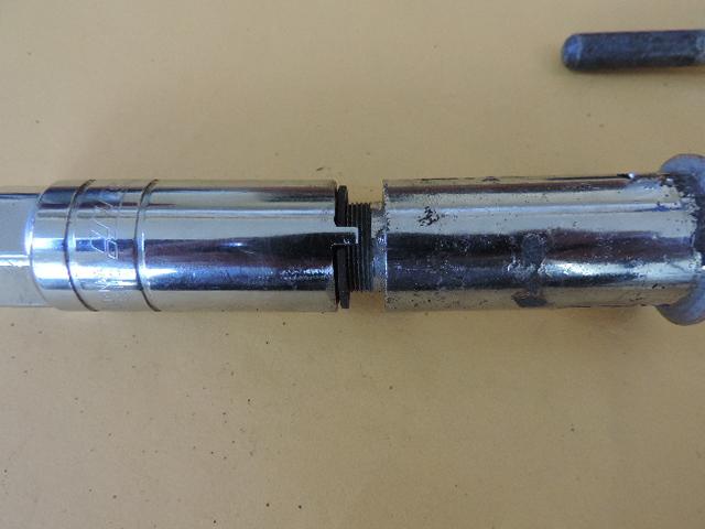

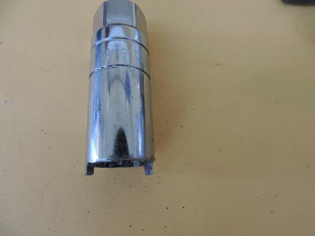

Tip: for those home manufacturing the tool to remove the rear engine hatch lock - the same collar with the two detents is found on beetle glove box locks. You can test the fit before mangling the T34.
I used a 16 mm deep socket, cut the two teeth with a dremel and cutting disc, filed smooth by hand. THe socket needed some internal grinding (again with a stone on the dremel). The tangs are 3.5 mm wide, 2.5 mm deep
Now I need some tips on how to disassemble the lock.
Update - photos to show it can be done! One showing the threaded ring in the tool.
