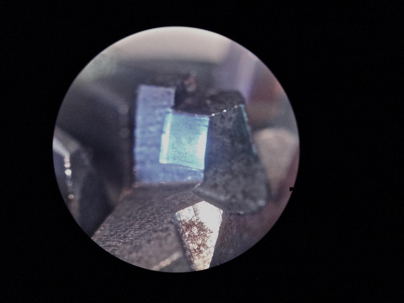

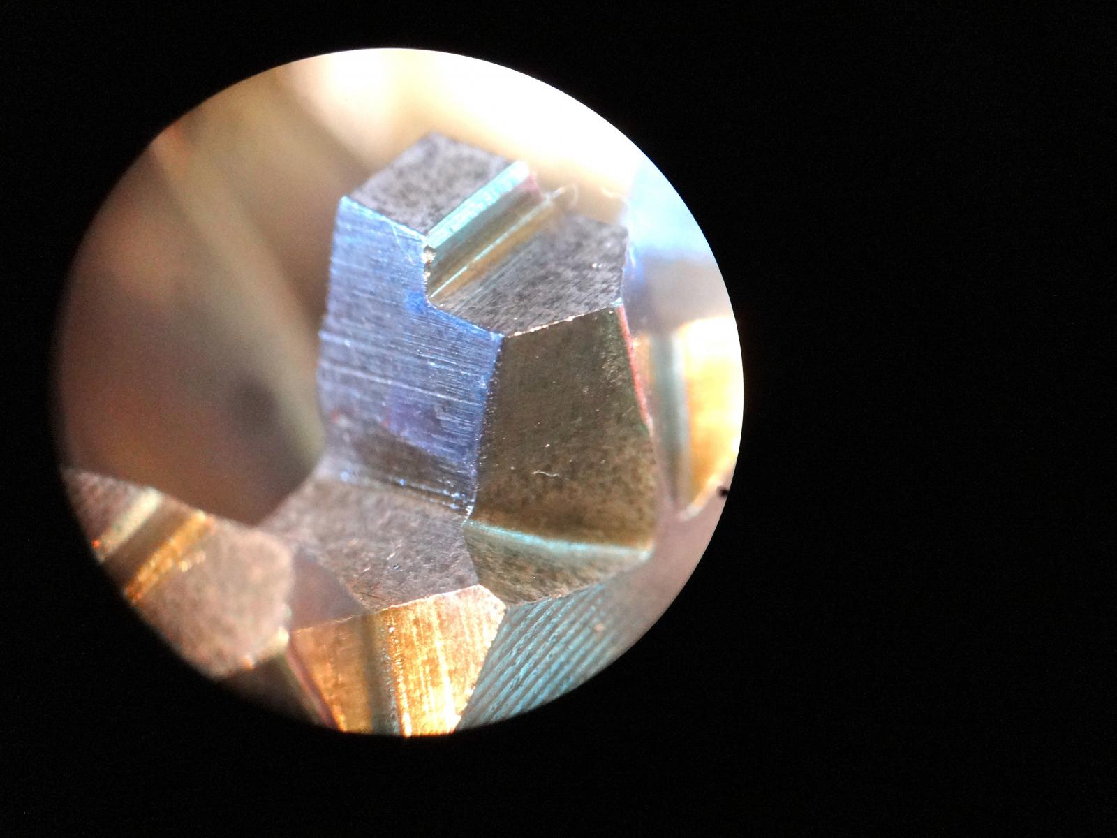

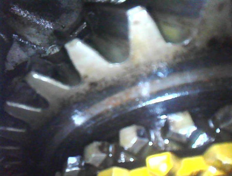

I'm 99% sure a jig wasnt used to start with.
So I had some fun with my endoscope, the results :
1st gear dogs
Vid here
https://youtu.be/OezD1d0Bnjw
When I engage 1st via the shifter (and yes it's going all the way) the slider and 1st gear faces kisses but as I let off the shifter it moves away a bit.
Also if I go between 1st and neutral, only some times it goes all the way home. It goes all the way more often when I go to 2nd and then straight to 1st but still not all the time.
You can also see in the vid when I wiggle the shifter back and forth gently in 1st, the gears come apart but does not pop out.
Vid
https://youtu.be/7VORvz-hirM
Below Vid of second gear engaged and move the shifter back and forth. Notice no play on the gear until 20sec mark where I actually was pulling for it to come out of gear.
https://youtu.be/Y1o3FLqvTdU
Below Vid of first gear engaged and the shifter moved back and forth while in 1st viewed from the fork side
https://youtu.be/PaTO60gphSo
Thoughts?

No need to apologize and I value everyone's input. If everyone had the same opinion and ideas this place would be boring right! Laughing
According to "the book" the fork should be centralized in the groove of the operating sleeve both when the gear is selected and when in neutral. So we could safely assume the the fork or pressure from the fork does not hold the gear in place.
I do believe the fork is out of adjustment because it is definitely hard up against the sleeve on the second gear side but of course this might be only part of the problem.
Mcmscott have you seen the vid I posed with the first gear dogs? I am new to this but from what I have researched the peak on them seems defined and does not have a whole lot of wear.
I also tried to get a look at the teeth in the 1/2 sleeve but was only able to get it on the 2nd gear side....I'm assuming first gear side will be more or less in the same condition. See vid below.
Aren't those on the sleeve supposed to be pointed?..its not from what I see??
https://youtu.be/GrmDW3KRLAE
Thanks guys.

PostPosted: Thu Apr 23, 2020 12:39 pm    Post subject: Re: 1st gear pop out on lift off Reply with quote
Photos might help:
Here's an unworn flank (yeah OEM sometimes isn't that pretty)
Note the slight wear on tip and corner ..
.. while on this gear, tip & corner have about the same wear, yet the flank is toast. So, you can't judge condition of the engagement teeth based on tips alone. (sorry for fuzzy)
