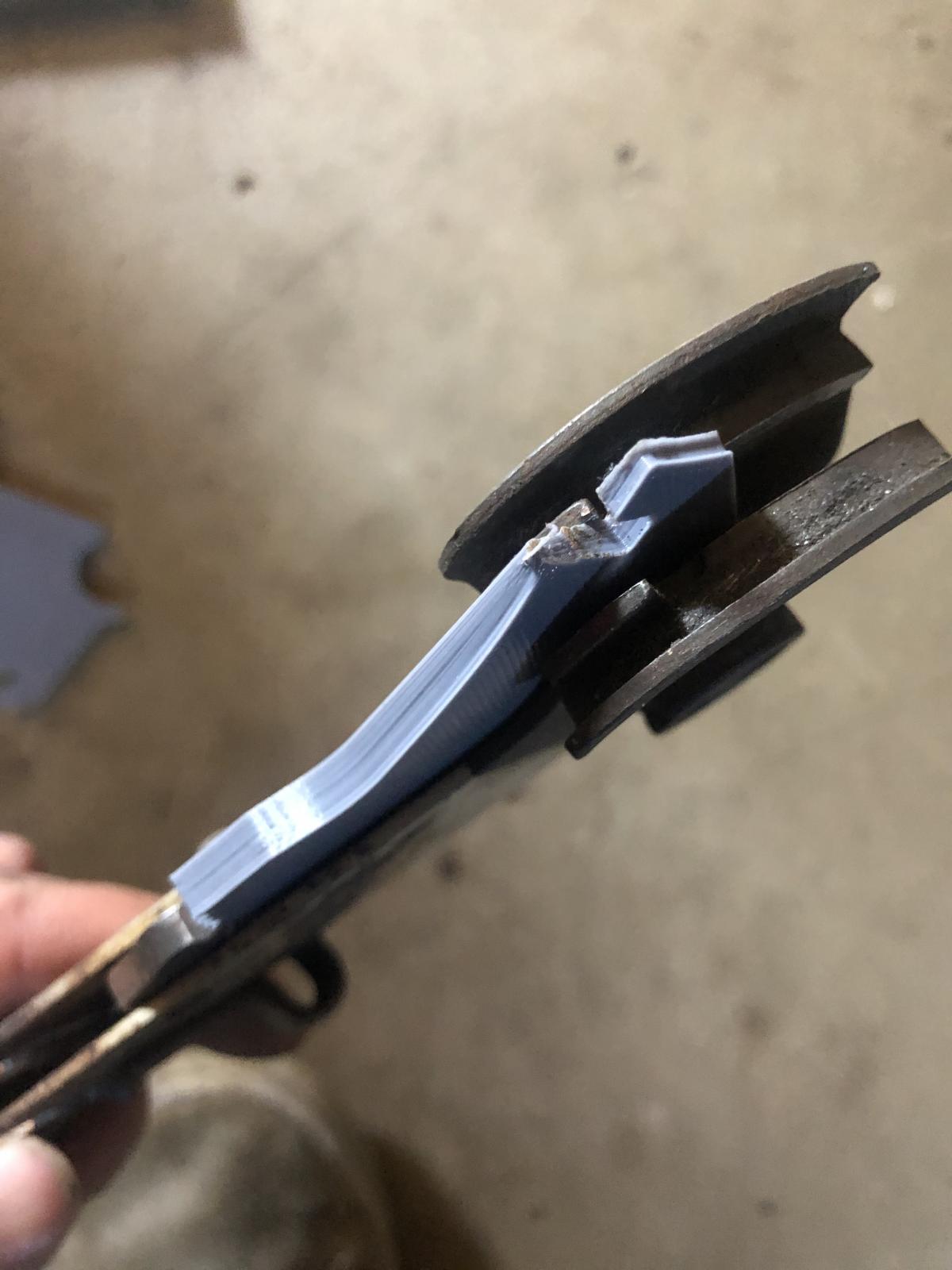

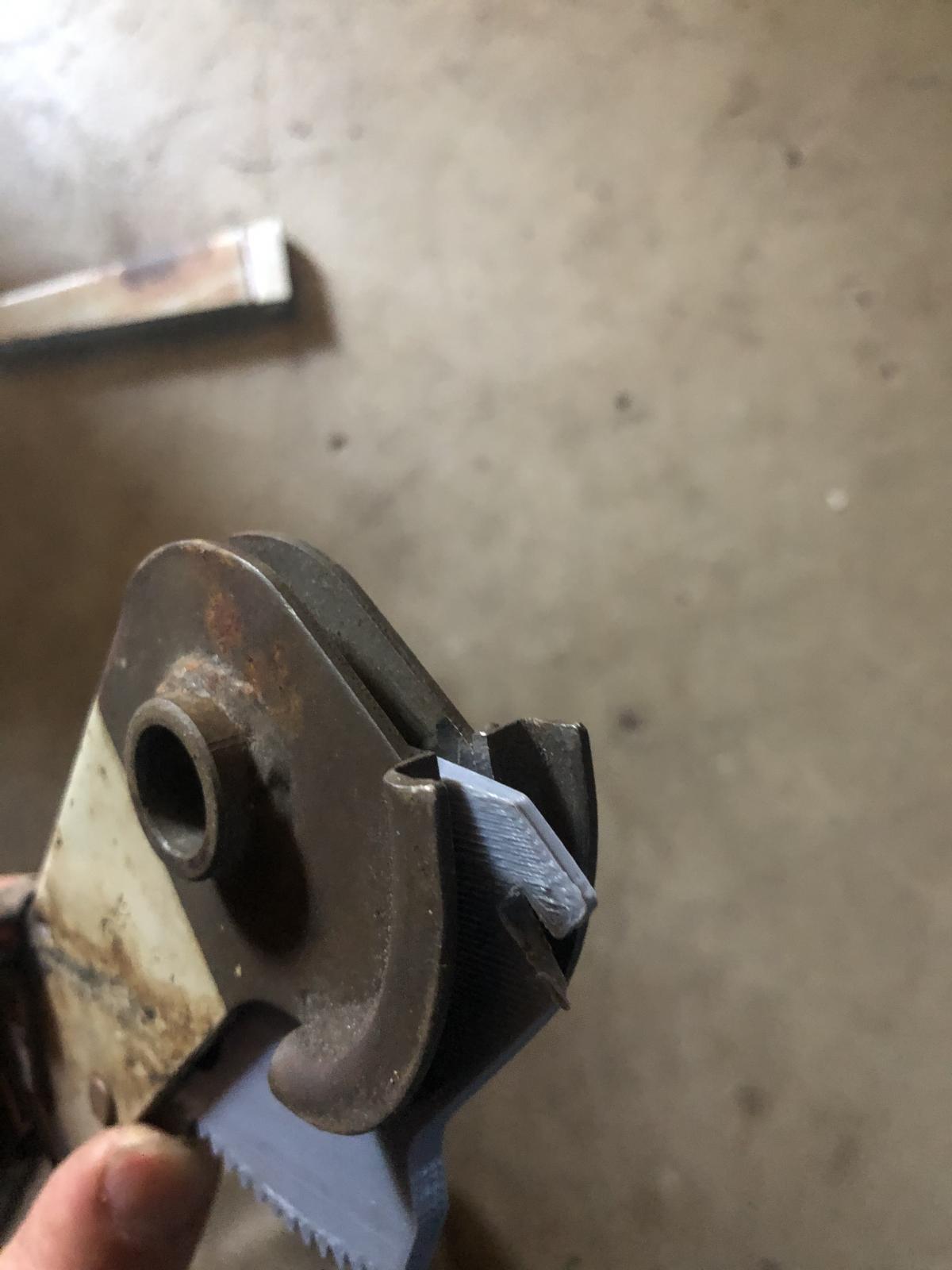

So, not like I'm getting 100% back into this project or anything, but I have been working on something for it and figured I should share.
since frame is heavily modified, ebrake location is now ~1ft forward of shifter. Not much room in there for the stock length ebrake though given low cabin height and the trough in the gas tank and the dash.
So, I had the idea to just change the angle of the handbrake to more of a vertical sweep than a horizonatal sweep, kinda like a bus ebrake handle.
I drew up some models of ratchet plates that relocated the whole ratchet section up 30degrees and 45 degrees, wasn't sure how far I'd want to go. printed out on the new 3D printer toy. Shortened ebrake handle 135mm. In theory, should be able to just shorten the rod the same amount and rethread and everything will work. I did have to cut through the middle of the cam section the cables ride in. Not sure what extend of additional mods will be needed there but should be pretty easy to add some length to the cam.
all the bits laid out.
full release position.
full tension position.
full release position in car.
full tension position in car.
Pretty happy with fit and everything, so next step is to finalize some modifications to the CAD model and add it to my next laser cutting order.

Yea pie cutting the handle came across my mind but I rejected it because I needed some pretty extreme angle shift and didn’t think the pushrod would work.
Laser cut piece received today. Spent some time deburring it but looks like it’s going to work well.
