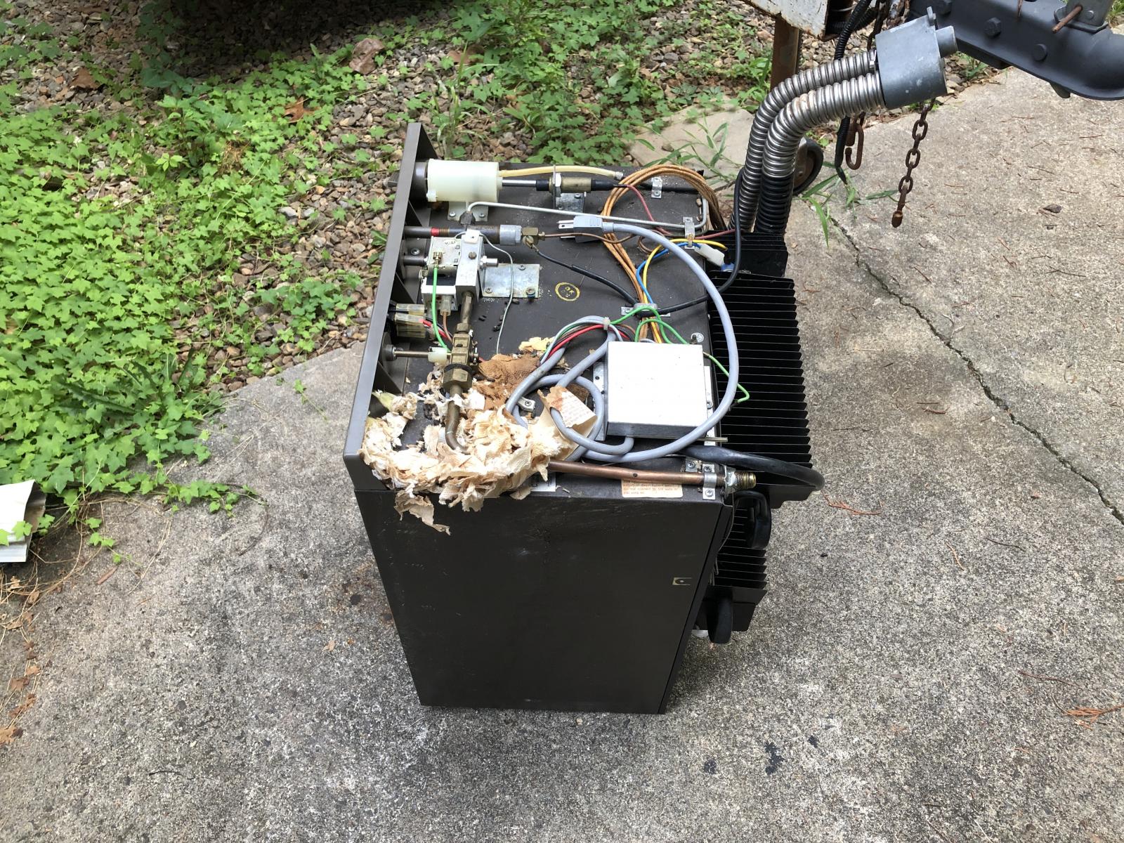

I pulled the original Dometic out to install the new Truckfridge TF49 AC/DC unit. No wonder I couldn't get the smell out of the van! I had to take the Dometic outside and leave it there it smelled so bad! Mask, gloves, shop vac, and a bottle of Clorox I finally got the area clean.
Got the TF49 wired up using the switch panel on the side of the cabinet, blade fuse. Decided to leave the bottom open for now to let it air out, and put the piece of aromatic cedar on the top to improve the smell.
I've had the fridge operating for less than an hour and it's already colder than the Dometic was when run on 110AC or propane.
