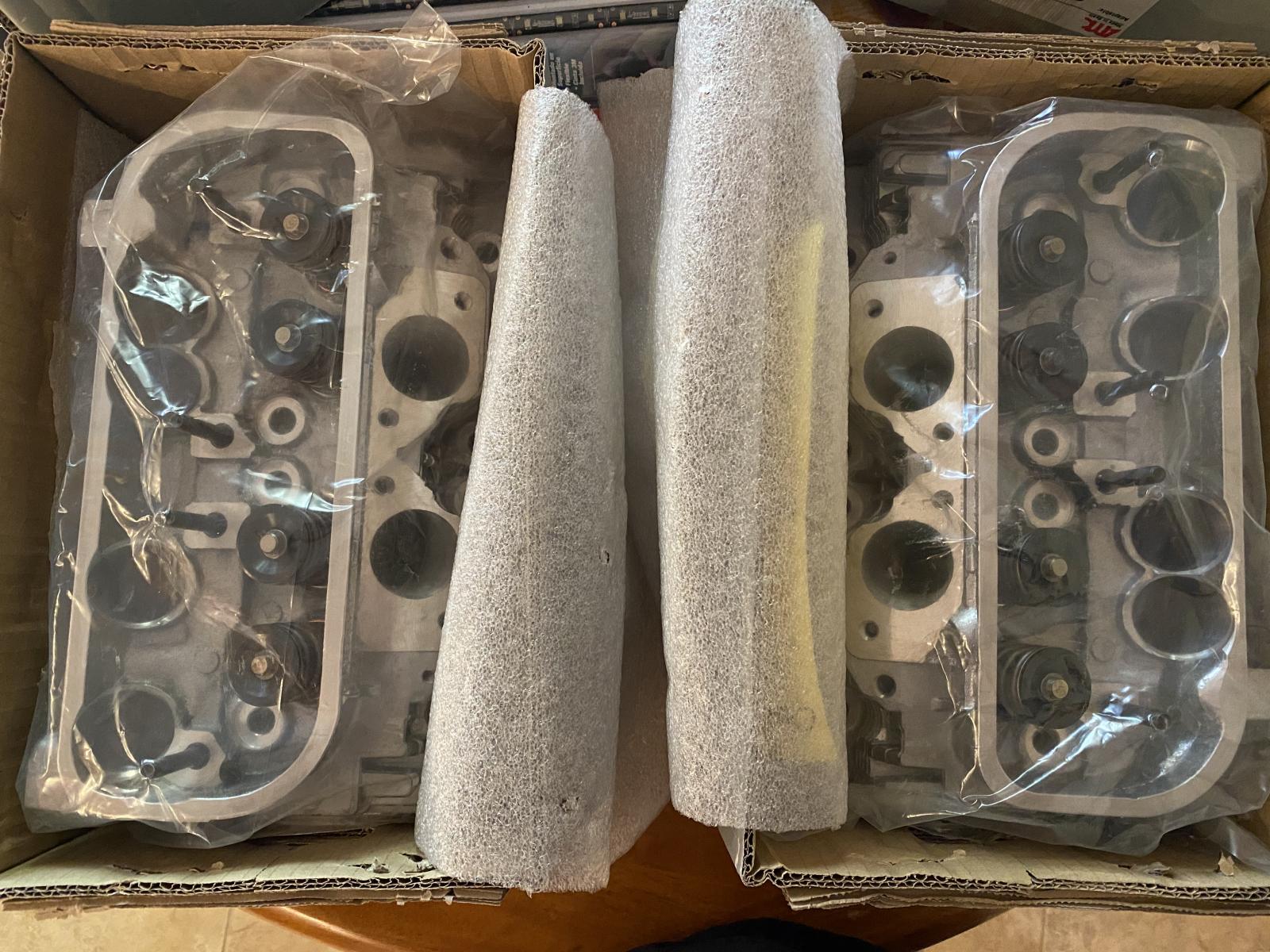

Early Christmas this week at the white74westy house:
You keep hearing people say how these things are works of art, they truly are magnificent when you see them in person!!! Len's work is second to none! Excited for what's to come!

Still waiting on the camshaft. The work has already been done. However, the lifters couldn't be saved. Rather than to sell me what she believed to be an inferior product, Faith recommended that I wait for the new batch. Hopefully I should hear something from her fairly soon and we can get back to building the engine.
I had a little time to look at the heads a couple of weeks ago. Almost immediately I noticed that there would be a problem with the thermocouples that I bought. I bought them off the internet somewhere. They're 14mm with 24" of shielded cable. However, the part that attaches to the ring sits at a 90° angle.
Subsequently they wouldn't fit properly in the notch and definitely wouldn't allow the ring to seat properly under the spark plug. I asked Len if he would be willing to take a look at the heads and the thermocouples to see if anything could be done. As always, he was more than willing to oblige. He removed some additional material from the original notches, and I think they're going to work great.
Hopefully it won't be too much longer...

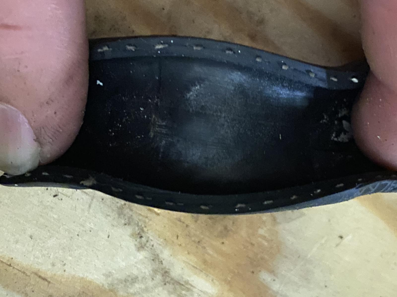

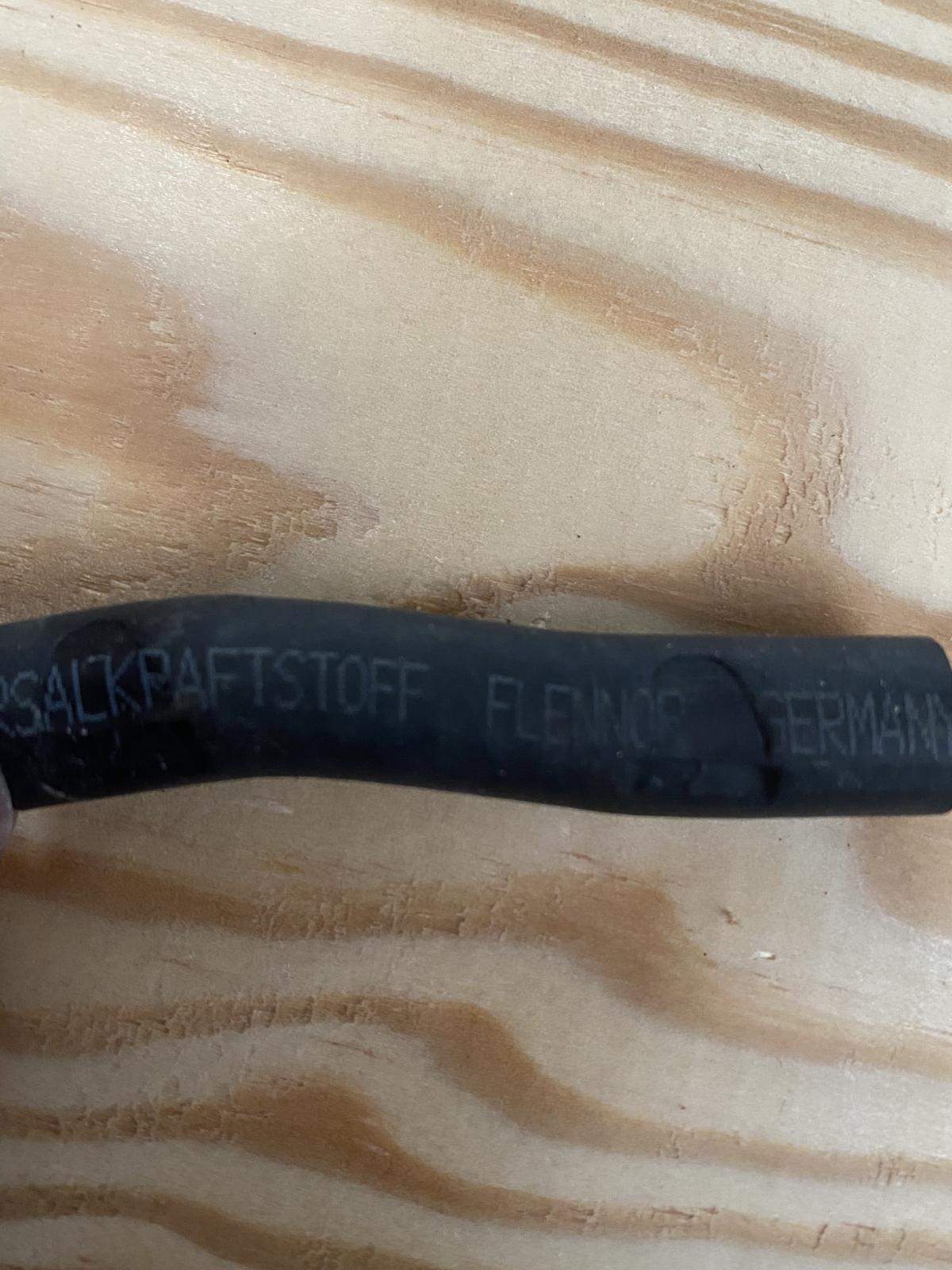

While I'm waiting to get the cam and lifters back, I decided to do some preventative mainainence. I opened up the firewall and replaced all the fuel lines in the engine bay.
Started with this little bugger, as its always one of the ones I like doing the least:
As you can see, I went through the opening left by removing the tail light. Lots more room that way! Right before I tightened up the clamps:
Also wanted to take a moment to highlight the fuel lines that I used, the last time I installed them. I bought the correct size, metric hoses, from Belmetric.com. It's the flenor product that they offer:
Here's a link to the fuel line for those interested: https://www.belmetric.com/multifuel-hoseethanol-ap...sv33dl8vl1
It's reinfoced and is designed to be used with a bunch of different fuel types, including high ethanol content fuel. I was really curious how it would hold up. I'm happy to report that after approximately 6 years, they show no signs of deterioration! I split a couple of pieces, in order to see what the insides would look like:
The white stuff you're seeing there is leftover paint from the vapor lines. I was also pleased to see no deterioration on the ends either! I prefer to run non-ethanol fuels, as such, I didn't run very much ethanol based fuel through them, so maybe that played a part in it; I don't know. Either way, I was well pleased with the results and decided to use the same stuff again. I hope this proves useful to those that wonder if the Belmetric fuel lines are worth it. BTW...no this isn't some kind of ad, just a friendly FYI. Laughing Laughing Laughing

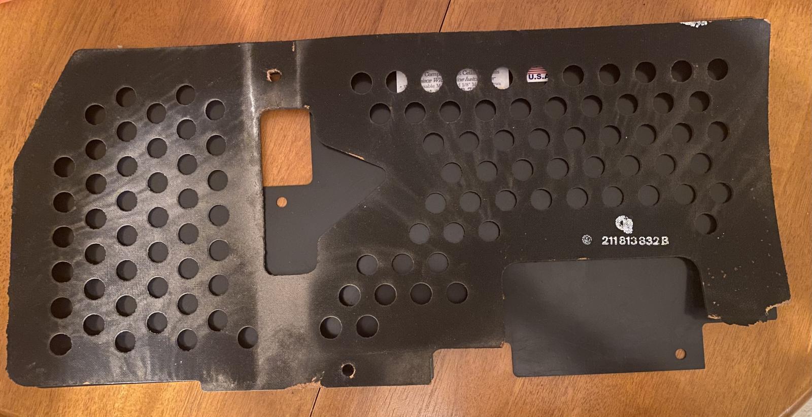

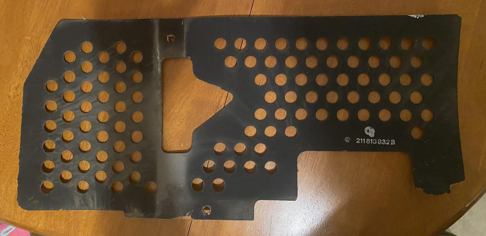

Next up, replacing the hardboard insulation panels at the top of the engine bay.

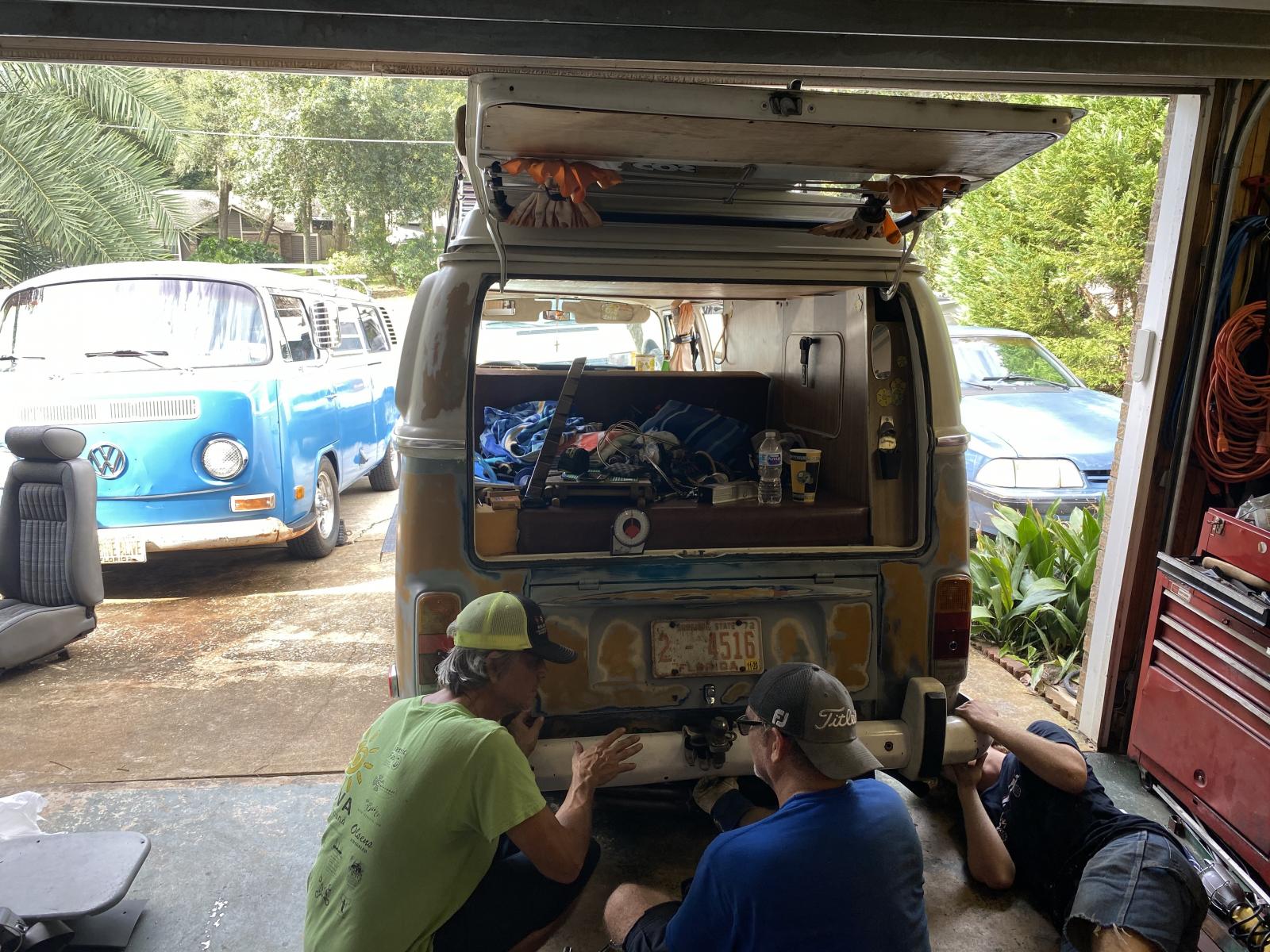

Not a very productive weekend, but a lot of fun nonetheless!
I was out of town for work this Friday, meeting with a customer when I received a call from my neighbor. This was highly irregular, as it was in the middle of the day. Naturally, I thought something had to be wrong. He is a retiree and I worried that perhaps something bad had taken place, and that perhaps he might need some help. I answered, "yes sir!" Much to my surprise, it was not his voice on the other end of the line, but rather that of his wife. If you'll recall, quite some time back, I made mention of my neighbor that was once a seamstress. She is a lovely retired lady from Germany. She agreed to help me make new curtains for my bus! I'm not the type to rush anyone, and truth be told, I've had so much other stuff on my plate that I really hadn't given it much thought. Well, she was calling to ask questions about the curtains. Very exciting! I couldn't answer the questions then and there, and asked if I could come by later that afternoon. I really have very little left to do on the interior of the bus, but this is one of those things. Of course it was all I could think about for the rest of the afternoon, until I could get back to town. I'm really glad things worked out the way they did!!! The whole way home, I was thinking about the curtain patterns that I had given her. I can't remember where I got them, but I'm pretty sure it was off TheSamba. Anyhow, the more I thought about it, I just knew that what I'd given her was just not right. I met with her and we talked things through. The plans/patterns I had given her were for a later model bus, that probably wouldn't have been quite right for the '74. Happily, we walked through it all and I hope to have a complete set, precisely like the ones I removed, all those years ago. I must mention, that I did have a couple of them left, which I left with her to use as templates. Anyhow, she had a couple of them finished when I got there. Here's a little teaser:

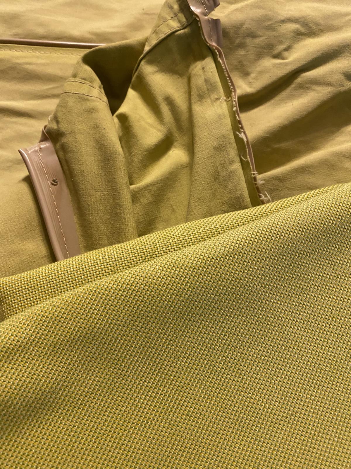

As you'll notice in the first photo, the new material is a very close facsimile of the original in color, and pretty close in texture to the rest of the material used in the bus. Thankfully, it is UV resistant, so hopefully, they'll hold up a lot longer than the originals did, specific to bleaching that is so common with the curtains in our buses. Needless to say, I've been over the moon...I can't wait to see what she comes up with. I can't wait to finally be able to finish the interior of the bus!!!
Yesterday, I got to catch up with a couple of my buddies. My neighbor has a '72 Westy. He recently bought a small trailer to pull behind his bus. It needs some work, and it's going to make a fun little project. However, he didn't have a hitch. Another friend of ours, that lives just around the corner has some pretty amazing fabricating skills and agreed to help make the hitch. By the way, he also has a sweet '72 tintop. I pulled up in my EVC and thankfully at one point, had enough wherewithal to take a picture:
Here's another shot of the boys getting some of the final touches done on the hitch:
All in all, a great weekend in the books! I hope that everyone is keeping well, staying healthy and safe! Cool

I went back and looked through my files. I bought the material early last year. This is the stuff I bought:
Sunbrella 15000-0008 Spotlight Citron 54" Upholstery Fabric
I'm not sure if its still available or not?!? You may have to google and call around to see if there's anyone that has a bolt of fabric left. I bought 7 yards. My neighbor (the seamstress) is working on the last curtain...the one that goes over the windshield. I think she said that would be enough - at least for a '74. Here's a sneak-peak of how things turned out:
I'm thrilled with the way it came out. The colors look amazing together, as a whole. I'll post more pics a little later.

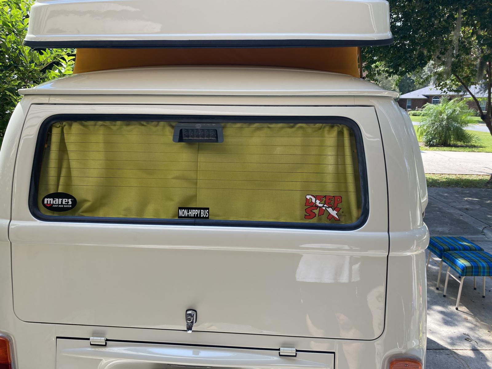

Major stall on the project! To say I've had a full plate would be an understatement. Once again, it's time to get back at it. However, I fear there may be another stall waiting ahead, but I'll get to that in a minute.
When I left off last, I was waiting for my neighbor to finish up the last of the curtains. I got the call that it was ready to go in the middle of October. Yahoo!!!
Here is the lovely lady that did all the work for me:
I took the curtain and laid the original atop of it, to get an idea of where to put the snaps:
In case anyone is curious as to how to install them, this is a link to the stuff I used: https://www.sailrite.com/Easy-Snap-Fastener-Installation-Kit
Once I was happy with the position, I made the holes:
Snaps installed:
Time to mount them in the bus:
Popped the upper corner off in the image above, so you could see how it looks on the inside.
That's how she looks from the outside. I'm thrilled!

Before I went any further with the engine, and while I was waiting for the cam to come back, I decided to tackle the hardboard insulation panels that sit above the engine. Mine were beginning to look tired, like most of them do at this point in their lives. Nothing too difficult as far as removal, particularly when the engine's not in the way! Wink Very Happy While I was doing this I placed an order for some Werksberg replacements, back in August 2020. Covid and the holidays really made a mess of the USPS. It took nearly 3 months to receive the panels. No worries! Wasn't in a rush. I was pretty excited to open them up and get cracking. Much to my surprise, I wasn't going to be able to get very far. The joys of owning a '74 reared its ugly head once again. Laughing Laughing Laughing
The 74 and maybe some of the 75's have some strange one-year-only things going on. This happens to be one of them. As you'll see below, the part that sits above the right side of the engine, has a different shaped support bracket for the diagnostic module:
In the image below, I have laid the original over the werksberg piece so you can see the differences and that it just won't fit:
As always, my dealings with Jim have been stellar! I sent him an email with pictures attached explaining my predicament. He stated that in all the years he's been doing this, he hadn't run across this before. I explained that the 74-75 were strange beasts. He was awesome and sent me an additional blank piece along with some scraps so that I could practice cutting before making my final attempt. I will update soon with results.
