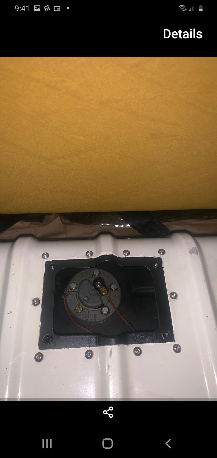

PostPosted: Wed Mar 10, 2021 1:52 am    Post subject: Re: Fuel sender access hole, to do or not to do? Reply with quote
Well , my fuel gauge on my 69 stopped working again and after a couple of tests it looked like my sender had packed up again.It had lasted only about a year. After pulling out the motor/tank to pop another new vdo sender for only have it last for about 3 months before it died. Out again came the motor and tank, but this time I got a genuine old one one out of a 68 bay that was being wrecked at my local Vw parts yard.I rebuilt it carefully using the right nichrome wire from my local shop and its been great for a year till it stopped working last week. Gutted I had a decision to make, drop the motor/ tank again or cut a hole in the top.After much consideration I cut a hole in the top. I put my meter over the sender and to my surprise it tested ok. Shit I just cut this hole and the bloody sender is fine. I tested further and it turned out it had lost its earth. What had happend is the sender gasket had compressed and the five bolts holding the sender in were loose as, loose enough that the earth under one of these bolts was not tight enough for a good connection. I tightened the bolts and fuel gauge is all good again.Glad I have cut this hole now as its another check I will do when checking fuel lines etc to make sure there are no leaks when tank is fill

Skip to about 10 minutes in my video (posted above) and you can see where my access hole lined up to the tank and sender.
Keep in mind, I have a 1972, with an FI tank, which has a sender that is offset to the passengers side.
I cut my access hole right down the center ribs.
Worked perfectly for me. I did install the CNC access hatch, nice fit and finish.
