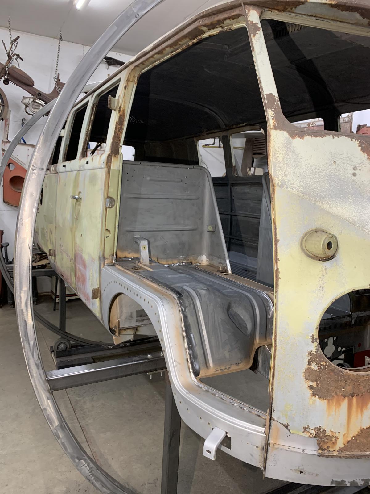

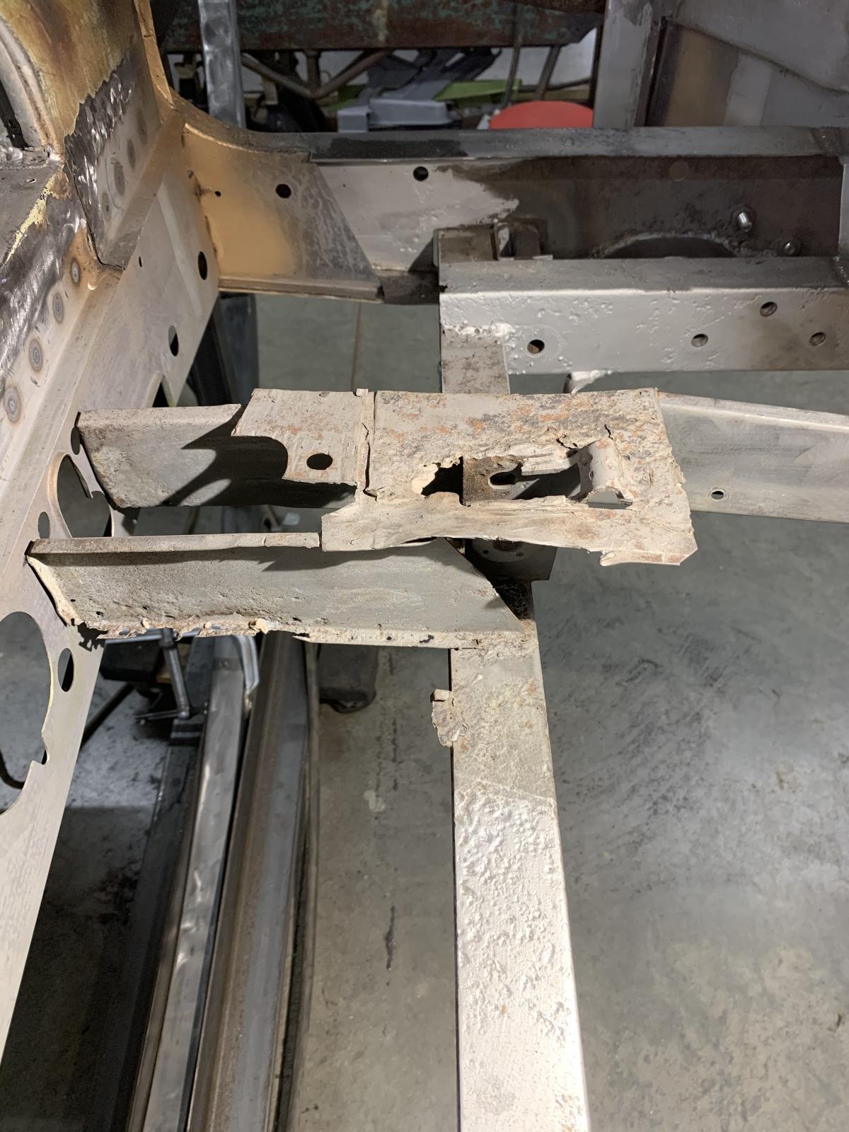

PostPosted: Thu Mar 18, 2021 8:26 am    Post subject: Re: 1959 Mango walkthru metal rehab. Reply with quote

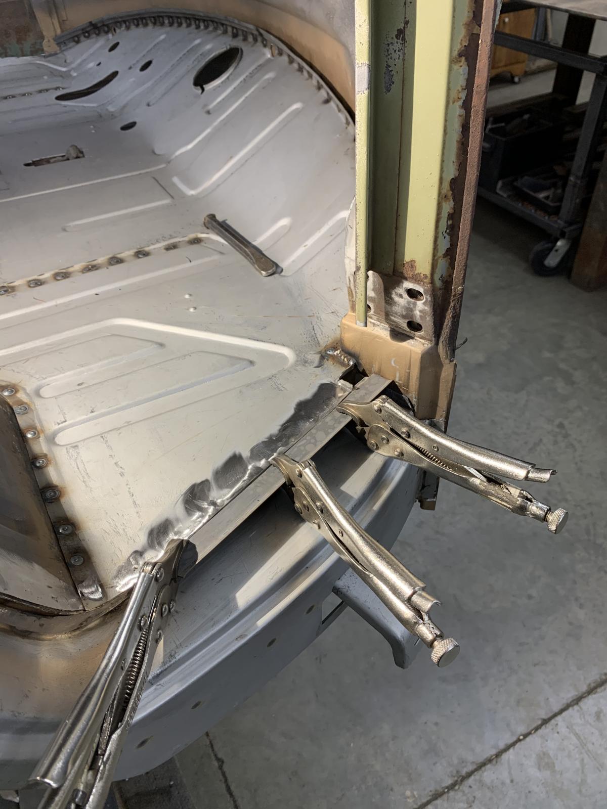

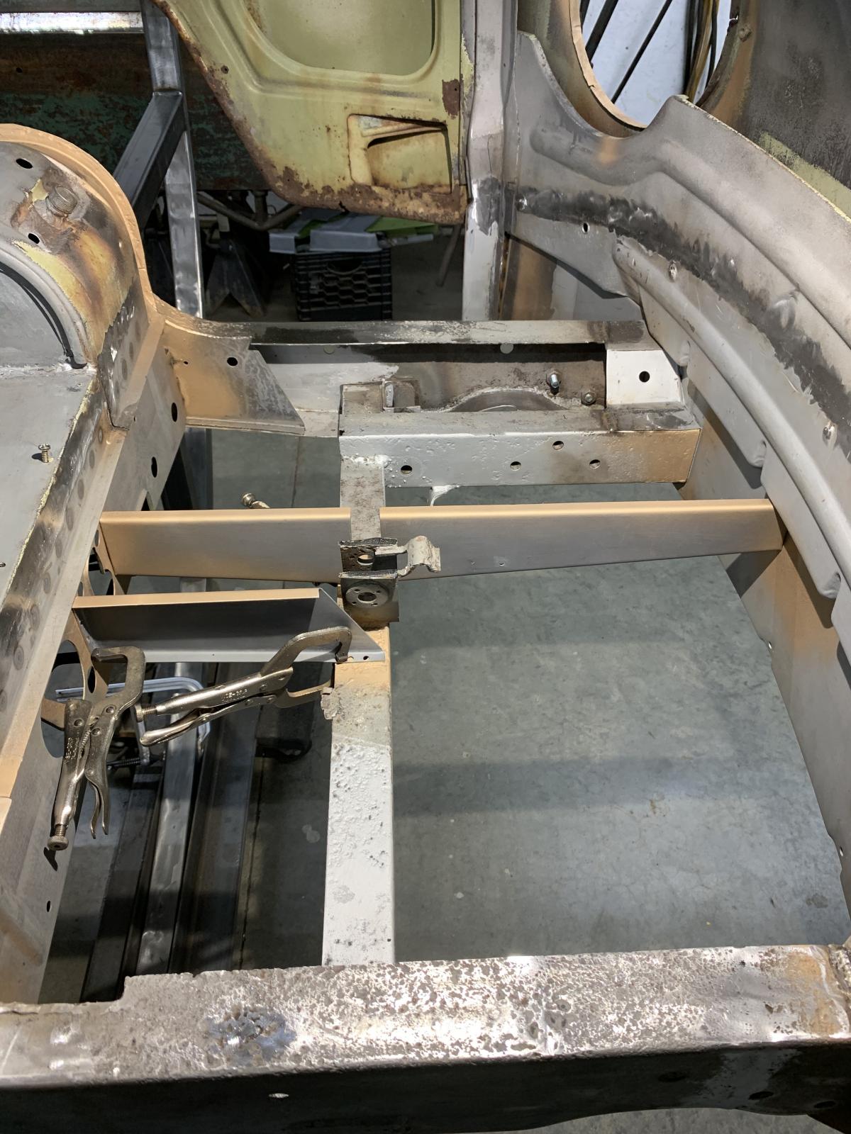

More progress:
The inner dogleg did not want to fit. I ended up cutting it in half, and removing about 1/4" from it. Now it fits. The seat pan did not want to fit either, but after some hammer treatment, it now belongs to the bus!
A big issue (I thought) was the E brake/shifter housing. I thought that I destroyed it when I removed the floor. I expected it to resemble the 60-67 housing. I looked for a replacement but only found the later ones. This is what I was working with:
After doing some digging, and looking at the replacement floor, I realized that I had everything I needed:
So I made these:
I just need to prep them and they should be good:
Then on to the drivers side. The parts pile is shrinking.

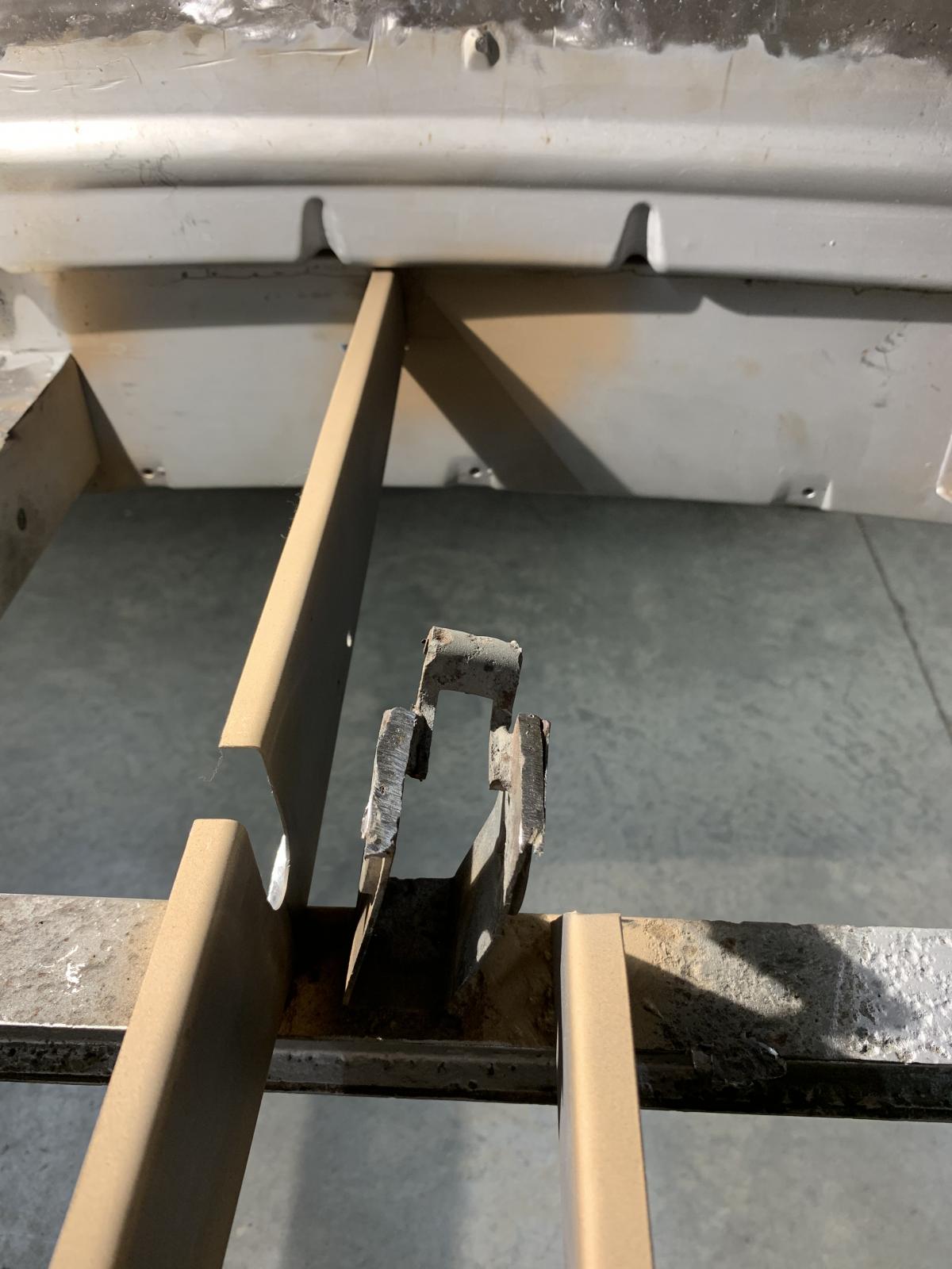

PostPosted: Thu Mar 18, 2021 3:08 pm    Post subject: Re: 1959 Mango walkthru metal rehab. Reply with quote
I’m hoping that someone can confirm what I am thinking. I believe that the e brake lever in the early buses is cocked off to the passenger side. Is this correct? This looks seriously off to me, but is it?
Thanks in advance!
CaLiBus
Joined: May 27, 2011
Posts: 1097
CaLiBus is offline
PostPosted: Thu Mar 18, 2021 5:32 pm    Post subject: Re: 1959 Mango walkthru metal rehab. Reply with quote
Yes cocked and new pin shafts are now equipped with zerks! Someone here on samba sells them

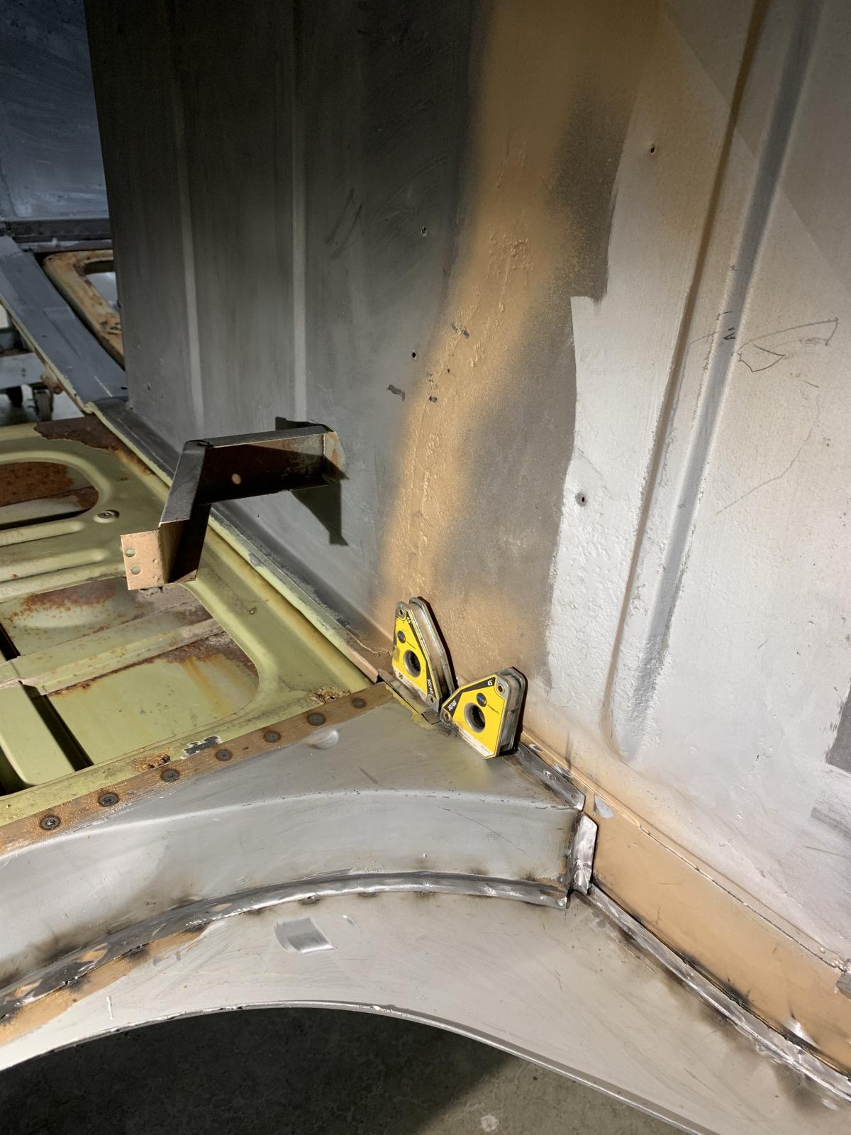

PostPosted: Fri Mar 19, 2021 6:23 am    Post subject: Re: 1959 Mango walkthru metal rehab. Reply with quote

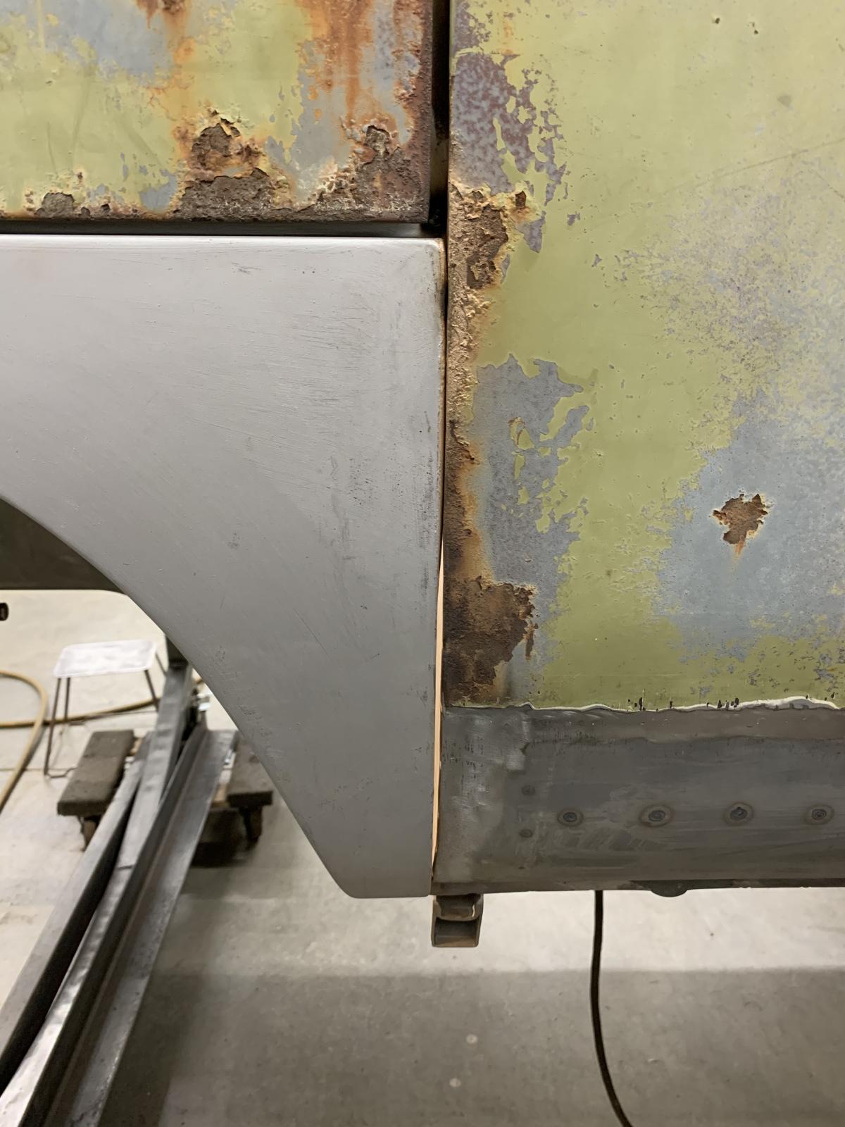

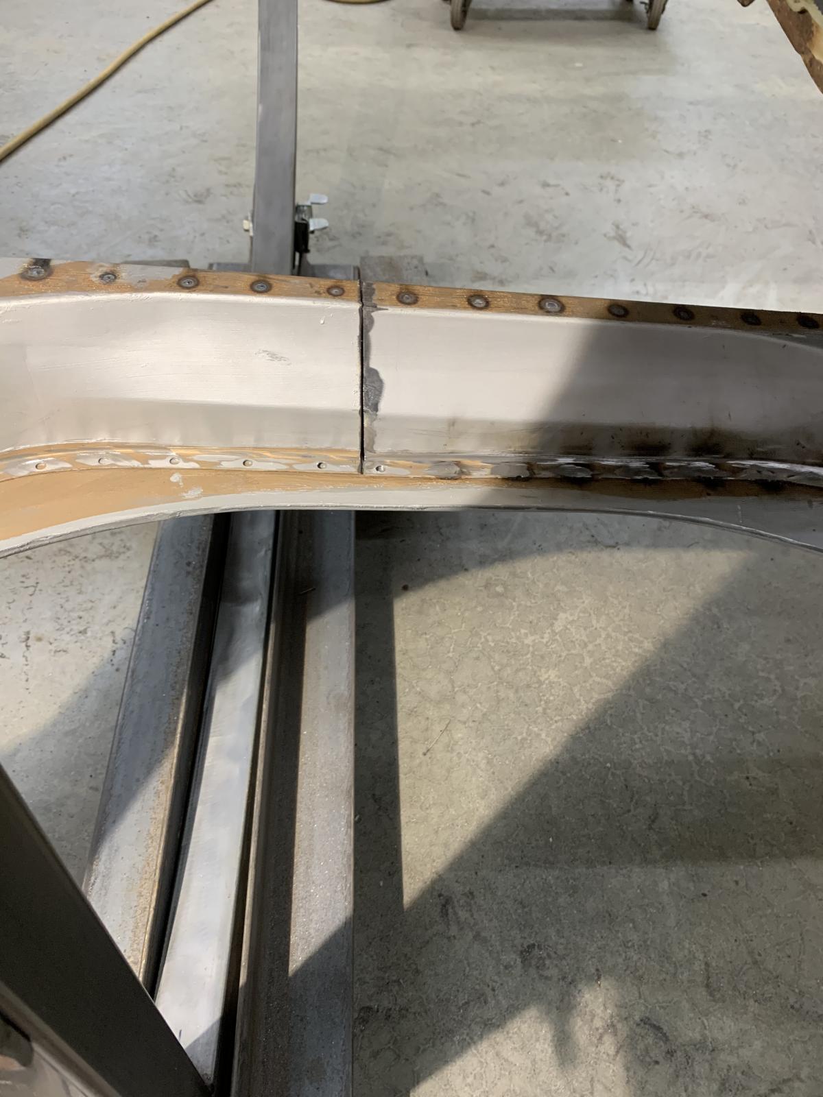

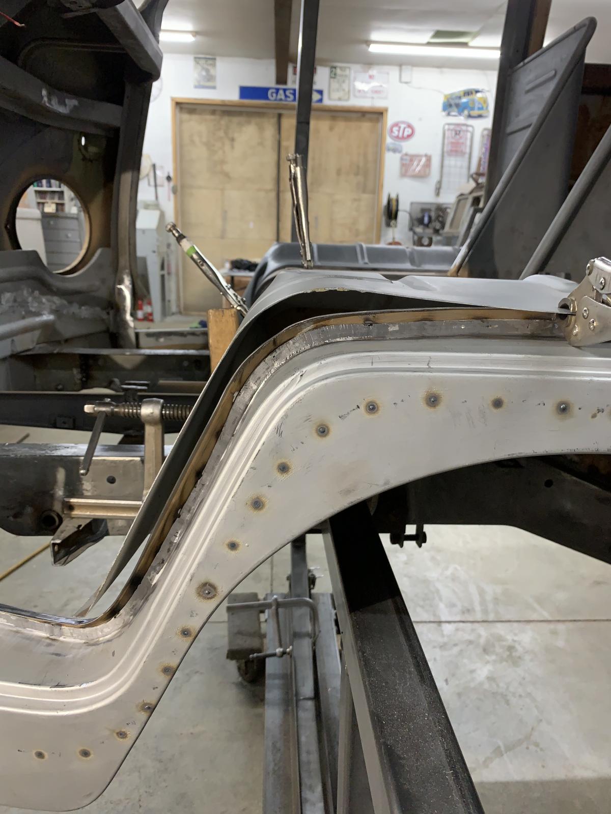

I started working on the drivers side dogleg. The B pillar was a little tweaked, and the dogleg did not meet it quite right.
A little banging and it fits:
Just to give you an idea, these were the tools I used to get that seam straight. I was wishing that I had a hammer with a vertical blade. I was thinking a hatchet would work perfect for the curved corner. It did. The hatchet is my favorite tool today:
I welded the dogleg to the A Pillar. Now I'm going to try and fit the inner dogleg. Hopefully it fits better than the passenger side one.

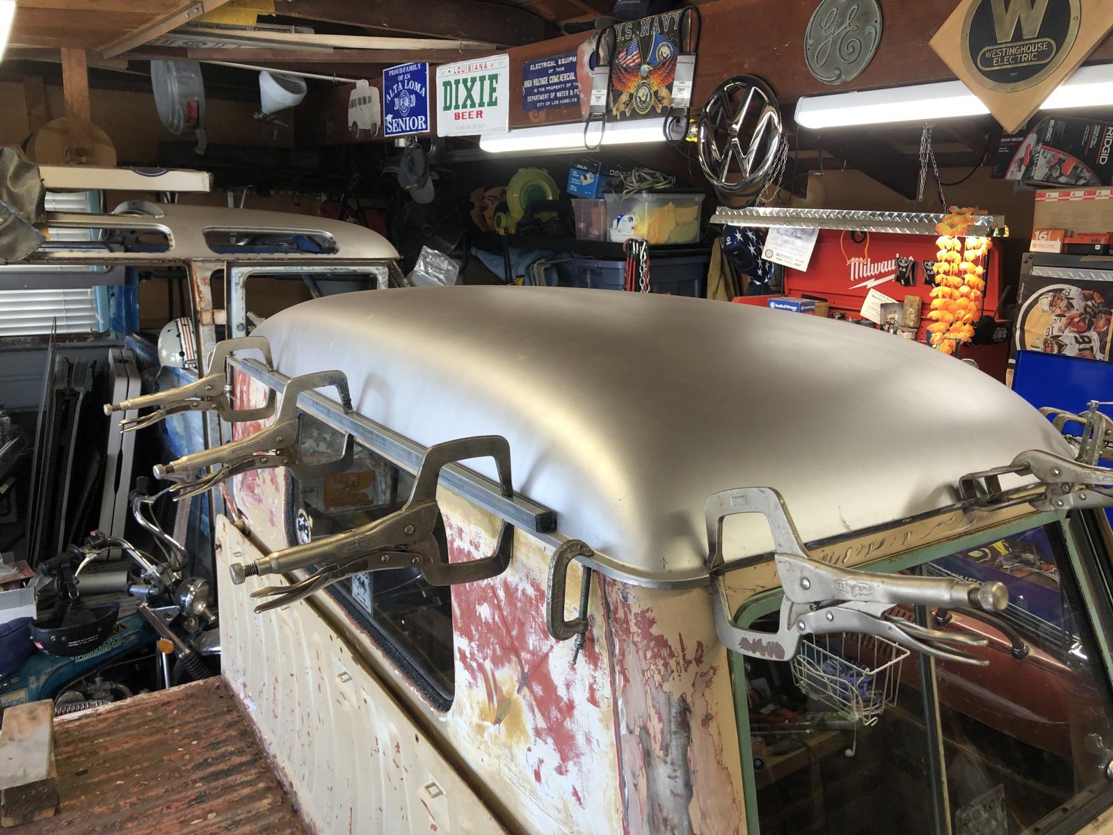

Thanks Navydave73!

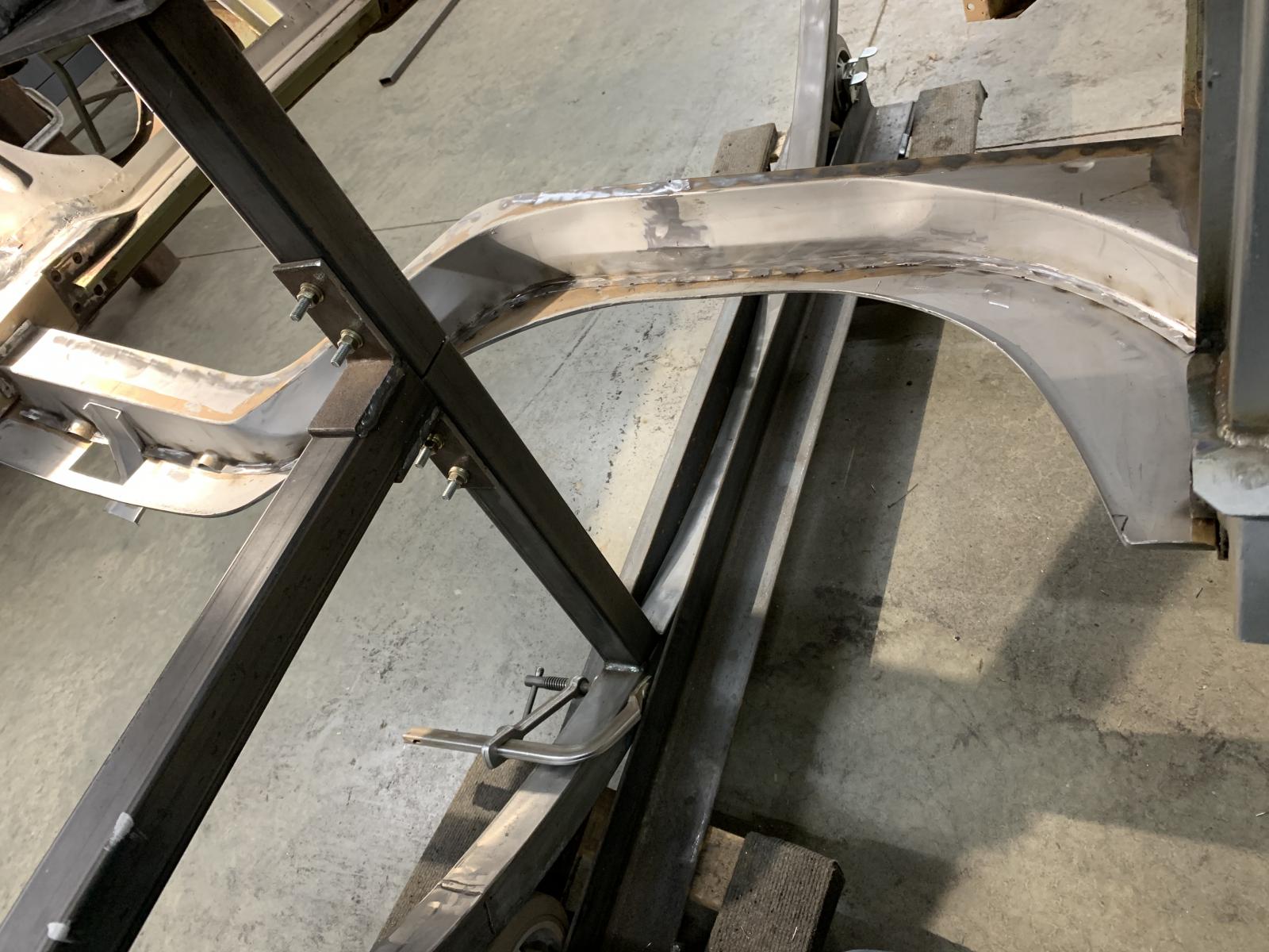

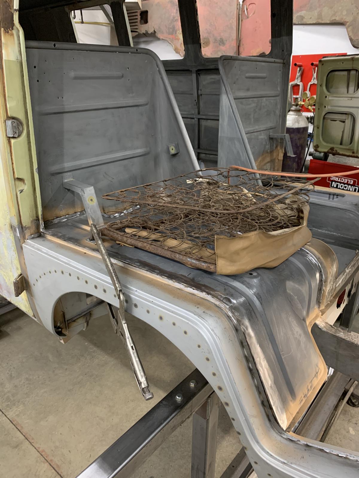

PostPosted: Sun Mar 21, 2021 3:36 pm    Post subject: Re: 1959 Mango walkthru metal rehab. Reply with quote

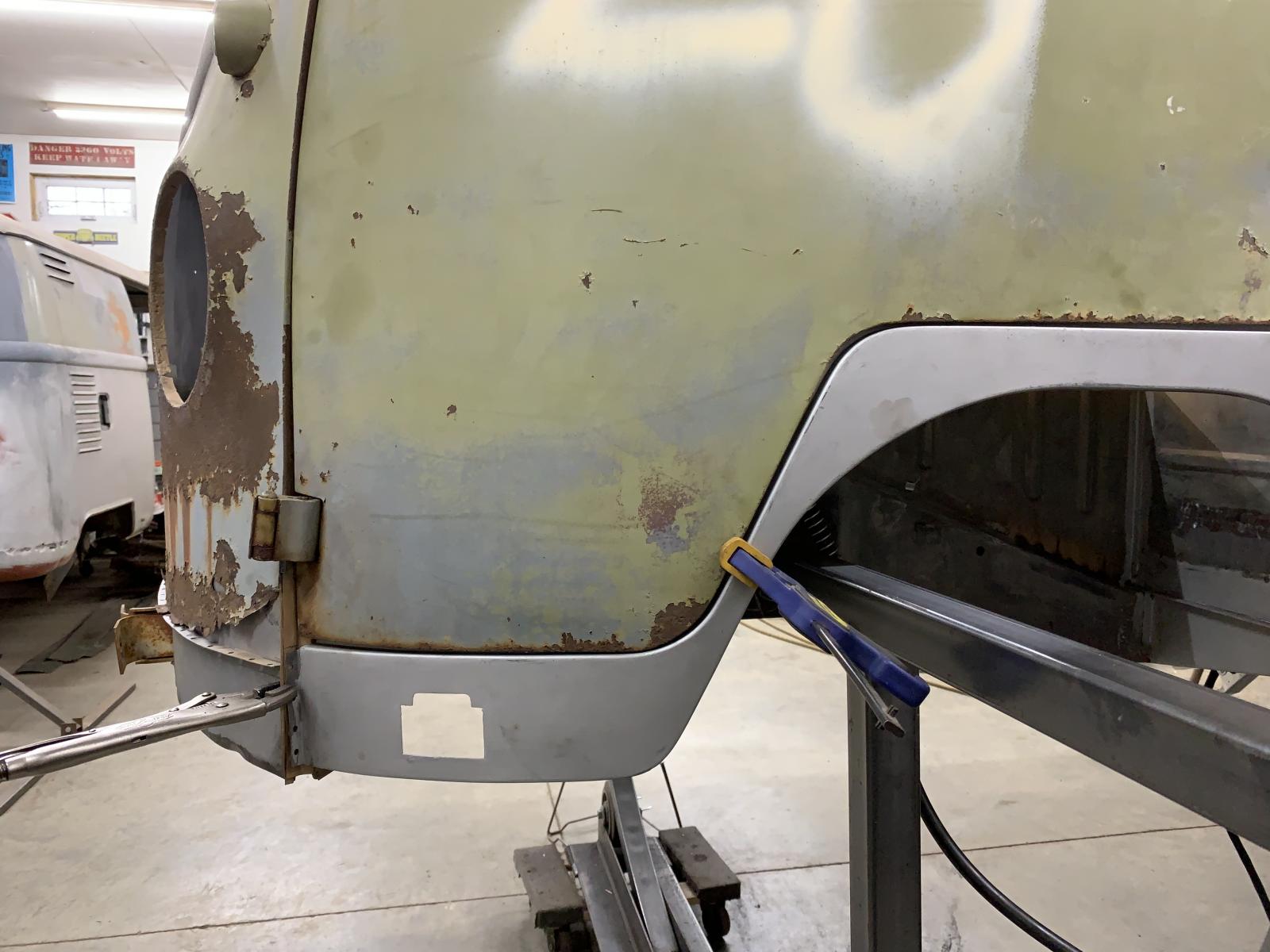

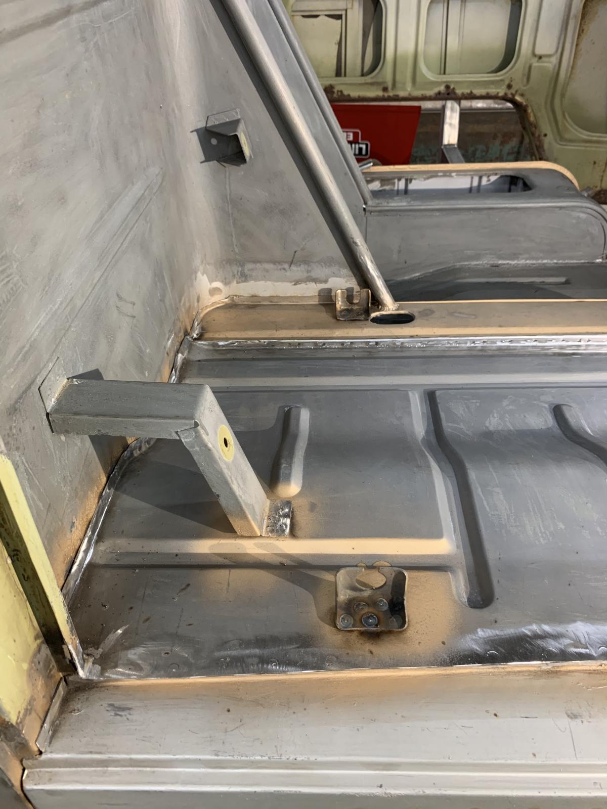

The drivers side dogleg is done:
I was hoping that the seat pan would drop right in:
Nope.
Had to do some flexing, but got it in and I’m happy with it. The seat pivot bracket is in too. Ready for the floor!
