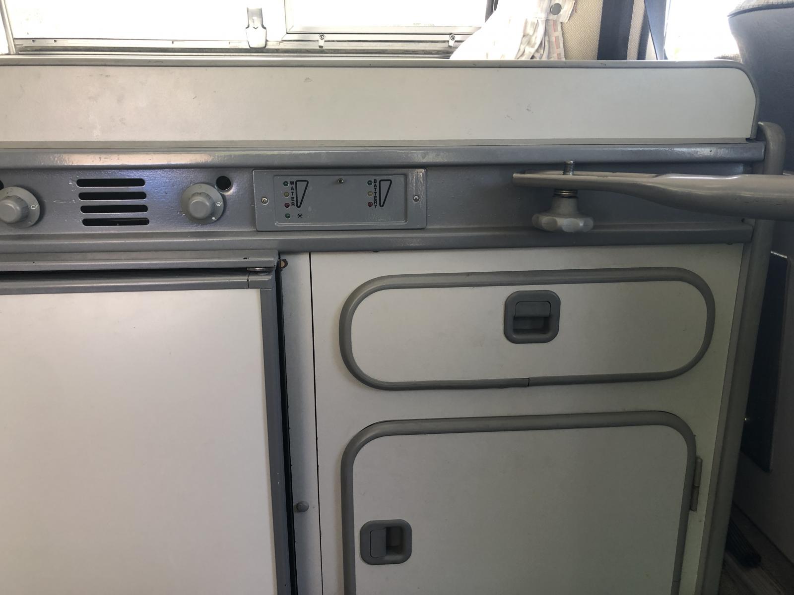

Hi,
I've been browsing the forum for tips on repainting some metal in my Westy (1990, so gray): grille under the fridge, front table leg, etc. I've found several paint tones. So... which is it?
I understand none won't be a perfect match. But if you've used one of these, what's your experience? How does the colour compare to the stock Westfalia grey?

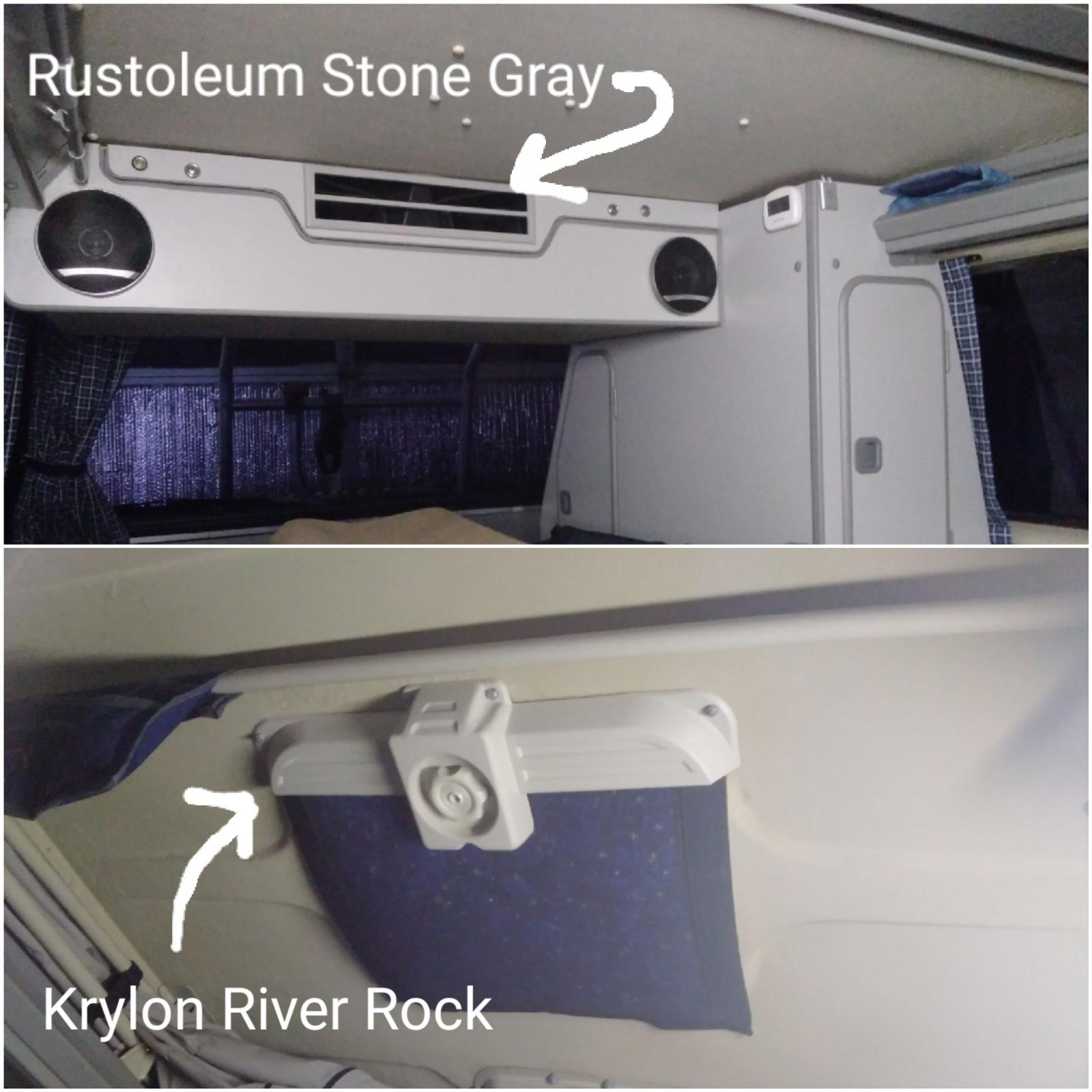

Smoke Stone Gray is too light to be a match for the metal components, which are about the color of the rubber trim:
I used Krylon's River Rock on the skylight plastic, which is a good match for the poptop components, but is a touch grayer than the original color.

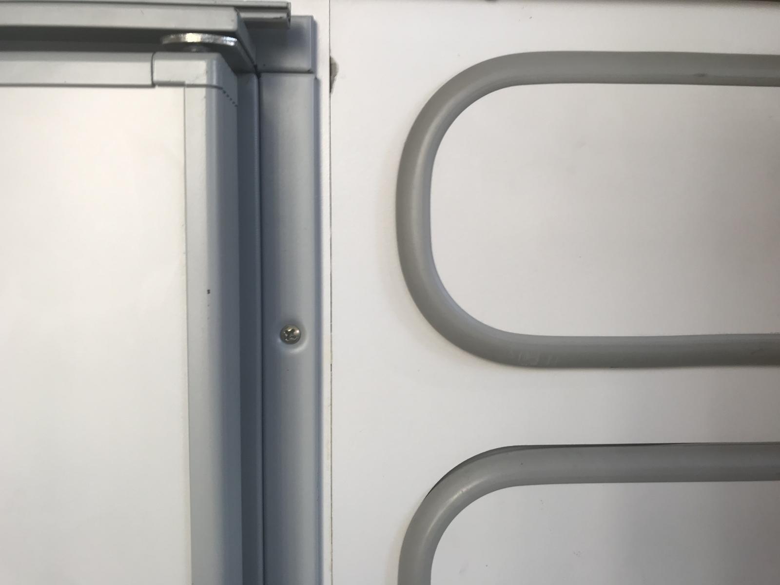

I used the Dark Machine Gray for the stove front and trim on my truckfridge. It looks good to my eye, but darker than the gray used on the table legs. The OEM stove front color always looked kind of dingy to me, so pleased with the new color.

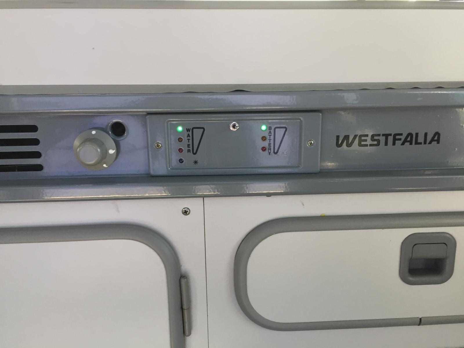

I have used this combination for all my Westy projects:
Preparation: SEM 38353 Plastic / Leather Prep Aerosol Spray
Paint: SEM 15183 Warm Gray Color Coat
Clear Coat: SEM 13023 Color Coat - Low Luster Clear Aerosol
The Isotherm fridge controller bezel and the Truckfridge frame pictured below are both painted in this method.

kamzcab86 wrote:
Smoke Gray is too light to be a match for the metal components, which are about the color of the rubber trim:
kamz, you say Smoke Grey is too light but your annotated photo shows a light gray that is named Stone Gray. I only point this out because I found Smoke Grey to be relatively dark.

I hadn't noticed that... For now, it's the grille under the fridge, and the small grille on the upper left side of the fridge cabinet.

That sounds familiar. These are my notes from probably 3-5 or more years ago. It looks like I copied Kourt's recs exactly as he noted above. When it came time to paint, I didn't want to order paint and the local Ace had Rustoleum 7786(830), and I went with it.
Resources
- Gray paint: Rustoleum7786 Smoke Grey . . . got it at Lowe's
- SEM 15183 matches the factory grey trim color almost perfectly.
- SEM 13023 is a low luster clear that will make the grey the same sheen as factory
- SEM 38353 is a cleaner that you use to clean/prep the plastic before painting.
Proofreading fail!🤦🏻‍♀️
It is Stone Gray.
