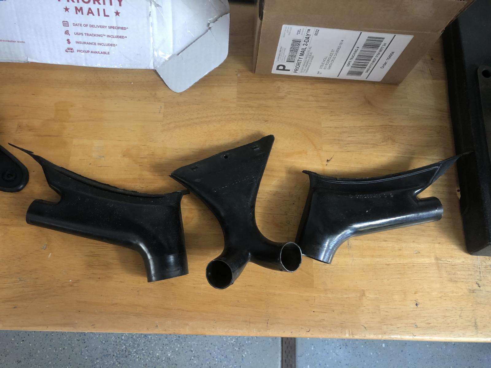

VWporscheGT3 wrote:
Clatter wrote:
Seriously,
I was just up in the attic looking for other stuff and found those three plastic heater duct pieces that go up under the dash.
These being from the beginning until 71 or so..
If you’re into doing this,
I’ll send you the set of three.
They are going to be pretty tricky with hollow and curves and all.
These are getting precious, so be for real..
You game?
Im totally game... if im who you are talking to .
Here you go, found 'em..
Know that even guys who have a bunch of stuff are running out of nice examples of these to sell
The sun just kills 'em..
Like's been said already, these look like a real challenge.
Not that I'm doubting, but how on earth do you do something like this?
Gets scanned for the outside dimensions, and then you specify wall thickness in the software?

Clatter wrote:
VWporscheGT3 wrote:
Clatter wrote:
Seriously,
You game?
Question
we have 2 different 3d scanners , you can essentially use the one as a template to create a template to then build the model from (feels like cheating). or the other i would cap off both ends as smoothly as possible and then scan in with some reference points first and then do the full scan , then import it in to solidworks, essentially create a solid first then "shell" it and modify from there. I will likely try the latter first.
the problem from there is finding someone who would be will to invest in the injection molding tooling to then create the new pieces. that kind of tooling can be anywhere from 8-35K . 3d printing would work only (with my limited experience in 3d printing) if you create a inaccurate flanged version that would attach by sandwhich-ing it to the dash sheet metal with some screw bosses added.
I'd be doing this over my lunches so i wouldn't be an issue with work.

VWporscheGT3
Joined: September 01, 2006
Posts: 2170
Location: Gardnerville, NV
VWporscheGT3 is offline
PostPosted: Wed May 12, 2021 7:23 pm    Post subject: Re: Type 3 Parts into CAD: Post it here Reply with quote
Steve , just received the parts , thanks , I'll get these scanned and get these scanned and returned as soon as I can. I will try to print up a first article of each to see if basic materials may work.
I'm also going to attempt the sunroof cable covers . Anyway I'll let you guys know how it goes
Nice.
You can keep that stuff..
