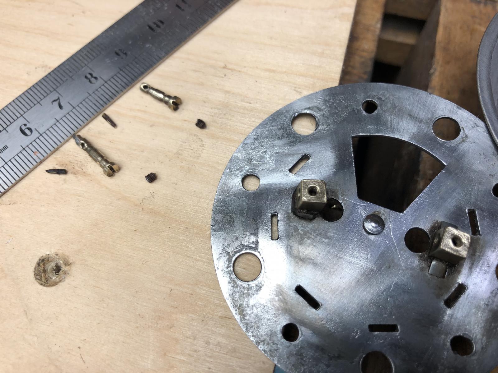

PostPosted: Sun Apr 18, 2021 3:57 pm    Post subject: Re: Had some time for my '58 low light today Reply with quote
Hi
I managed to take the small winders apart - talk about small.
You can see the winders, the set screws and a small pin that sits in the end. I used a small amount of heat and gently worked away at them - took a while. Now when the new wire comes we'll see if I can re-assembled it to a working fuel spending unit.
Dave

PostPosted: Sun Apr 25, 2021 5:37 pm    Post subject: Re: Had some time for my '58 low light today Reply with quote
Hi Folks
I have a couple of updates. First, my new wire arrived today - 100'. I wonder if I'll need all of it.
So I set up a test on the bench. The wire is so thin it's a challenge to work with.
The peg to which the wire to the fuel guage is attached is busted off. Here are a two pics, one from each side of the plastic base. I need to know the size of the peg, bolt, and I assume there are 2 nuts, one to hold the peg to the top of the guage and one to hold the wire. I couldn't tell from the photos nor the spec sheets.
I'll have to try and drill out the material and see whether I can fashion a new one. And looking at the pics you sent, there is a plastic "boot" that must serve to isolate the peg from the top of the guage. I guess I'll have to make something as I don't have one unless someone out there has one to offer.
So, some progress I guess. We'll see how the next step goes.
