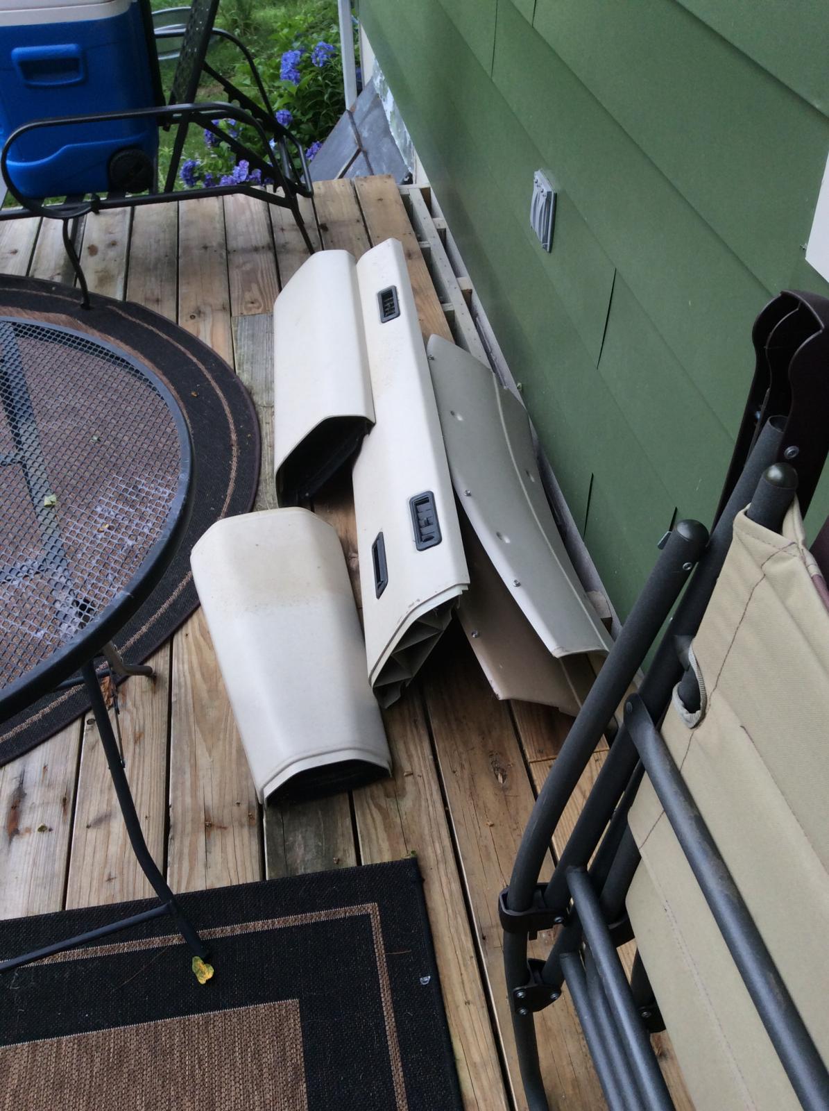

When I brought the Van home in January 2021 the duct work came out if the Van and went on the deck. I then promptly forgot about it.
After getting the A/C working in July 21 I picked uo all of the pieces and laid them out figuring how they interconnected.
It isn't complex, just all sorts of broken!

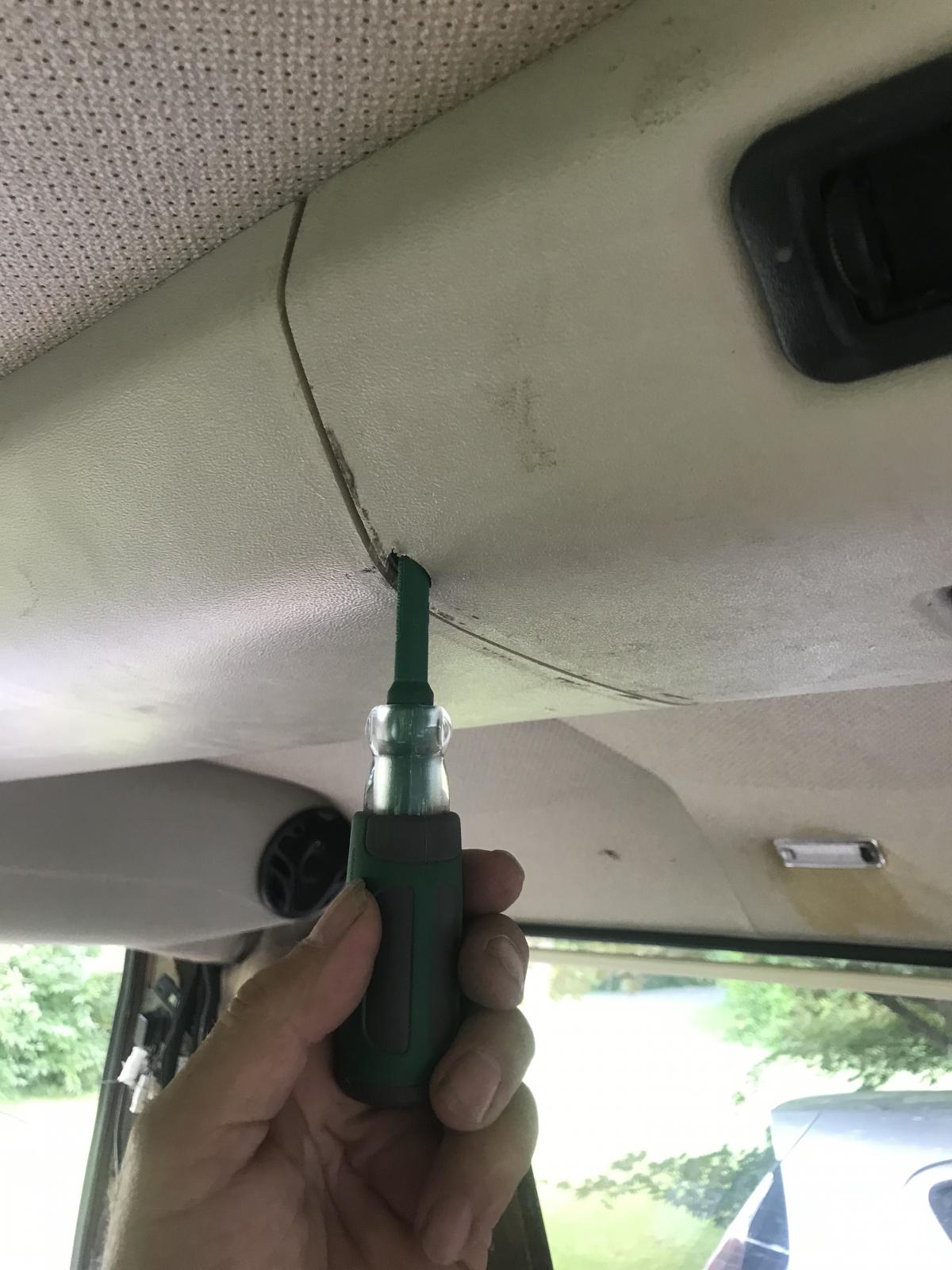

The second was that the drivers side of the 3rd duct has a molded in bump!
Why? I see no logical reason but there it is in this crappy photo!

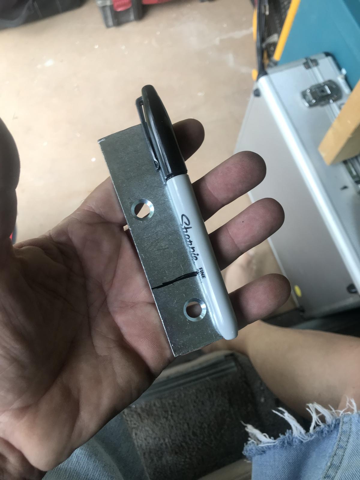

As a result, I cut one of my 10” mending plates down to the length of a Sharpie.
This solved the interior obstruction issue.
